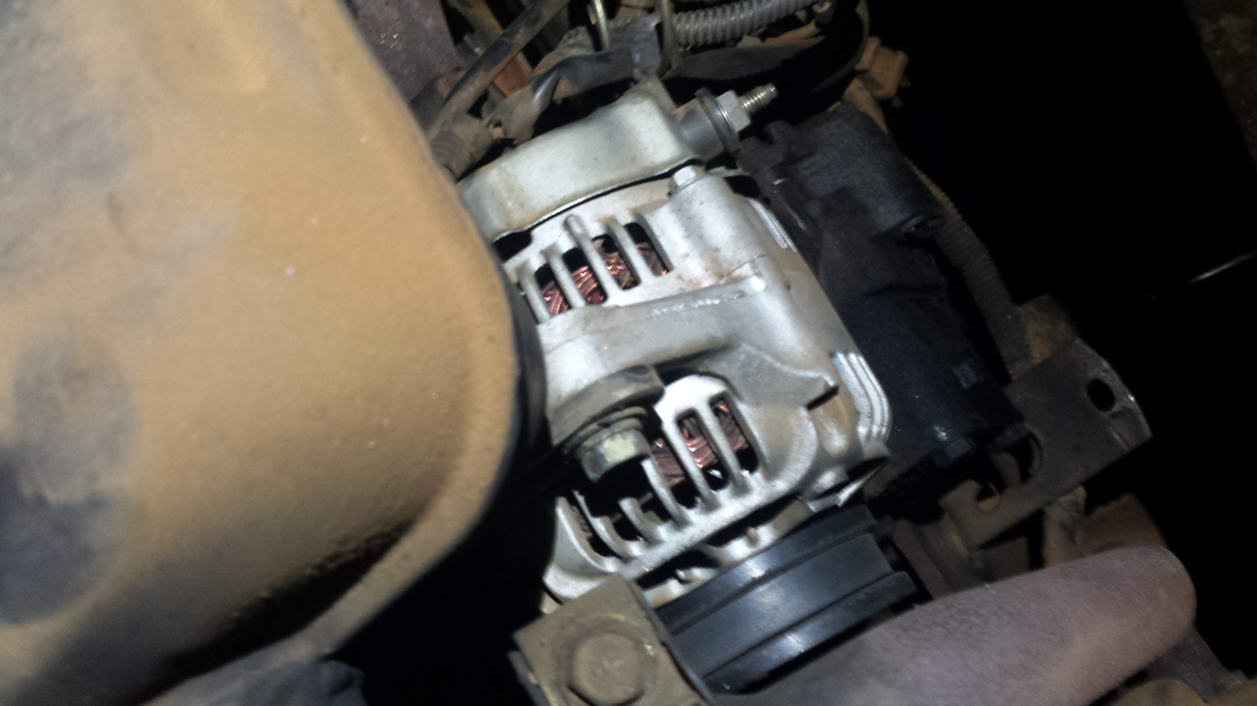

March of 2014 My alternator started getting flakey on the 4100. So after much research and advice from members on here with
a similar issue. I ordered a replacement from total-power-parts on Ebay. This past weekend I replaced the glow plugs and decided
to give the old Greenie a once over while sitting and running. That's when I noticed it. The Stator was bouncing all over the inside
of the housing!! Which would explain my Pop saying it wasn't charging right. Dang thing as less then 200 hrs on it!! I've emailed
them about this. Have yet to hear back and if I do I will add on here. For now I wanted all here might shop through them to know.

please explain better or post pictures of what you are calling stator not fitting in alternator housing. your original alternator should have been a denso 101211-2200 or 2201 they are both the same. in 30 years of being in alternator ans starter business have never seen one as you described that was not completed fried from either overcharge or low voltage and this usually only burns the copper wires in alternator not the metal stator frame

Mitch I will try to get a video tomorrow if time allows. Mean while here is a pic taken from their page alternator.jpg

no ase i a locally owned and operated starter and alternator rebuilder he has nothing to do with whom you ordered yours from i would still like for you to post a picture of the unit

Here it is ...I have a video uplaoding to youtube..once ready will post link...20150610_213111.jpg
