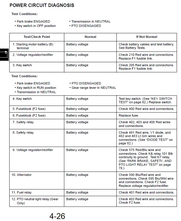

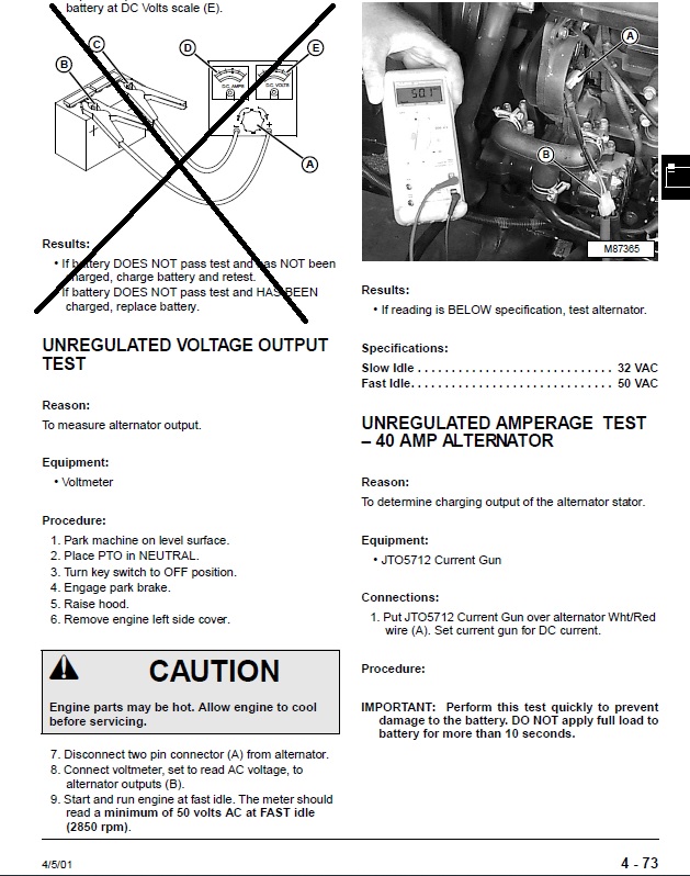

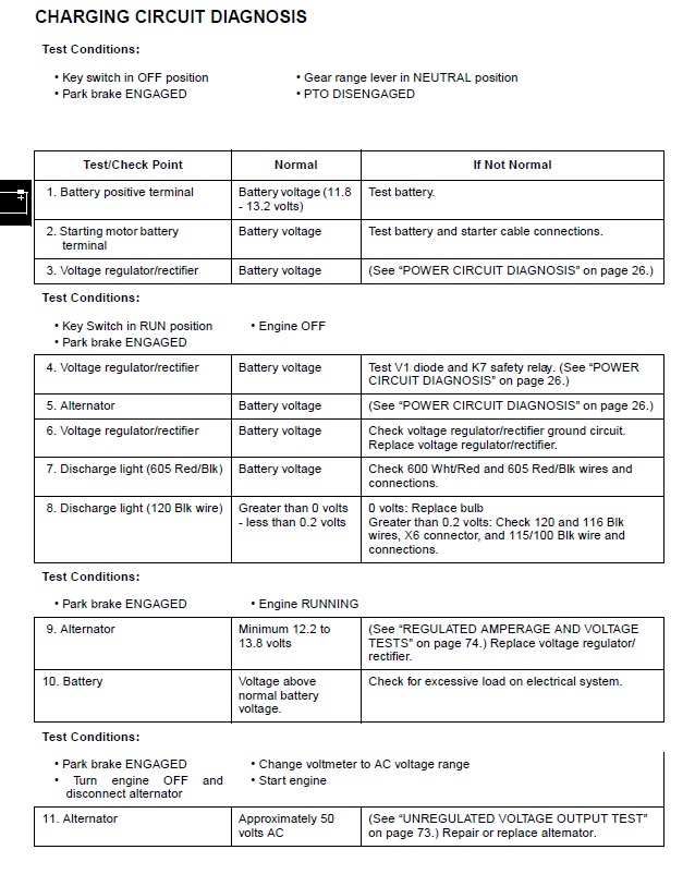

Battery not charging, 12.7 volts at battery while running I think it should be 13.5 to 14.5 . There are only 2 small wires on the alternator I pulled the plug apart and checked voltage while running, have 24 volts AC so my problem is probably the voltage regulator? any thoughts.

Can only offer this charging circuit diagnosis chart from the service tech manual for the 4100
Seems to come to the same conclusion you have. voltage regulator/rectifier....

I concur that there's a good chance it's the rectifier or the regulator, but not knowing that one I'll also extend the possibility it's the brushes. If worn too far they can put out the proper voltage open circuit but it may drop significantly under load. If your alternator has brushes that's a good place to start.

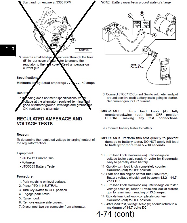

Thanks for your info . How did you access the service manual I have tried but no luck, would like pages 26,73,74.

I got the page numbers from the attachment on your first reply.

Gotcha.. see it now. Looked them up, as they are in the section 4
Attached each page, plus page 4-74 ran over to the next page with the Results. Hard to get them in correct order, but will try.
