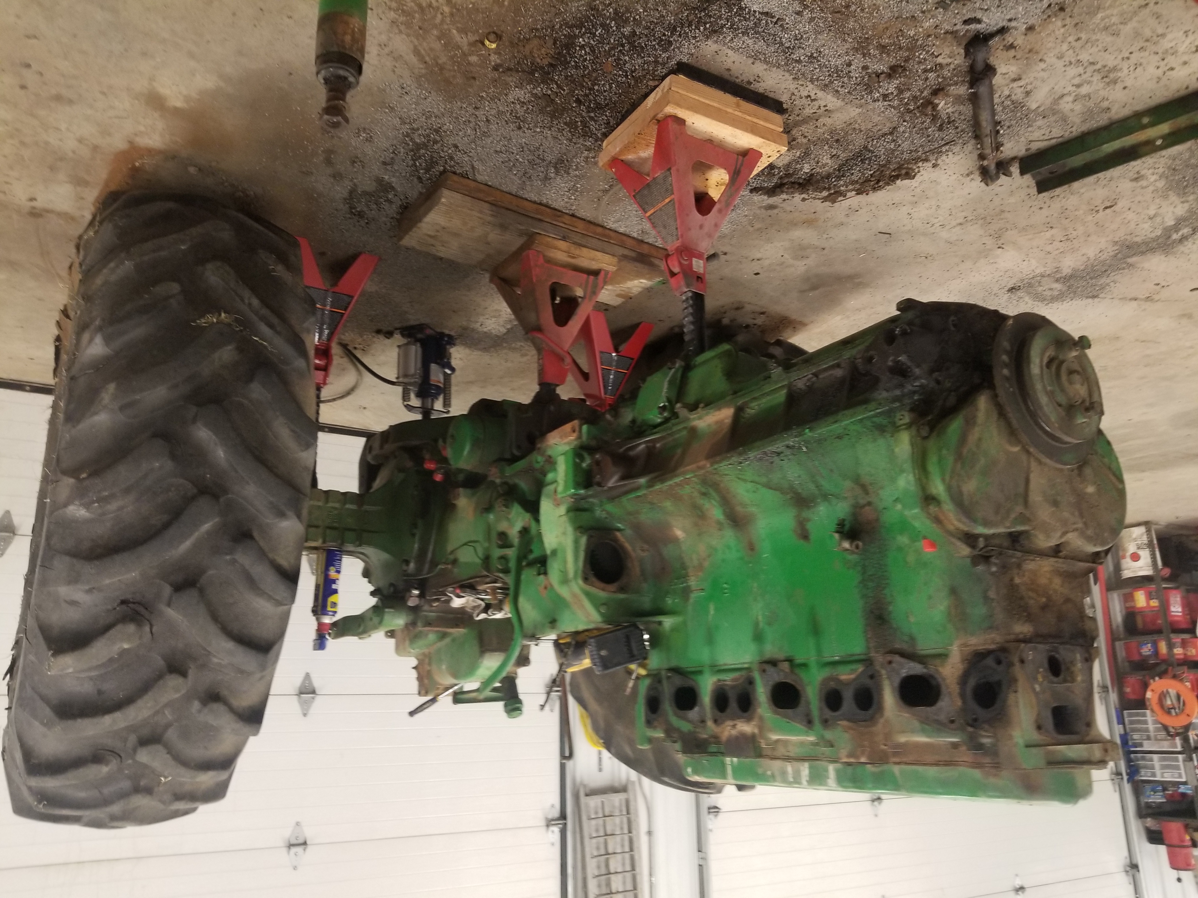

I'm in the process of tearing down and going through my 4010. I have a long list of items that need attention and while it's apart it will be getting blasted and repainted while apart. I'm to the point where I am ready to pull the engine off and wondering how much it actually weighs. I've searched quite a bit and can't find anything. Just wanting to make sure my cherry picker is enough or if I need to get my skid steer in the shop and use it to pull the engine off.

engine block either repaired or replaced due to broken frame mount holes

The broken frame attaching bolt hole will be be very challenging to repair. If it were my tractor I'd be looking for a later style engine.
   / John Deere 4010 engine weight
Yeah, I'm looking at trying to track down a 4020 block and frame rails. The mount points up front have 4 for the 4020's where I had 2 on my 4010 block.
   / John Deere 4010 engine weight #4
Have you considered attempting to locate a 404 CID combine engine? JD did list engine weight on their parts site but removed the parts spec's about 3 months ago

I can't find weight of complete engine, but a short block is listed at 855 lbs. If you add an oil pump, cast iron pan and cylinder head you will be close to 1200 lbs. Then add flywheel and clutch assembly and you are probably near 1400-1500 lbs.
