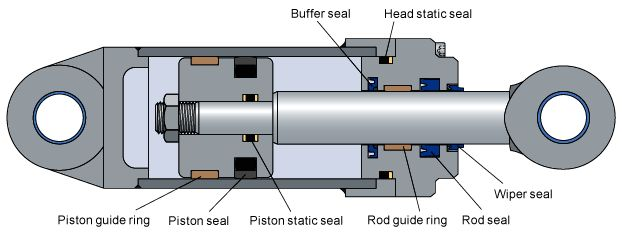

The piston is not threaded, it will have a nut that holds it onto the piston rod. Here is a generic picture.
Yeah I get that,
When I said" thread" it is because that is the first part of the rod that NEEDS to start into the piston hole.
The pressure is only what is needed to move the piston out of the bore
The piston has the internal oil seal
I thought the problem the OP is having is getting the piston out of the bore because the rod nut unthreaded. So he can rethread the nut and reasemble the cylinder. I have gone through cylinders on my old Ford 3000 New Holland 778 skid steer, My Koyker Rhino and on my 550 Ford TLB.
All I was suggesting was reinserting the rod through the piston hole and applying a little hydraulic pressure to get the piston to move out of the cylinder. Guys have had to do that when the rods get bent as well.
