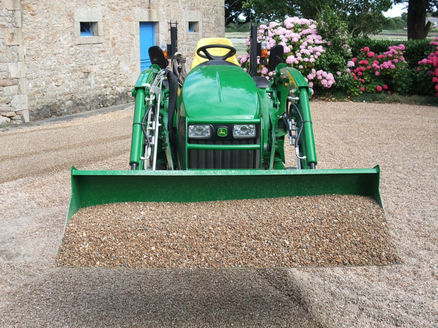

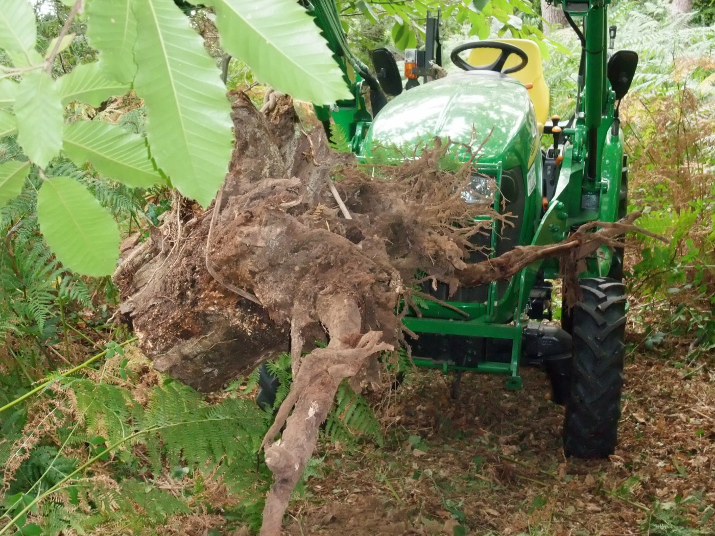

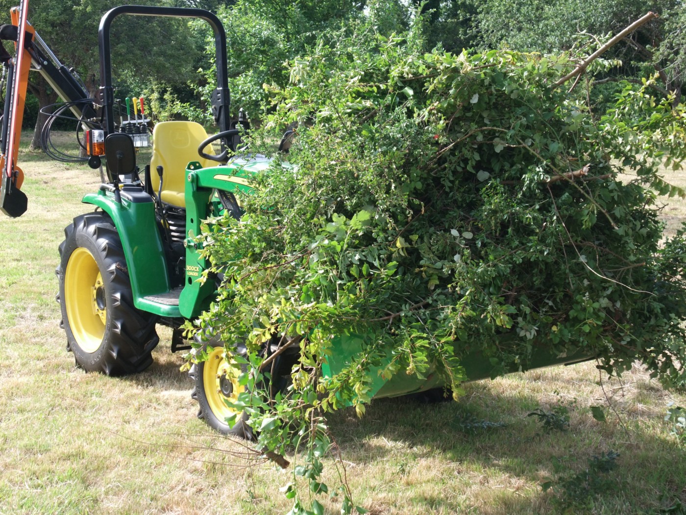

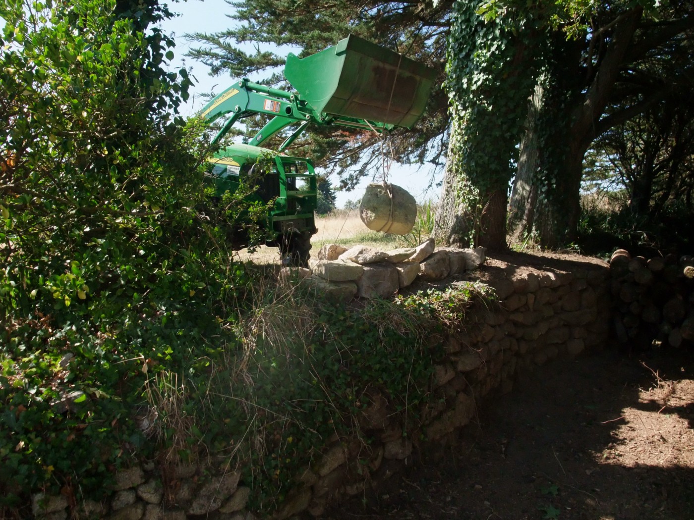

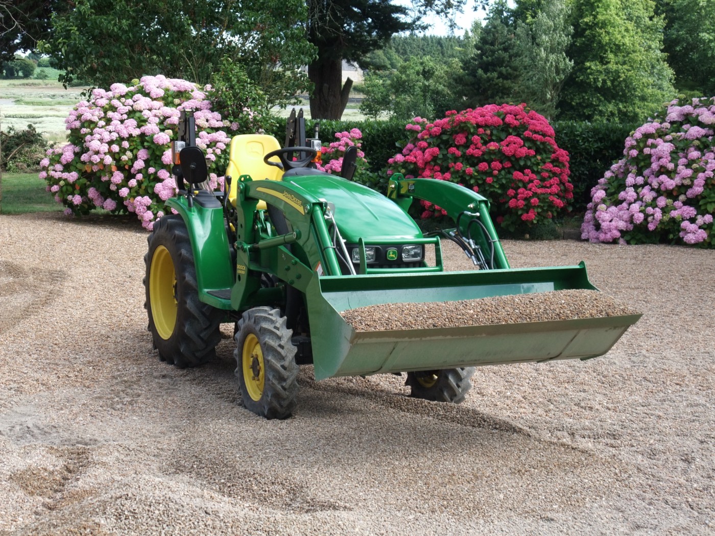

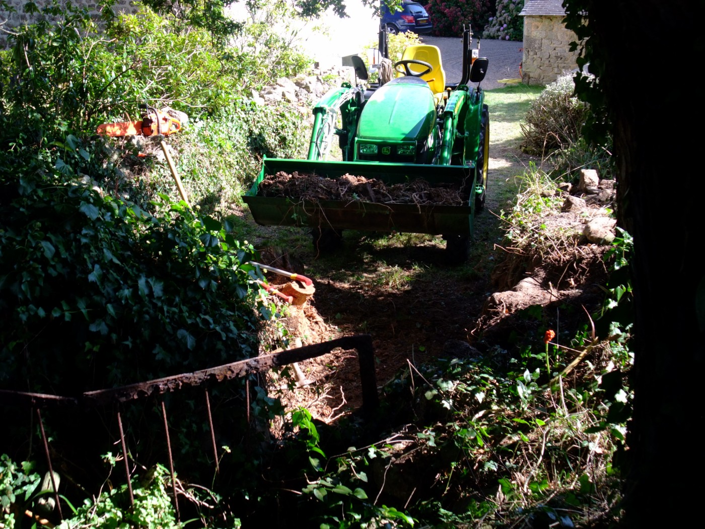

Coming a bit late, but I've never had any problem with my 61" regular duty bucket and 300CX on my 2009 3520. A larger bucket would be cumbersome and difficult to handle when full of dirt or rocks.
