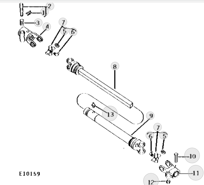

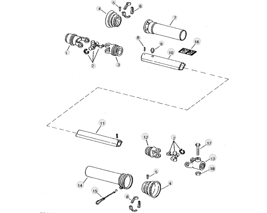

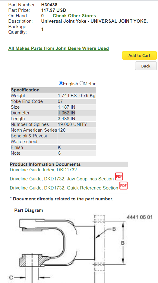

JD 350 mower had a serial # beak for drive shaft. Can you please post photos of pto splined pto shaft & drive shaft? If it was my mower I'd concentrate on getting just the tractor 1/2 of shaft that's AWOL. Which shaft in photo below resembles your shaft? Also shown below is the only 350 mower spline diameter I can find on JD parts.

the center picture with the square shaft is what i have. I did order a 1 3/16 shaft today with the yoke welded on to it and the cross bearing and the tractor 6 spline end based on my best measurements. The picture with the diameters and things really helped me to determine what i needed. again thank you a bunch.
By the way i was able to get the parts at my local NAPA Auto Parts, they were in their ballcamp catalog and should be here in a few days. i also ordered an operators manual from the net and should get it soon too. Again thank you.
