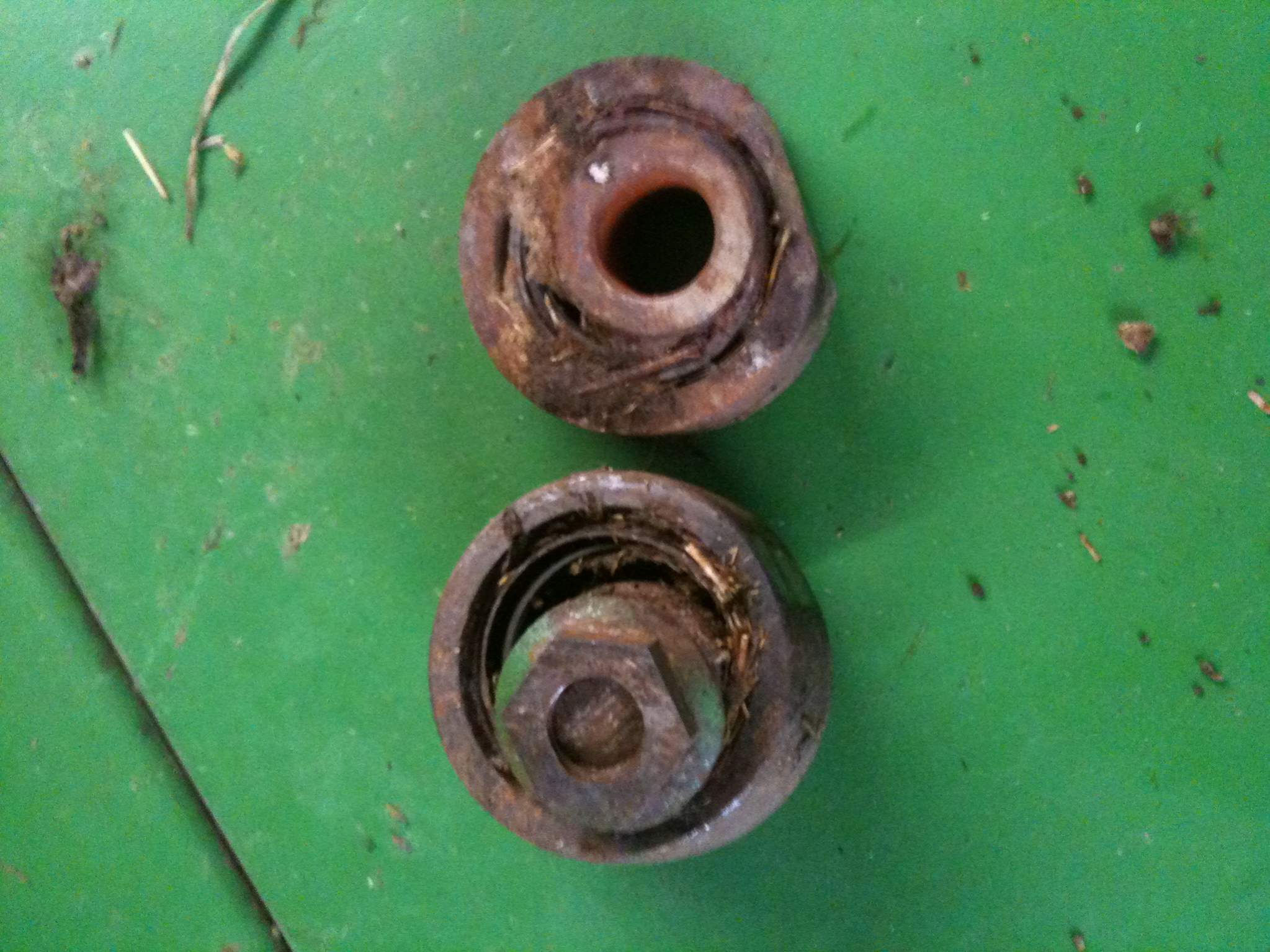

Yep... there was a fair bit of play on that feeder arm!! :D On my 336, the feeder arm has some hard, P-tex like bushings. I think some movement should be expected on that arm - just not too sloppy that might cause it to bind or jam to the side, etc. when it pulls into a wad of loose hay.
There must have been 3-4 sets of those worn out plastic bushing's in the tool box on the 336 when I went through it; lookin' things over and trying to get some ideas about parts and what might need to be fixed.
The plunger bearing and shaft on my 336 is pretty solid - not much play at all! Very happy with that! :thumbsup:
All in all - your short video of the baler under power looked fairly good. Everything looked to be in the right motion together.. No telling how it might do with hay in the system, though.

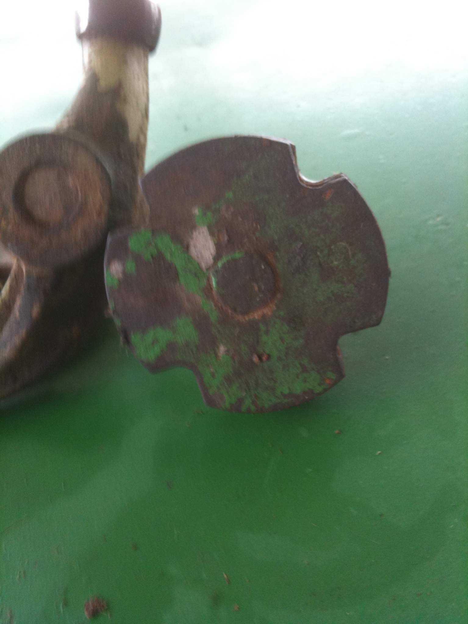

More pics coming - I pulled the right hand knotter apart. The lighting wasn't good and well I needed to get some sleep. It looks like the bill hook is almost worn thru.
Twine disk looks OK - needs cleaning.
The Twine disc cleaners - looks like it has the wrong one in there. They are supposed to be be two different sizes - they are both the same.
Twine disk holder springs - had 3 of them instead of 2.
Need a couple bolts.
The roll pin on the bill hook was stuck really back in there. I broke 2 punches getting it out. I suspect it was not a roll pin, but something they had laying around.
The wiper arm bearing is shot - worn almost flat on one side.
I suspect I will find the exact situation on the on the other side.
