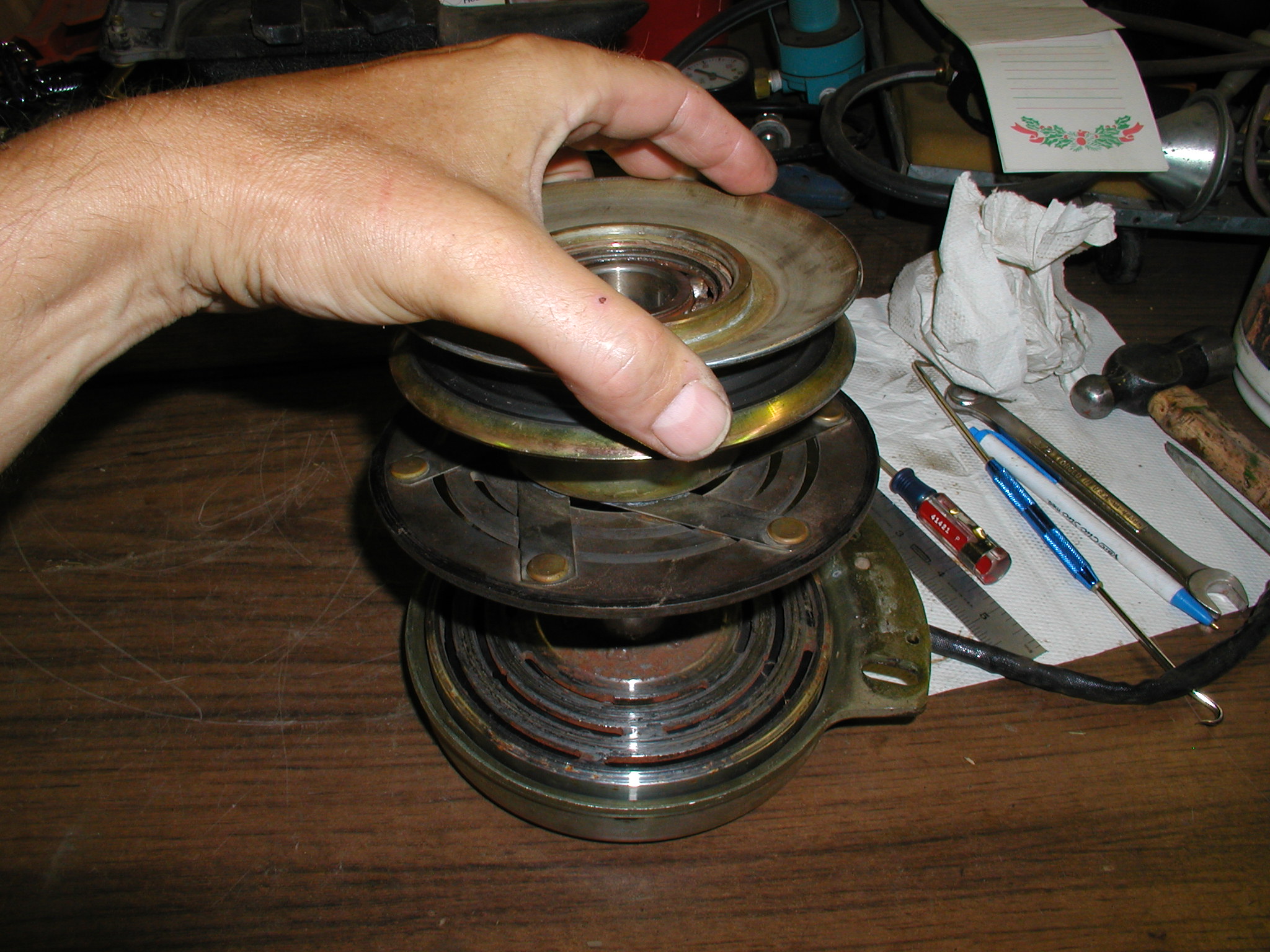

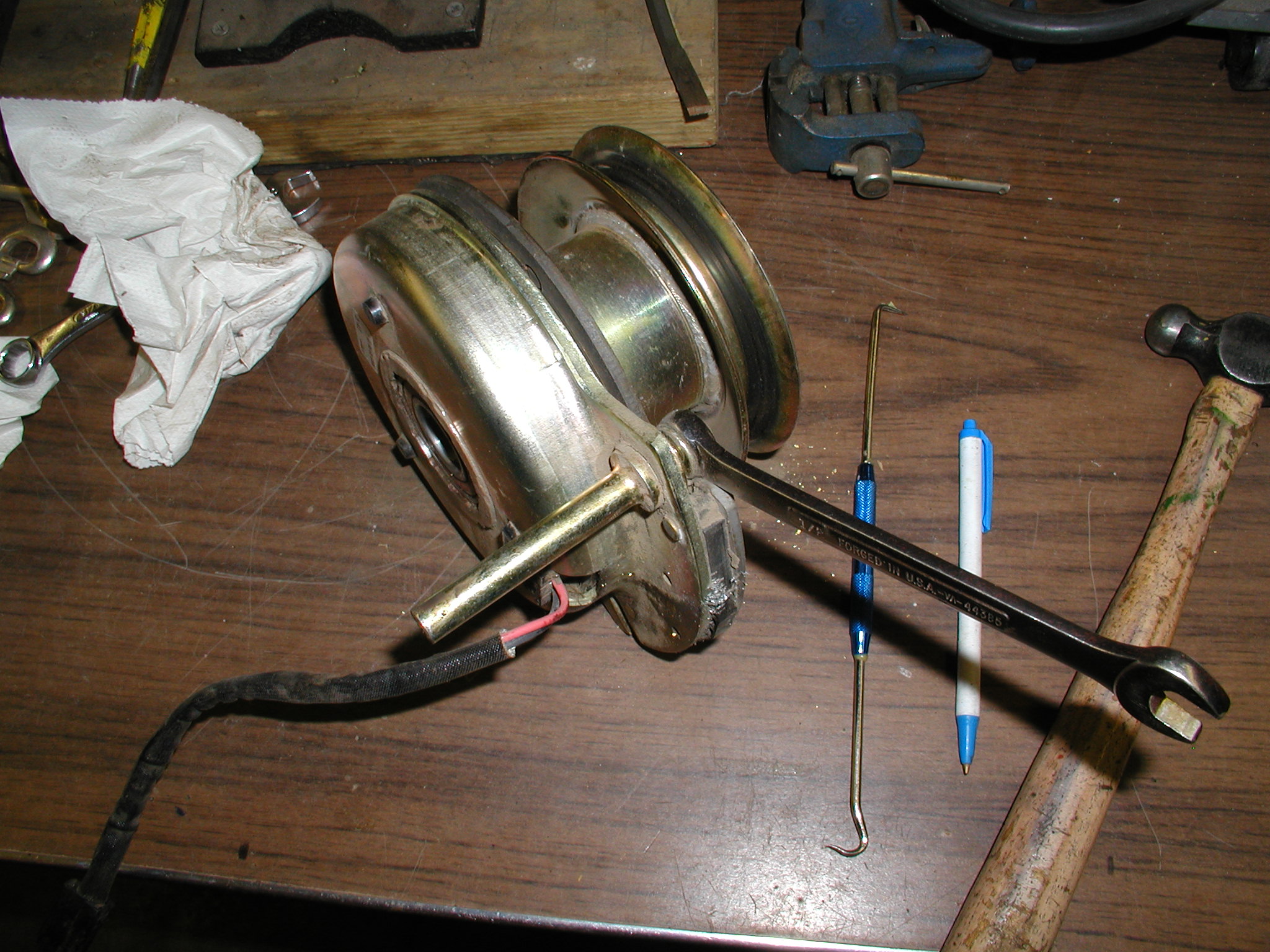

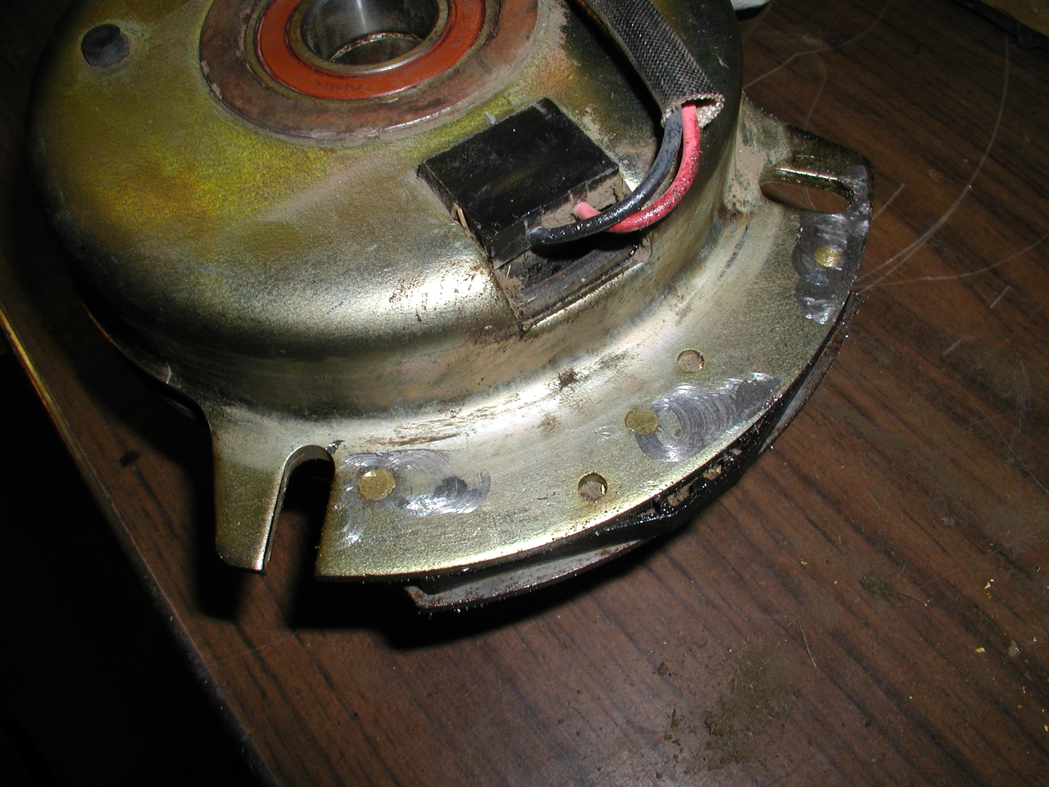

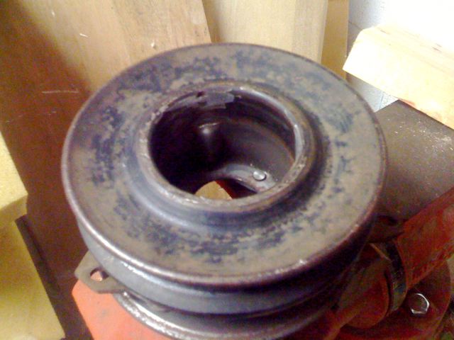

I agree, it's the lower bearing. That bearing is replaceable. Mine's out right now. The following description and pictures are for a X540. Mines under 200 hours and has this bearing failure. And it is out of warrantee.
Take off the mower deck. Raise the tractor front about 30 inches to make the job easy. Next unplug the clutch's electrical connector from the tractor wiring harness. The electrical connector is about a foot away from the clutch, it does not detach right at the clutch. Now take out the bolt that is visible in the center of the bottom belt pulley which is part of the electrical clutch. The clutch will fall right out in your hands (or on your face if you are not ready). Take it to the bench. Use a 1/2" wrench to remove the long anti-rotation stud from the housing flange (see picture). Now you must mill off or grind off the three rivets that hold on the brake assembly. Do not hit the assembly with a hammer, there are permanent magnets in the brake that will shatter. Once the rivets are ground flush with the clutch housing flange (see picture), tap out the rivets gently and the brake will come off. Mark the magnets' orientation so you can get it back together. For reassembly, instead of rivets you can substitute 3/16" by 1.25 inch bolts and mechanical stop nuts (not Nylocks).

When you pulled the clutch off the tractor, the main bolt that held on the clutch had a large flat washer on it. That washer contacted a cast part that centers the bearing (the bad bearing) on the shaft. Grab that cast part (it has a couple flats on it), and pull it out. It is keyed and so it will not turn unless you break it, but should pull off. Alternately, you could probably push it out from the other end, with a 1/2" diameter wood dowel or something similar.
Now lift off the drive sheave (pulley) half of the assembly (see picture). There is a spiral ring on each side of the bearing. It takes a little screwdriver to remove it. Clean it up with a toothbrush first, then look carefully before removing the ring. Try not to wreck it. now you can press or pound the bearing out of the sheave assembly. You will have to drive or press on the inner race, because if you push near the outer race you'd ruin that spiral ring that is still in there on that inner side of the bearing. So, just beat it out of there by hitting the inner race.
Clean everything up, take the old bearing to your local bearing specialty retailer, or an electric motor rebuilder, they will match it based on dimensions. Use the old bearing to press the new bearing in, this time putting all the pressure on the outer race only. Reinstall the spiral ring. Reassembly the clutch assembly, reinstall the brake assembly with small bolts as previously described, and re-attach to the machine. Buy me a beer sometime.

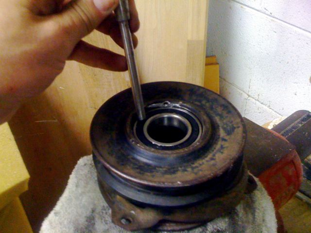

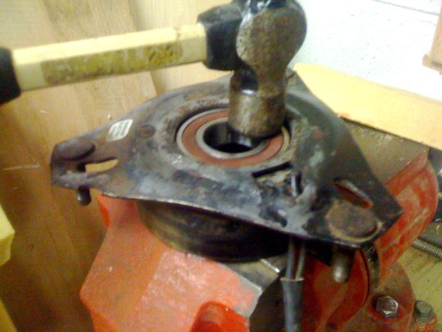

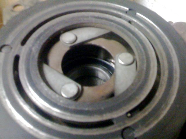

Thanks to Jim's post I was able to replace the 2 bearings for a total of $10.Compared to the $150 replacement price for my 345 lawn tractor.
Pillow Block Bearing Ball Bearing Disc Harrow Bearing Roller Chain V-Belts Radial Ball Bearings is by far the cheapest place I found(866-976-7729). I used a small dremel type grinder to remove the 'burrs' holding the bearing in place. Pound on the metal area of bearing using hammer and removed/replaced both within 30 mins.Put a tiny spot of weld to hold in place.
Simple job for anyone wanting to save $ and motivated by 2 machine shops who said they couldn't press the bearings out.I've attached cpl other pics for ref.Good Luck

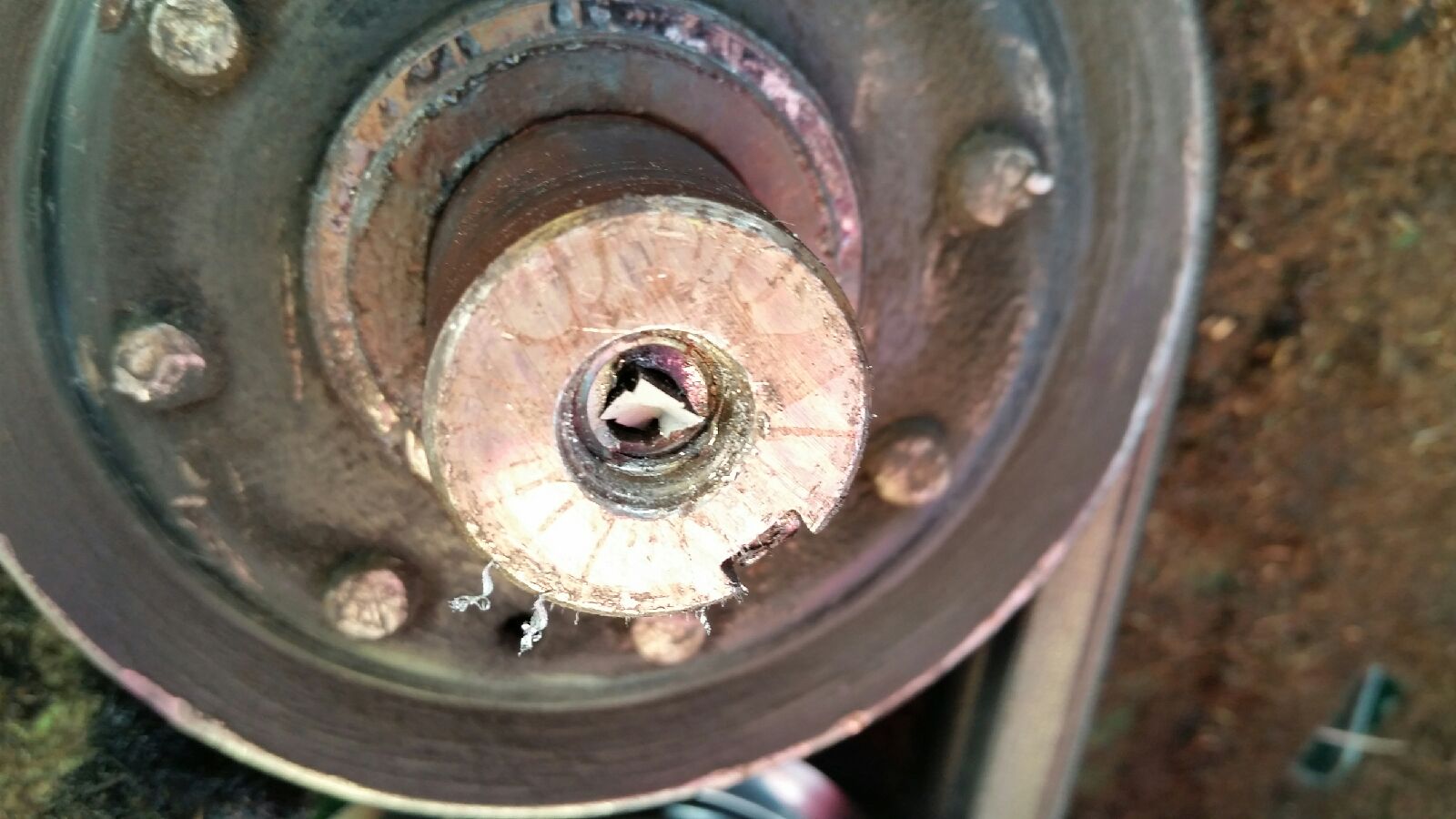

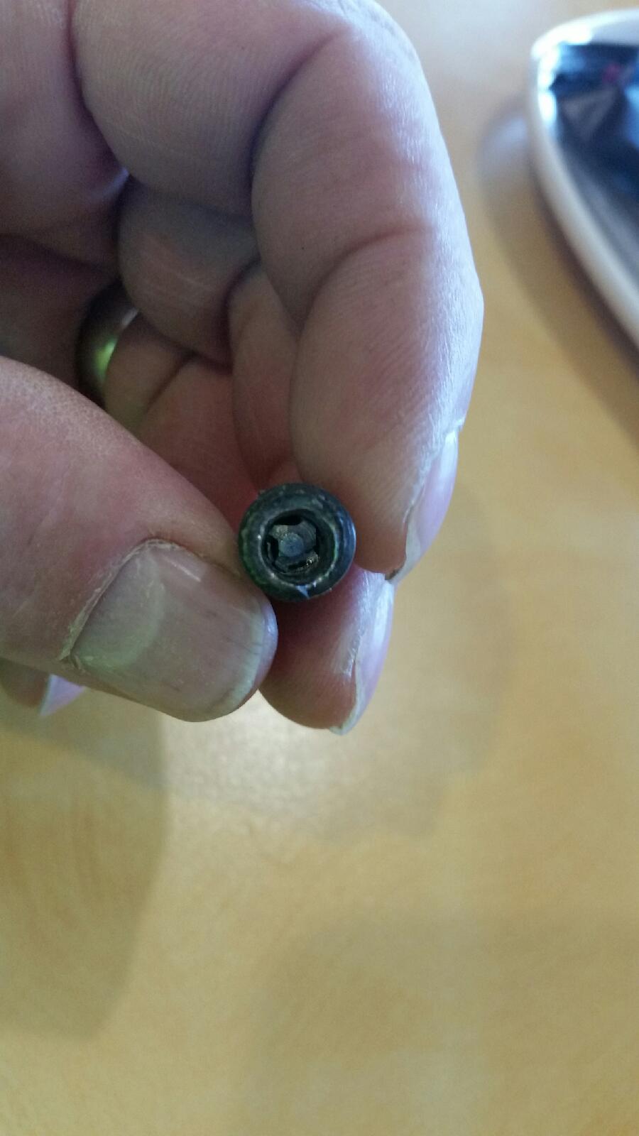

I'm gonna BUMP this thread, even though it's old. I have a 345 that I bought with my property back in 2013. I've had to do a lot of maint on it but I"ll keep this one to the PTO Clutch. I've had trouble keeping that **** PTO bolt IN the bottom end of the crankshaft. That is, about 4 years ago (summer 2014), the first issue I had was that the bolt backed itself out and as a a result the clutch fell off the crankshaft. Since I lost hte bolt in the yard, I went to JD and purchased a couple new bolts (and washers)\. I installed a new bolt (no other damage), but since I wasn't familiar with the engine and how to do it, I just cranked the bolt on with an impact gun. The next summer, I lost another bolt. Well this one broke off. I was lucky enough to be able to use a punch and walked it back out as it was broke close to the end of the crankshaft. I installed another bolt, with Loc-Tite and an impact gun and that was that. Before the summer was out I was looking to replace the PTO Clutch as it was making noise. I did not want to pay the $250 JD price or even $180 eBay price, so I replaced the lower bearing (the one closed to the mower deck), and reinstalled it. No problem.
A couple of years ago, the **** bolt broke again. and I was still lucky enough to get it out of the crankshaft.
THings were OK until a couple of days ago.
I fired up the tractor, engaged the mower deck and after about 15 seconds, the bolt broke again. This time I wasn't so lucky. The bolt sheared about 3/8 inch below the crankshaft, and with loc-tite installed, I was not able to use a punch this time. :pullinghair:
I started drilling out the bolt with 1/8" bit, and was able to drill deep into the bolt. I then uses a 3/16 bit and got it open a bit more. I used an automotive grade extraction kit (I hesitate to say "easy out" because that's a brand name, not a type of tool), a square one...pounded it into the hole as directed and with HAND pressure proceeded to BREAK the EXTRACTOR. 20180420_134237.jpg It was very brittle and appeared to be made of Chinesium ( -26 on the Periodic Table of Cheap Elements). SO now I'm in a terrible quandry. I don't have anything to proceed, so I thought I'd call the local JD dealer down the road and ask them. Well, boy did I get an answer. "We don't typically do that kind of extraction...as that's a worst case scenario, you'll prob have to replace the crankshaft"....so I asked him how much and after some math, I was told "about $1600. The crankshaft alone is $325. $85 an hour labor, and its an 8 hour job. Include gaskets, etc and that's about $1600." I said "THANK YOU" and told him I'd 'be in touch'. I called a machine shop in Lancaster OH that I deal with and they could not help me, but DID refer me to a small business (auto work) near me, so I called him and discussed it. After I sent him a pic he said, "Bring it over, I've seen worse" and that was last Friday. Saturday he had it out, after 2.5 hours and using a $300 diamond-tipped bit to cut it out. He only charged me $50.20180425_132949.jpg

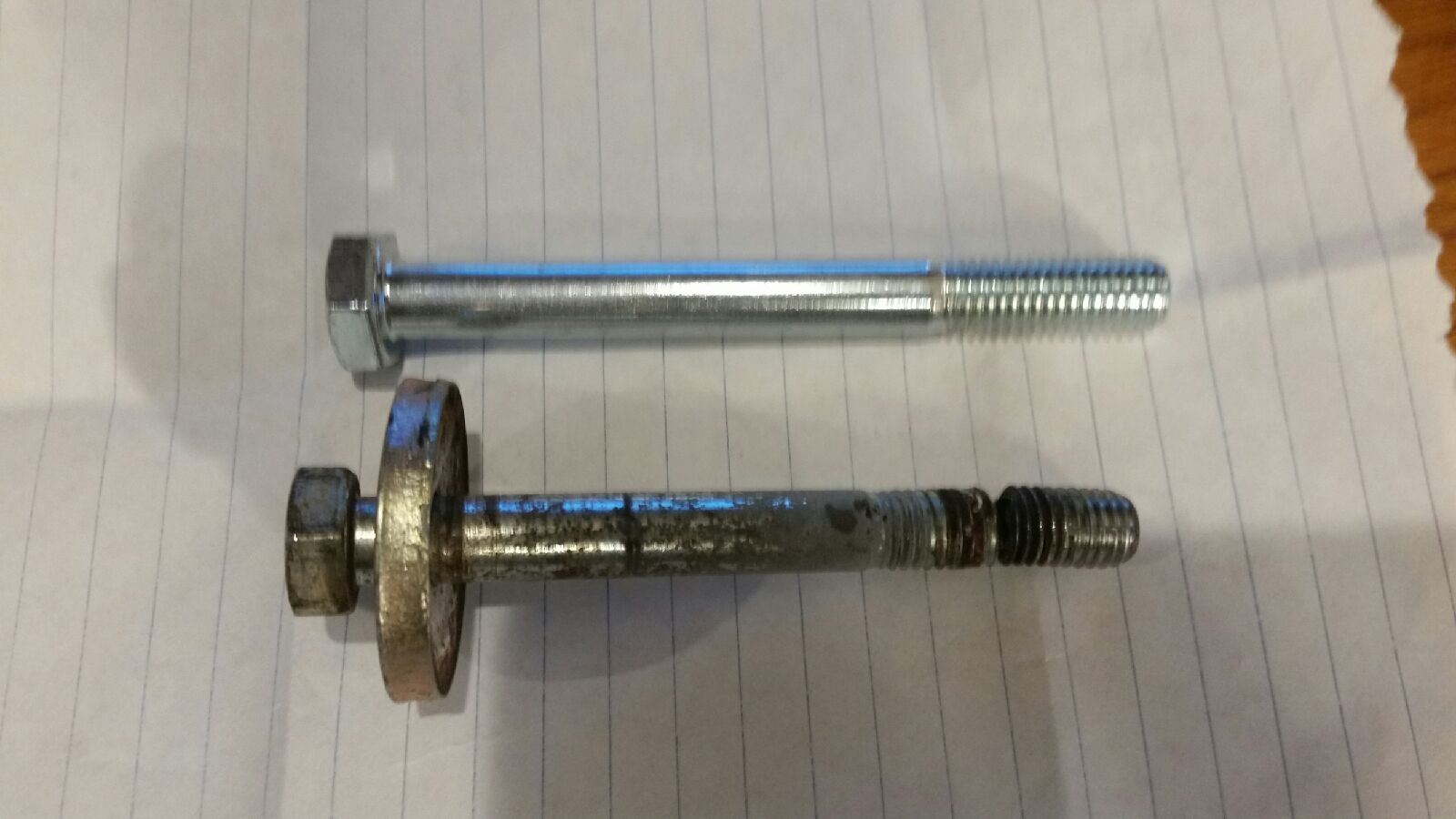

So, anyways, when the PTO clutch broke off, one of the wires broke so I'll have to fix that problem. On one of the wires coming out of the clutch, I only have less than 2" to work with.....arggghhhh.
I called JD again and talked to the guy and asked him if he could tell me the torque specs for that PTO bolt, as I could NOT find any info on the 'net or in my manuals. He finally was able to find it, and it is supposed to be 45' lbs. So I would STRONGLY URGE anybody NOT to overtorque that bolt with an impact wrench. And the bolts I"ve been using I get from JD, and they are HARD bolts, UH 10.9 (equiv grade 8). There's not much harder in bolts, so after talking to the JD guy and my mechanic friend, they suggested getting a bolt that is about 1/4" longer. So I did (see pictures).
20180426_162715.jpg . The reasoning behind that is that the bolt doesn't really get enough "bite" into the crankshaft, etc etc etc..
I will use the rope method to 'lock' the engine so I can apply the correct torque on the bolt.
