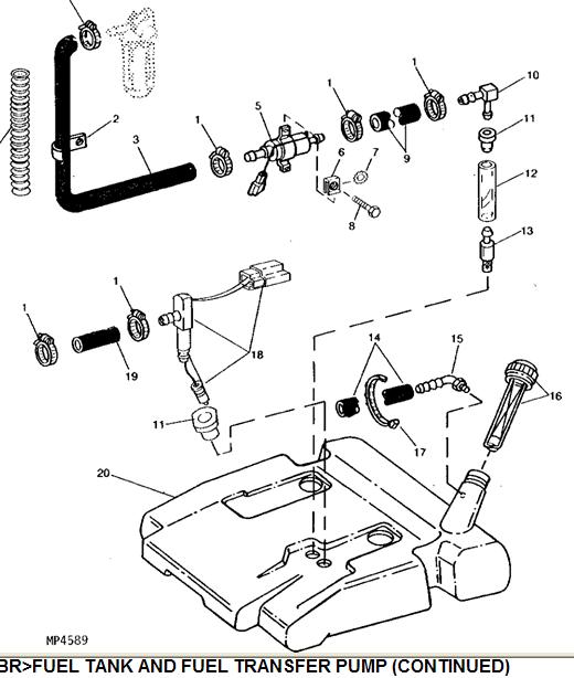

Not following where the leak is at. Are you thinking you can't repair and have to have a new tank?
What is the history of the 332, as you know it? Which part in the drawing is leaking?
   / john deere 332 #3
My fuel tank has a leak at the grommetts. John deere no longer makes this tank. any advice? Thanks Scott
Hi, just change the 2 grommets they are JD p/n M149638. They are still available from JD at about $2 each. Easy fix and you should be good to go. Enjoy your 332 it is a great little machine.
Good luck,
Ken
