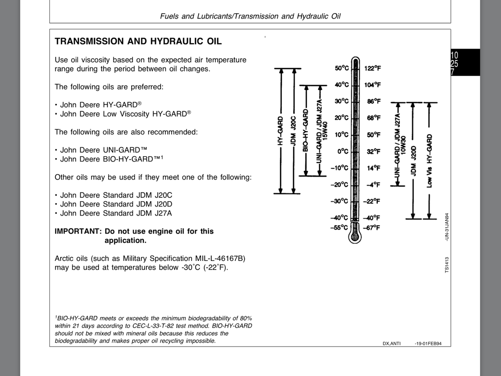

Need some help. I have a 332 Diesel that hasn't been run in over 10 years. I would like to change the Transmission Filter and fluid on it. I have a shop manual but it doesn't help with routine maintenance. I finally found the Filter, but looks like I have to pull the deck and take off a sheet metal cover 8 screws. There appears to be a big pipe going through the sheet metal cover, and I can't tell how the sheet metal cover would come off from around this Pipe going through the back of the cover. I bought the filter and thought this would be a easy straight forward maintenance activity, but seems like it might be a bigger job and more tedious than I thought. Any shortcuts or advice to do this maintenance?

You are correct, it is a straight forward maintenance activity.
1. Remove mower deck, it's probably time to sharpen the blades anyway.
2. Remove belly screen.
3. Drain hydro fluid, plug towards back of tractor. Replace plug.
4. Replace filter and fill with new hydro fluid.
Fluid level should be in the middle of the sight glass at back of tractor.
Use the correct fluid for your ambient temps.

The belly screen has a cut-out where the suction hose goes through. 8 screws and the screen comes comes right off. It's easily bent so be careful.
The largest funnel that will fit and patience when filling. 13pts. moves very slowly through the fill hose to the tranny.
