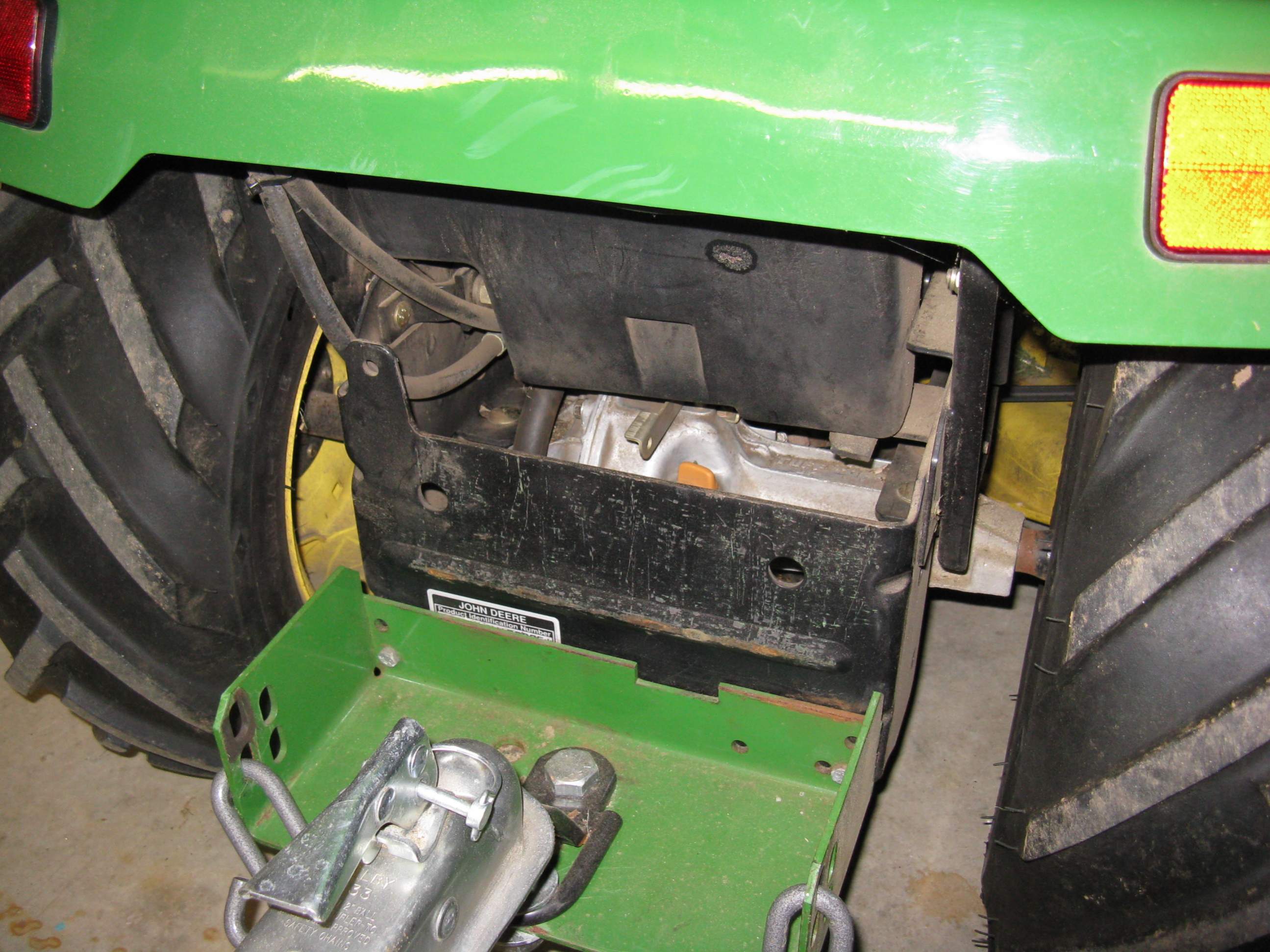

Have inherited a john deere 320 had a new pto clutch put in, basically serviced. But now 2 months the thing has died and won't start. Turn key nothing just the red ignition light comes on. Have taken the battery out to be tested and it tested fine. Has got to be somthing simple but need to get somebody to run the tester on it. Problem is how do you get the thing to roll in reverse to get it out of the garage. Does it not have some king of lever you can pull like on a cub cadet or other tractors. any help with this would be appreciated. Thanks

There is an over-ride lever on the transaxle that will 'shift' it into neutral.
For starting, have you made sure the pto on/off is in off position? That is a fooler sometimes.

Are you talking about a Lawn and Garden tractor like the 318? If so there is a lever on the frame under the rt fender above the wheel. Rock the tractor while lifting the lever and it will disconnect the hydro.
Some things for the no crank problem. Make sure the brake pedal is depressed, the PTO is off, you have to be on the seat, and the hydro lever is at the neutral position.

If this is a lawn & garden 320 here is a picture from a 1993 model that shows the location. Above and to the left of the dipstick in the transaxle. To move the tractor, push the lever down and HOLD it down while moving the tractor.
