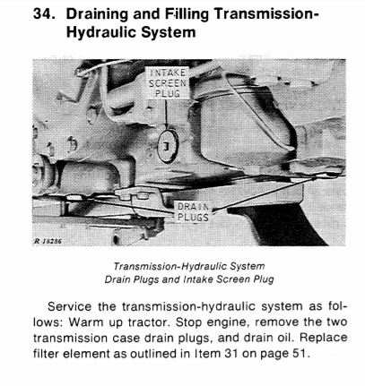

You're welcome. Now would be an excellent time to check/clean hyd oil suction screen. Please update us on your progress.
