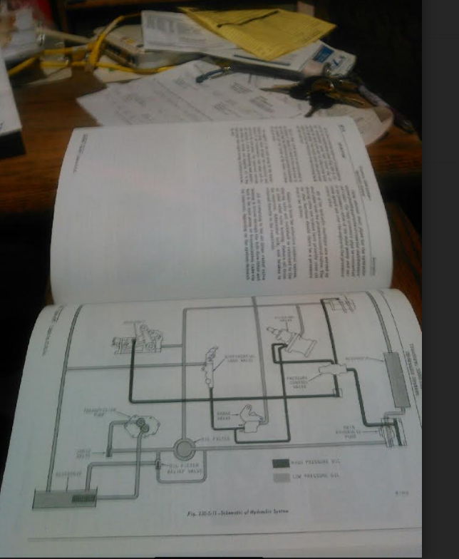

I have a John Deere 3020 s/n 081743 with the following hydraulic issues. Purchased used with several pre owners.

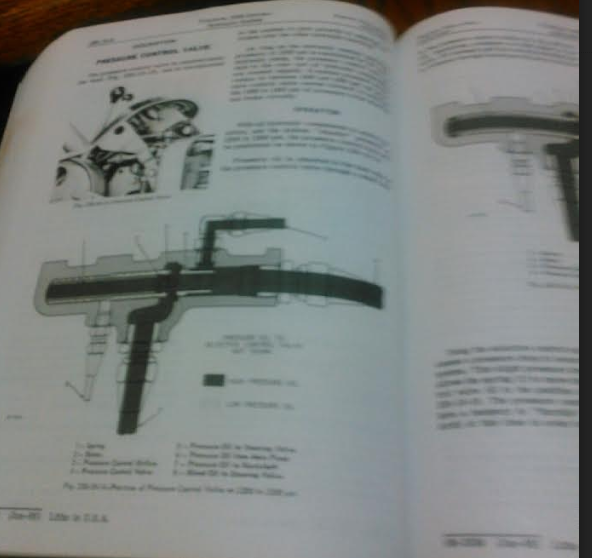

I think you don't fully understand the function of the priority valve on the JD closed center hyd system. The priority valve is designed to close at about 1700 psi so that power steering/brakes have hyd pressure. Technically the hyd system will function without the priority valve in the hyd system. The stroke control valve in frt hd pump controls the pressure. Chattering can be caused by failure of trans pump to supply adequate amount of oil to front pump or internal hyd leaks in hyd system OR faulty inlet/outlet valves in frt hyd pump.

Didn't your SM contain the pages shown below with schematics & explanations? I suppose due to the fact I served as a JD dealer service manager for 13 yrs these pages are easier for me to comprehend.

Yes, it does. But I'm looking for all the individual valves, and passages as well. Basically a hydraulic diagram. What I'm used to dealing with can be explained in the attached of our PC5500 shovel. This is an old diagram, but you can see nothing is left out.
