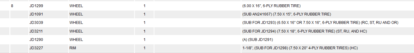

   / John deere 3020 has two different tires on the fromt #4
Here's what parts catalog has for 3020 sn <122,999

I have a john deere 3020 with the wide front end has two different size tires any one know what size tires supposed to be on it?
I usually use 7.50 x 16 Tri Rib tires. Ken Sweet
