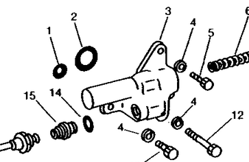

I have a base model john deere 301 and I'm wanting to add 1 or 2 rear controls. I'm leaning towards an aftermarket valve and was hoping for some suggestions. I'm also wanting to confirm how to plumb it. I know it's a closed center system and the return line goes to the filter and have ordered the ported filter cover. I'm unsure of where to tee in for the pressure side. I appreciate any and all advice.
Thanks,
Jeff
   / John Deere 301 adding rear hydraulics. #2
Attach a fitting in orifice on pressure control on RH side by hyd filter housing where fitting(key 15) is pictured. You'll need a 3/4'' ORB fitting to screw into valve housing
