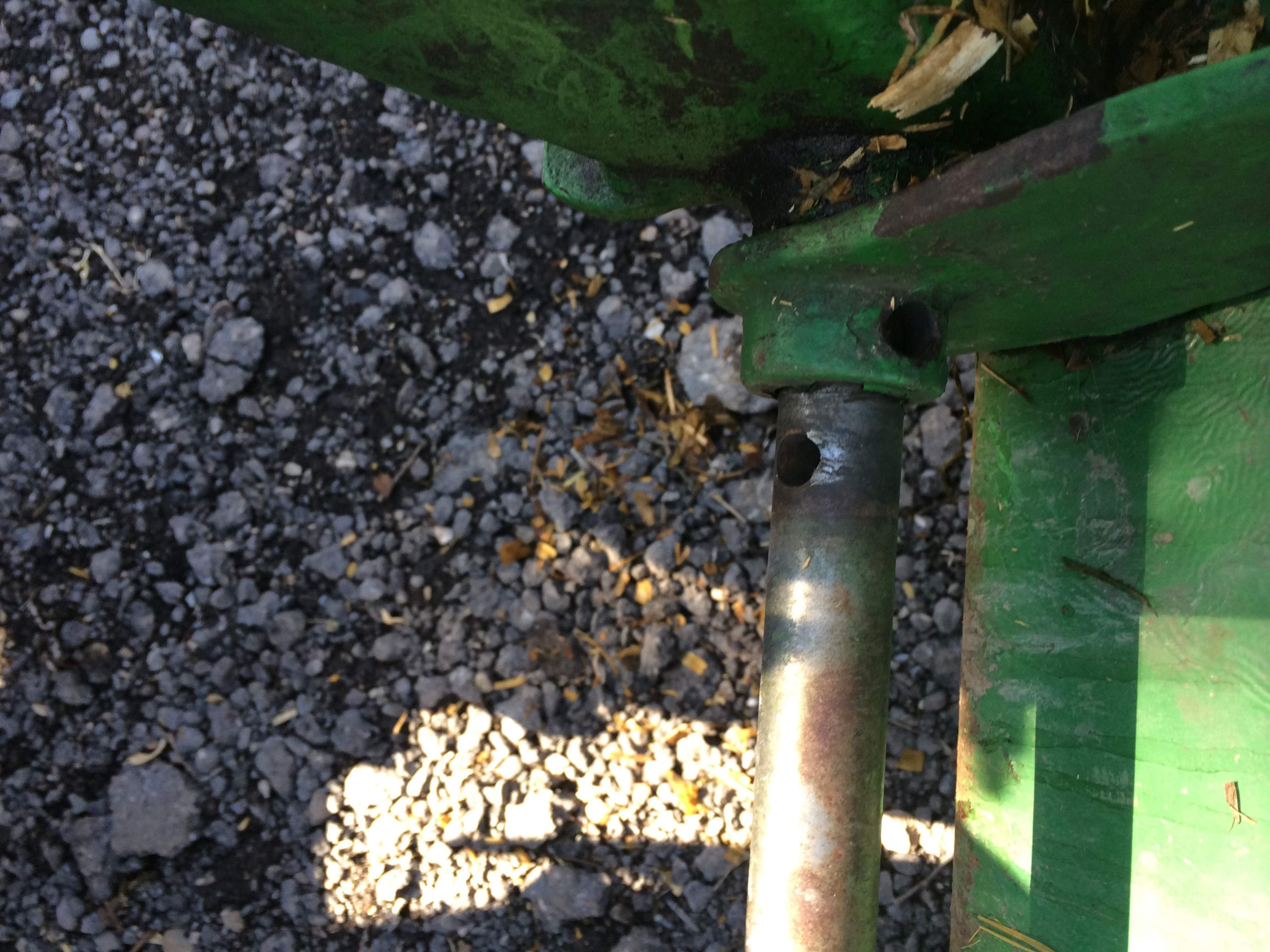

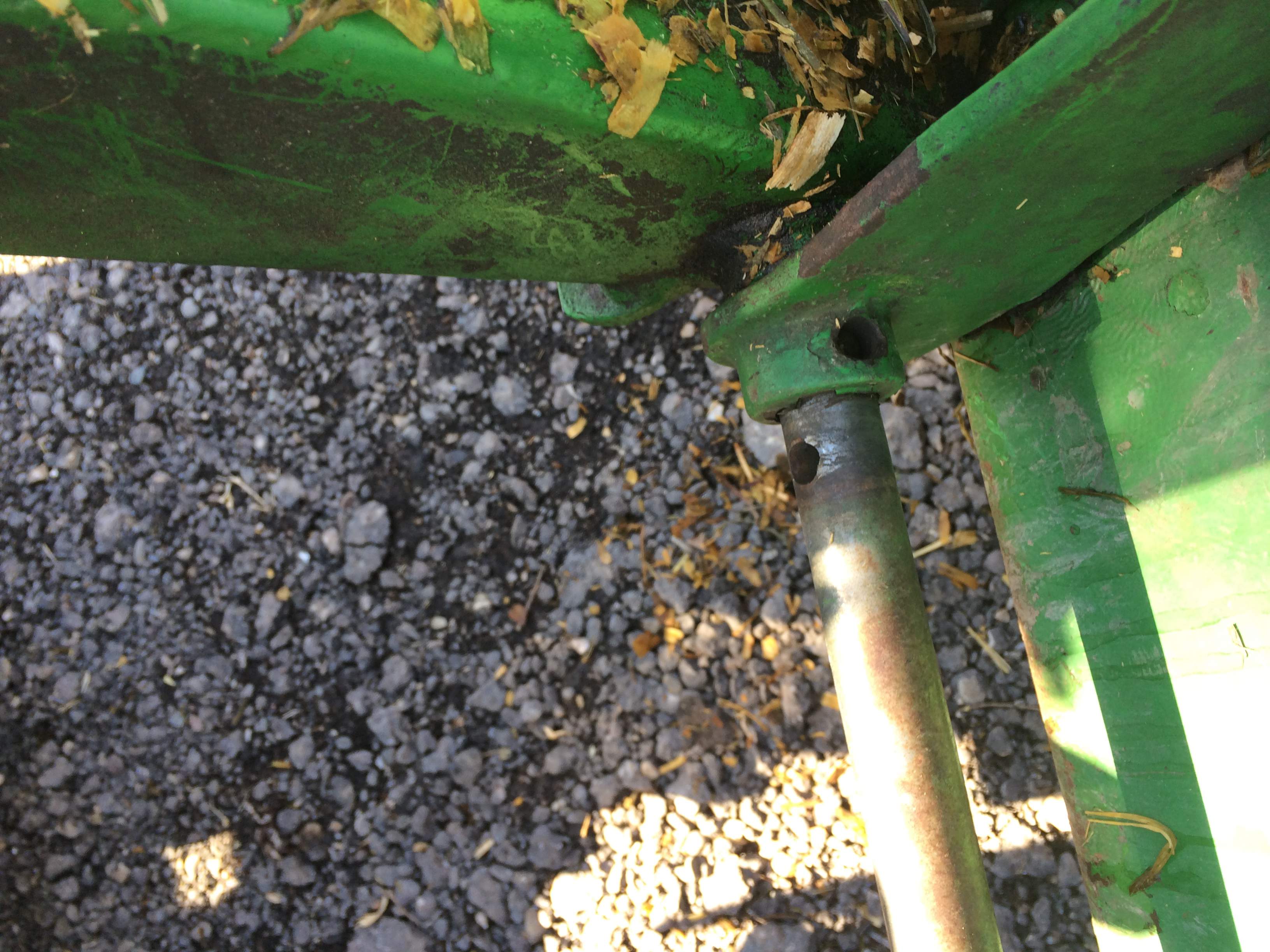

I recently purchased a used JD 3320 with 300x FEL. When I purchased it, I didn't notice the FEL was missing two pin fasteners which held another long pin in (not sure what this pin is actually called, but it's the pin that connects the two boom arms together which is located directly behind the bottom of the bucket).
I was using the FEL this weekend and noticed the pin was floating away on me (see pics below). Luckily, we noticed before the pin slid to far out. Does anyone know what size these pin fasteners are and where I can find them? They seem pretty expensive to order JD brand ones ($4.54 each, plus shipping). I was able to get my hands on some 7/16"x2" clevis pins from Home Depot, but they are just a hair too large to fit through the holes. Any other ideas?

As you can tell from the pictures, the long pin looks like it has been hit with a hammer a few times, so I'm not sure if I'll need to replace this one in the near future. Does this pin need to sit flush against the arm? This pin is also not very cheap (~$150).

that long bar is a timing bar, it helps keep both sides of your bucket paddles
in time when going into the bucket if you change front attachments. it does look
like it has been beat a bit!
the spec for that pin is .394 diameter, you could probably use a 3/8" bolt or something close and
you'd be ok. there shouldn't be excess forces on those pins.

Thanks for the info, Dutch. I want the pins to fit as tightly as possible in there, so there is as little play in the timing bar as possible. It looks like the prior owner had some loose fitting pins in, which may have opened up the holes a bit.
I just noticed I had the wrong measurement for the clevis pins that I found. They are 7/16" diameter, not 7/8". I'll need something just a hair smaller.
   / John Deere 300x Loader Parts Help #4
The JD pins fit loosely, so don't fret over it. When the bucket (or other attachment) is mounted this timing bar doesn't do anything anyway.

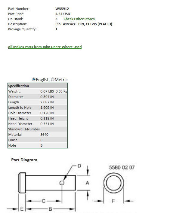

Here's the part number and spec's if you decide you want an OEM pin.
   / John Deere 300x Loader Parts Help #7
FYI, if you use bolts rather than pins; .394" = 10mm
