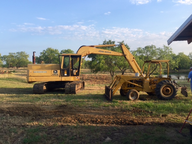

FullSizeRender.jpgI have a 300b john deere that has always seemed to have a slow loader, boom up and tilt atleast. I have noticed that the first time I start it after its been sitting for a couple days if I raise the loader as soon as it starts it raises very fast. after the first time it hits its stand-by pressure (2300) it seems to go back to its slow operation.
This has the original 1 lever loader valve that is stacked together. Parts screen shows it has 2 relief valves in the valve. I Kind of think there is some thing wrong with the valve because I have blown a couple hoses on the loader and with the tractor running oil continues to flow out even with the lever in the neutral position. Steering works good and the three point does not leak. I have plugged the steering line to eliminate the possibility of a leaking steering column.
Any thoughts?

I agree with you. Only line on loader control valve with both spools in neutral that show flow oil if line bursts is the pressure(in) line. On closed center hyd any internal leak will lower operating speed & heat the oil which also lowers efficiency.

Is the viscosity of the hyd fluid correct? Ken Sweet

What valve would you suggest I get? Ive had good luck with cross, my press and return lines are 3/4npt and the 4 lines for the cylinders are 1/2" npt.
-Lance
   / John Deere 300b loader slow #6
Lance
I'd suggest to get a 2 spool closed center valve from Surplus Center or you favorite hyd supply store.
