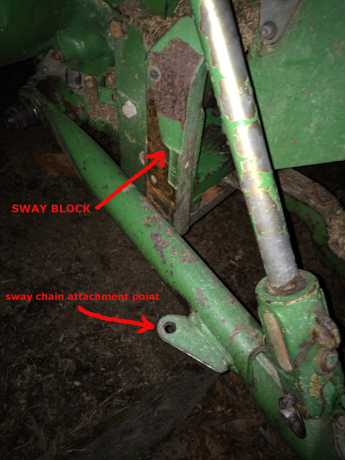

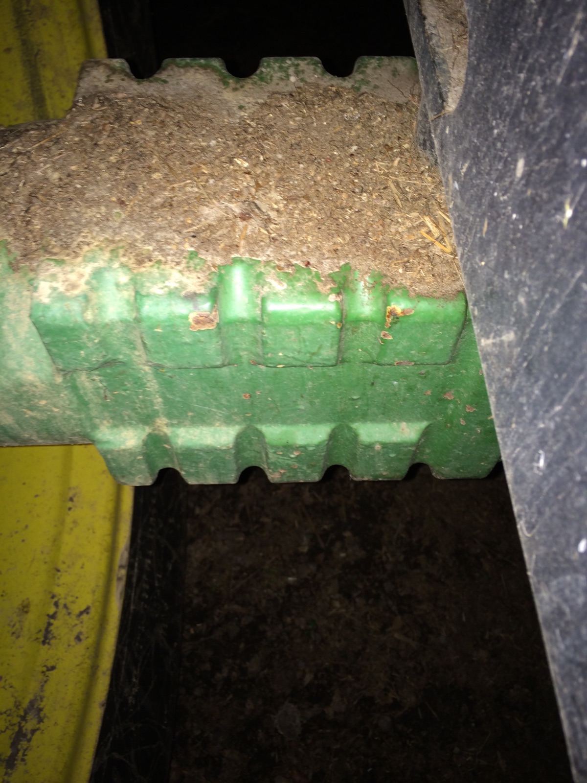

The 2955 came with a sway block set up. Is there an aftermarket or other john deere tractor exact fit sway chain/stabilizer assembly? The axel housing has groves for bolting bracket like the later tractors that have a chain assembly. Ive always liked that adjustable stabilizer on tractors instead of those blocks. Any suggestions or am I overlooking an engineering reason why you wouldn't want the chain stabilizers?

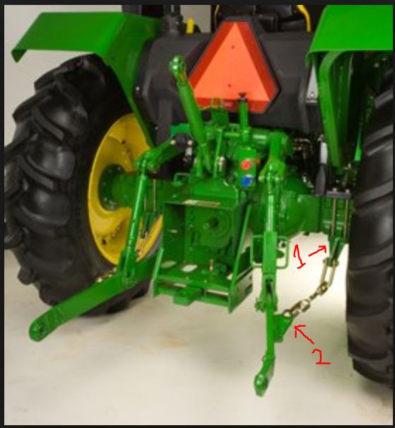

The first pic is a different JD tractor set up with bracket bolted to axle and sway chain attached to lift arm. The second pic shows the 2955 has bolt groves for similar block attachment point and the third pic shows the 2955 also has sway chain attachment point on lift arm. It also shows the original sway block. There must be a part number for the attachment plates and chains for a different model category two that would work on the 2955? Its just not an option listed on JD parts diagrams for the 2955 even though it has the attachment points.

plow, bush hog ,hay spear, disc mower hay equipment rear mounted lift/bucket In particular it would be good to have more sway control with the bucket/lift arm when trying to load unload things ( pallets,hay, loading equipment etc.)

The grooves are for the fender bolts. My 6415 has the axle bracket bolted to the bottom of the axle housing

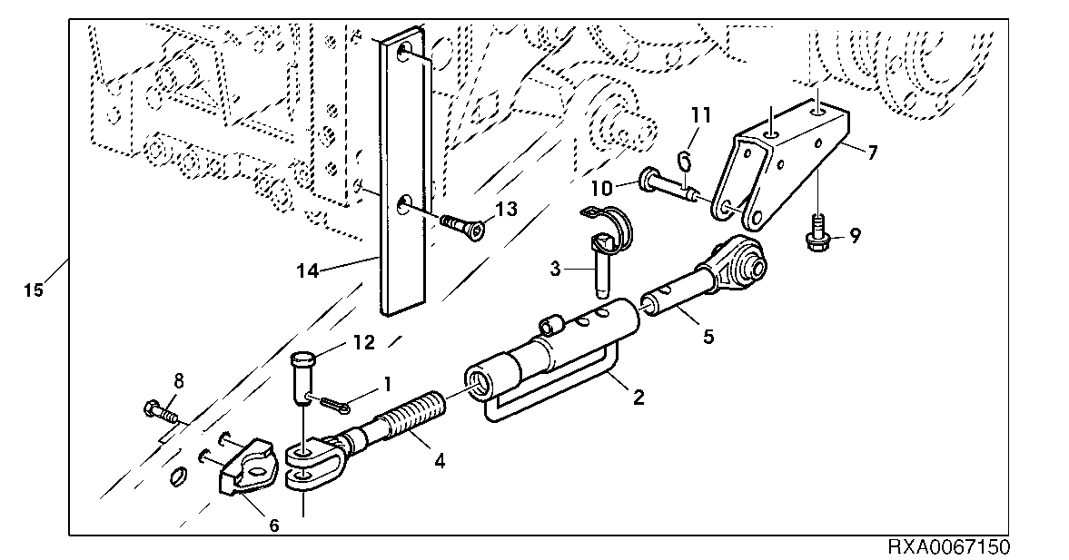

If I chose to not utilize factory sway blocks on JD 20-55 series utility tractors I'd opt for the adjustable sway tubing links with that have multiple holes in lieu of chains or screw adjusted sway links.

I think these were on the 5X25 series tractors

The notches in the axle are for the two post ROPS. The bolts fit in the grooves and a plate bolts under the axle to pull and hold everything together.

to clarify....the first two pictures are of my 2955 built in Germany with soundgard cab. The last picture is a random pic snagged online to show the sway chain setup i'm referring to. As you can see in the 3rd pic the grooves in the axles and plate/bolt combination has an attachment point for the sway chain setup that is again attached to the hole on the side of the lift arm. My 2955 as you can see in the 1st and 2nd pic has grooves in the axles that could hold the same attachment plate and the hole in the lift arm to attach a sway chain to. There must be a part number/assembly for a another tractor for the sway brackets, and chain or bar that will bolt to the axle and attach to the lift arms.

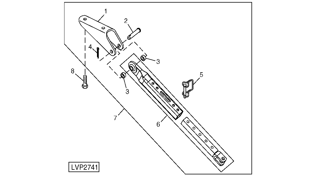

Is this what you're asking for? If so it can located in JD 2140 parts catalog

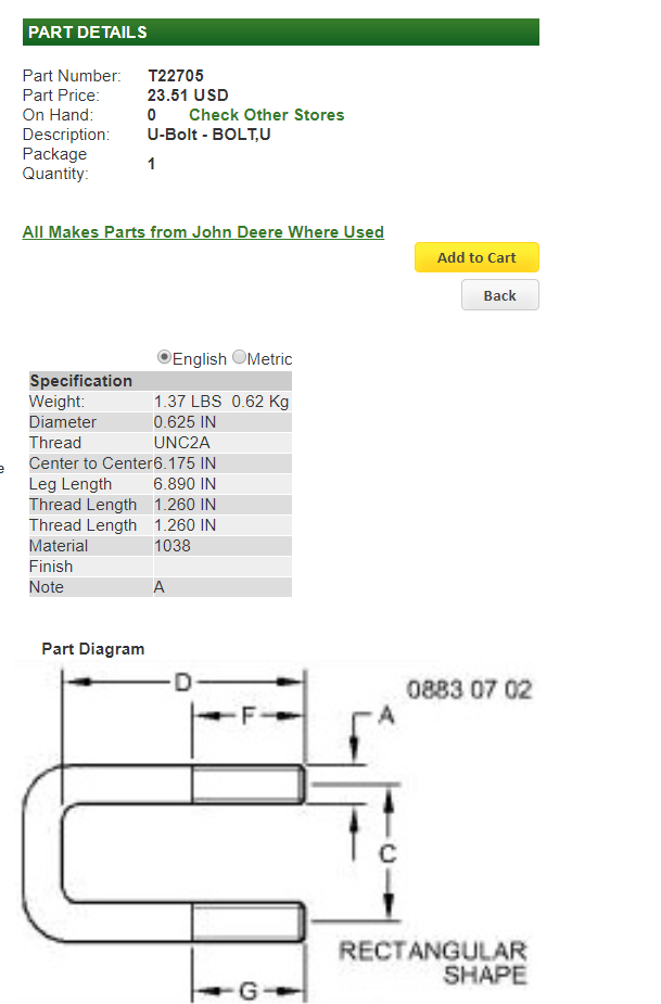

yes that's what im looking for....pending it will fit.....not sure how the axle housing compares on those two tractors. I was hoping someone would have already done this and chimed in. I guess its either time to measure that bolt in the diagram or fabricate my own plates to attach to axle....the chain wouldn't be as big a deal to lengthen or short

Here's the spec's on the u-bolt in previous photo.
HTH's,Jim
