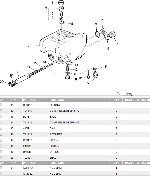

Have no direct knowledge of this brake valve, only can post the schematic of the part shown in jdparts.com.
If it looks like this, may give you some idea seeing the different parts.

I think although you have addressed the equalizer valve the brake problem still lies with a faulty equalizer valve.
   / John Deere 2940 Left Right Brake Problem #4
I agree, equalizer is at fault. Is the ball seat OK? Is the seat replaceable? If not, maybe you can get dremel tool with a round ended bit that you could use to polish the seat with valve grind compound? Or maybe you will have to replace the housing to repair the ball seat?

Thanks Zebrafive. The ball seat is part of the casting as no separate seat is in the diagram (thanks 'Beenthere'). The valve casting is prohibitively expensive, so your dremel idea is certainly worth a try.

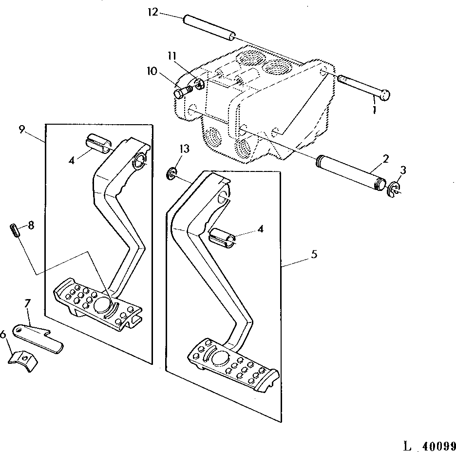

Your problem may be in the stop crew adjustment for the pedals. Try adjusting the screws by loosening the jam nuts and screwing both screws in far enough that they are not contacting the pedals. Then back them out until they touch the pedal and then back them out an additional two flats of the bolt(one third turn). After that if one pedal is higher than the other, back that screw out one flat more to even them out. I have had many of them be cured with this adjustment.

   / John Deere 2940 Left Right Brake Problem #8
If you have no stop screws, then they are missing. Should be 2- 3/8" x 1 1/2" bolts and jam nuts. There should be threaded holes in the valve body. I am attaching a picture of the screws on a cab tractor valve, open station is similar. bolt and nut is #10 and 11.L40099_________UN01JAN94.gif

If you have no stop screws, then they are missing. Should be 2- 3/8" x 1 1/2" bolts and jam nuts. There should be threaded holes in the valve body. I am attaching a picture of the screws on a cab tractor valve, open station is similar. bolt and nut is #10 and 11.View attachment 404862
jd110 - you are the best. Thanks for knockin' me upside the head! :drink:
I went back and looked at the right area as you described, and the pedal stop screws were there of course. Ten minutes to get them set right per your instructions and I now have left and right brakes! It must be that brake pistons allow bypass if there is any freeplay in the pedal. I only had 3 or 4 mil, but that was enough to cause the equalizer valves to send the hydraulic fluid down the low pressure path. One full turn of the stop screws and the differential braking is 100%.
