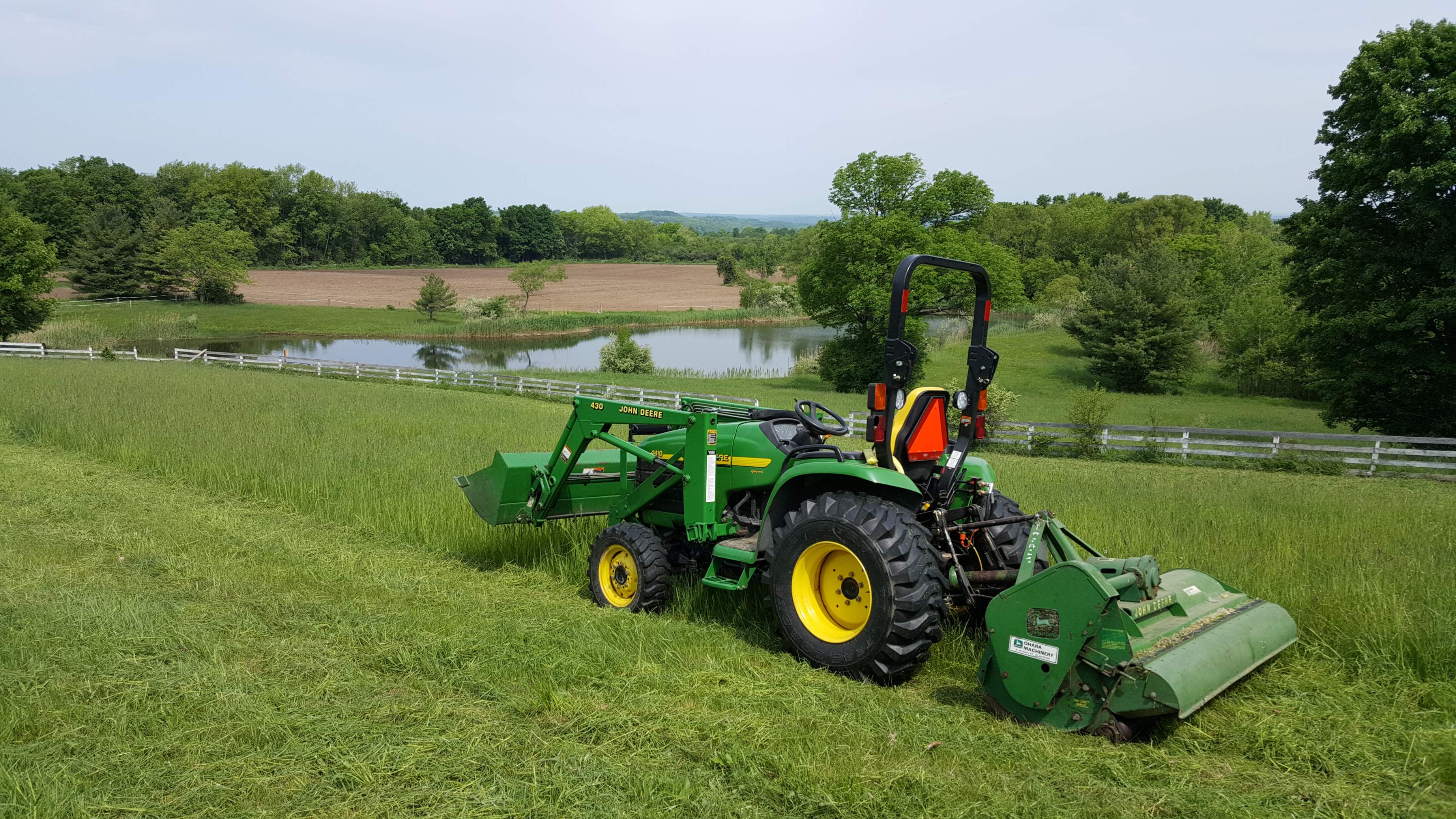

I got lucky and found a John Deere 25A flail mower on Craigslist. It was built in 1981 and is in very good condition!
I still have the brush hog for rough areas, but now that I've got these areas cleared out of large rocks, small trees etc. I can use the flail mower for a nicer finish.
It cuts great and even came with an extra set of knives, a belt and the owners manual.

Great. Looks like you could be making hay too.
   / John Deere 25A Flail Mower
That would mean more equipment and time. I have neither one!
   / John Deere 25A Flail Mower #4
Nice looking mower and farm.

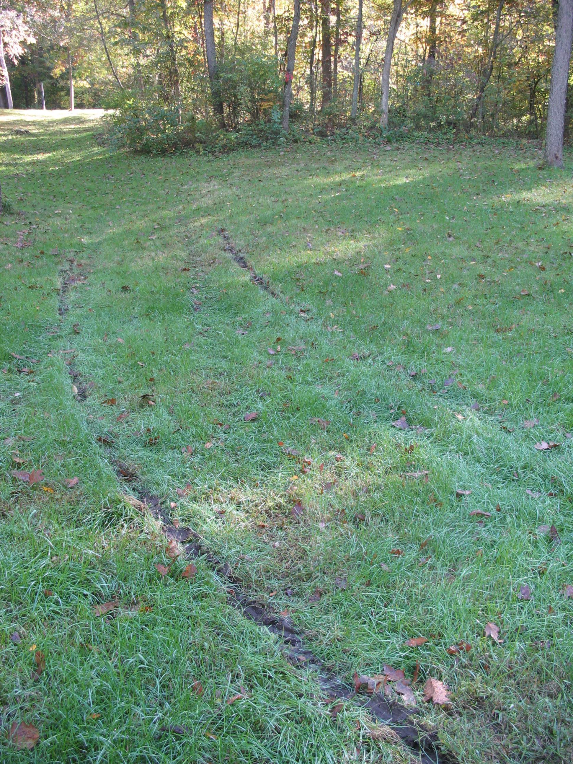

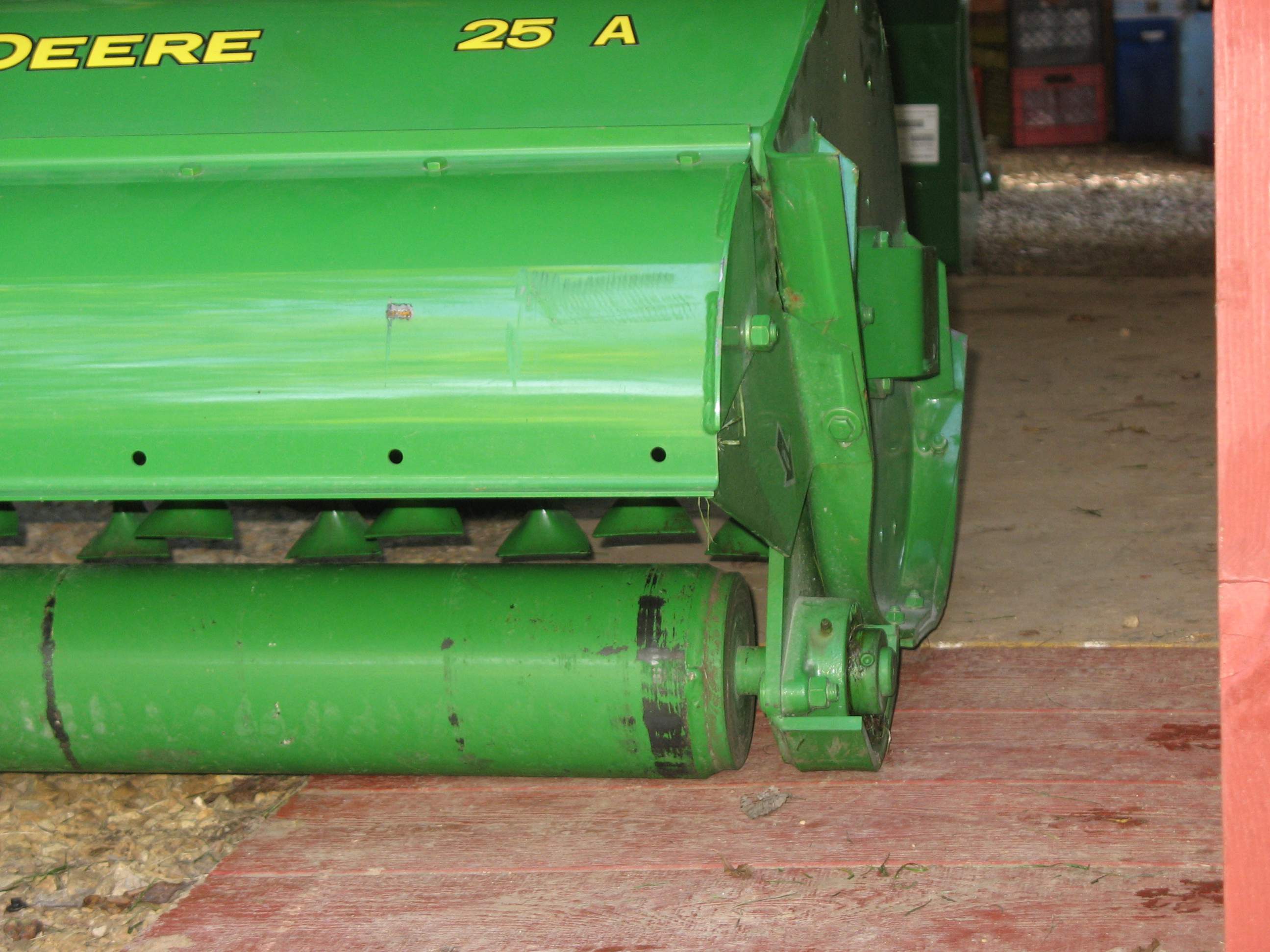

Interesting, your positive experience with JD's 25a. I bought a new one last year, and was extremely disappointed with it. Primary reason was deere added protective shoes on the underside of the roller bearing housings, the roller that controls cutting height - see pic. Apparently they were concerned about wear and/or damage to those bearings. But the shoes decreased the clearance to the ground, and the result was they would gouge out the grass anytime you mowed an uneven surface -- made a mess of the ground - see pic. I hauled it back to the the dealer, demanded a refund, and eventually took a $800 loss on the deal.
Also, I found that the 25A is a very old piece of equipment, that most competitors have bypassed with better features. Including the cutter drum rotating counter-to-travel direction and a scraper to remove debris from the height roller.
