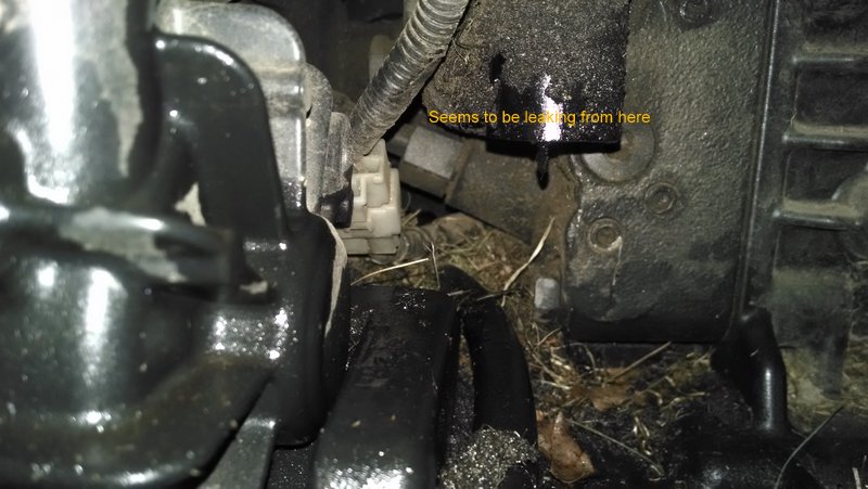

As you wrote your reply.. I went out and pushed the pin in on the male connector (using towel around it).. it worked.. and I am now back alive (still challenged to get it aligned but I will do it).. so that is good. When it rains it pours though.. I may have a leak of hydraulic fluid... or I overfilled it.. 1-IMG_20140803_175814704.jpg... as I was adding some additional fluid.. seemed to leak from spot labeled on picture.. solved one.. now another.. THANKS!

If you have a leak check by the hydro filter, there is a pipe plug by it (not the drain plug). Mine was dripping and the plug was about a thread from falling out. Mine has a skid plate on which made it hard to tell where it was leaking from.
   / John Deere 2305 removing Backhoe
Where is the hydro pump located on the 2305? I don't have the service manual. I assume it is near the top of the rear unit under the hydro fluid input cap? The leak is happening right there (below left of seat). THANKS
   / John Deere 2305 removing Backhoe #9
Am thinking your hydro pump is on the front side of the center housing, near/above the hyd. filter. And yes, near the hyd input pipe.
Look in jdparts.com for all the parts on the 2305.
Also the manual shows it. OMLVU23228_B0
