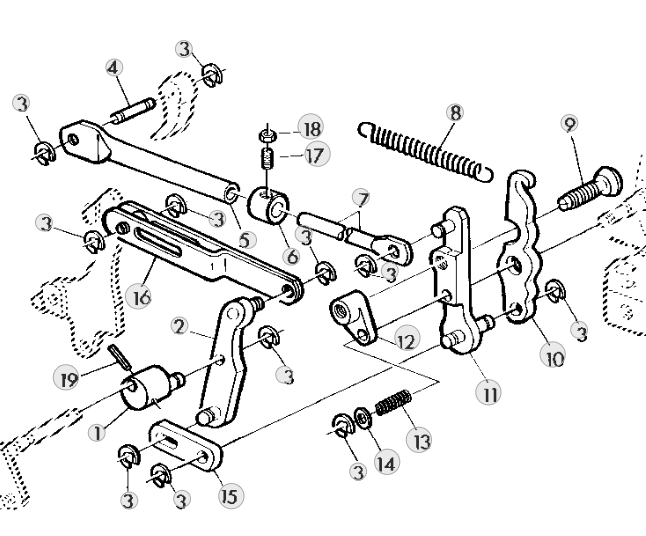

My guess is L/D control mechanism needs to be adjusted as outlined in JD tech manual or cam follower(shaded part in photo below) is not located in correct location in rockshaft control linkage.
1st step is put L/D lever under seat in "D'' or minimum which ever applies to your 2155. Tiller going too low in soil should have no affect on 3 pt control linkage unless cam follower in photo has a problem. I think one can inspect location of cam follower with a bore scope inserted in open hyd filler hole behind seat. Another possibility is spring(item 8) is broken/disconnected
