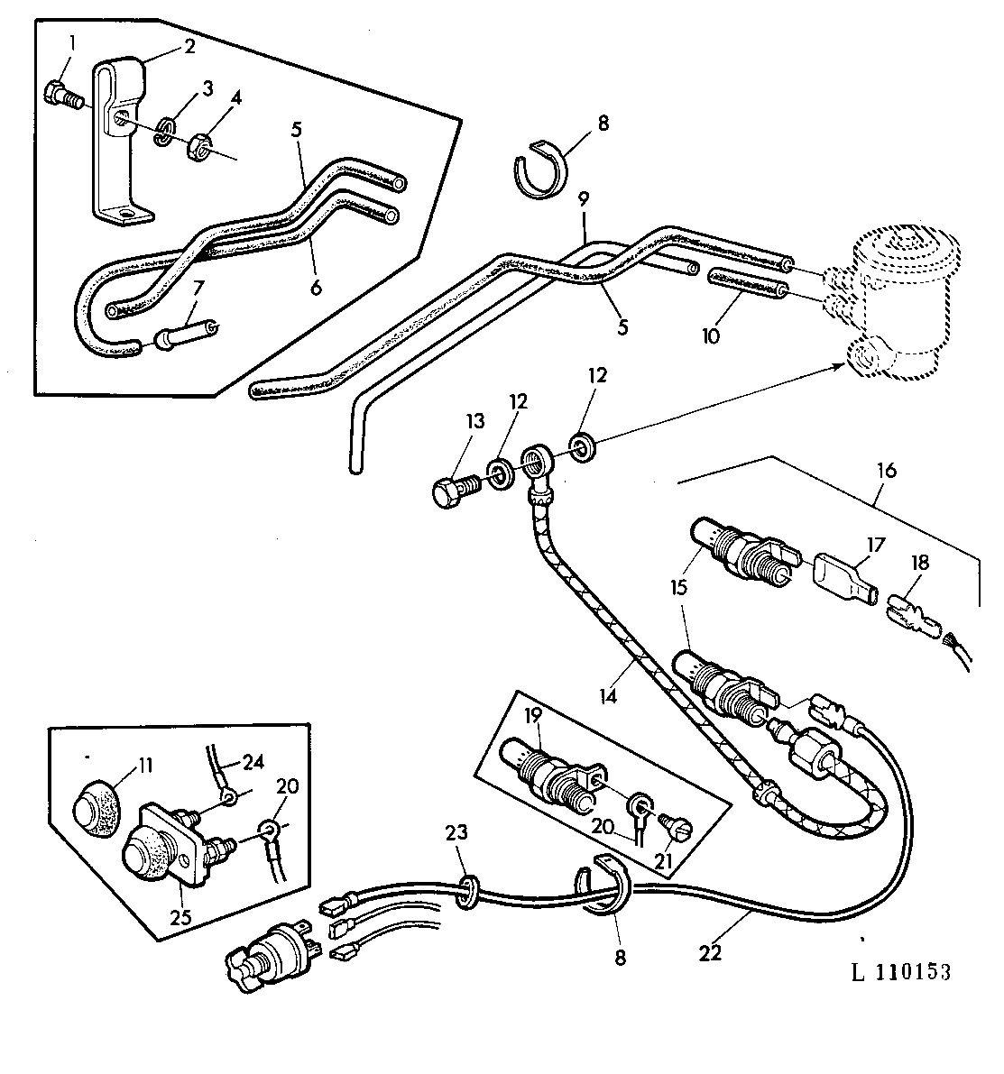

First off none of the dash lights or gauges work. In this cold weather i have to use ether to start it. I was wondering if these tractors had pre-heaters on them. It has a block heater on it but the cord is damaged and not safe to use till i rewire it.
Also i don't know if its euro or Canadian
   / John Deere 2120 #4
According to parts catalog it could have this cold weather starting aid.
