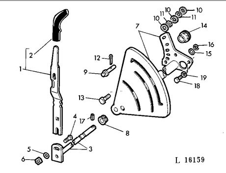

It sounds like you might have 2 separate problems. If the hitch rises on it's own and the control lever is rising also, you have a problem with the friction washers on the lever not working right. There should be 3 flat washers there with 2 spring washers sandwiched between the flat washers that acts as a "brake" to hold the lever in position.

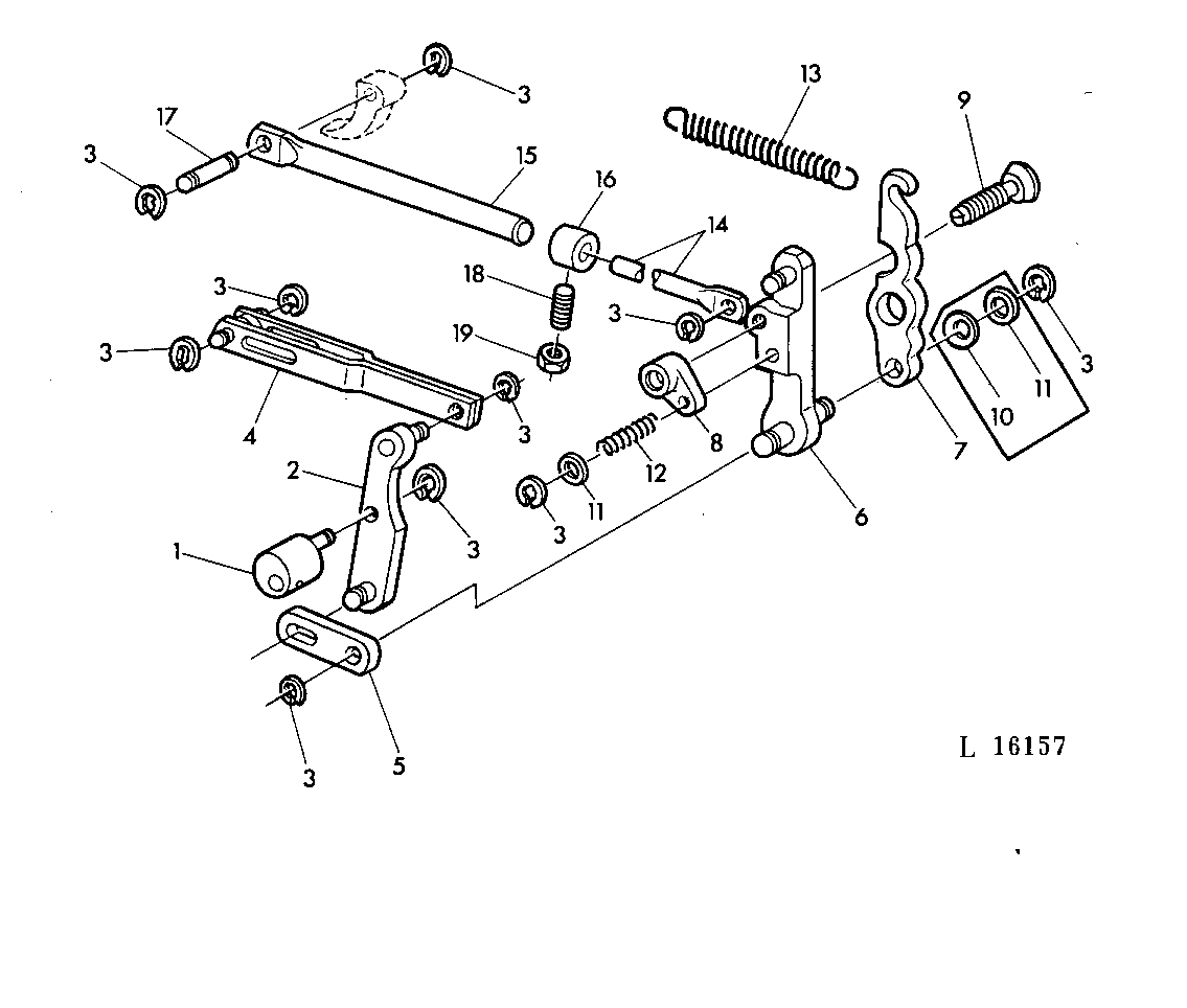

Yes, as the links rise, the lever rises also. From what you are describing, I should be looking at #10 & #11 on this diagram to correct it? Sounds easy enough. rockshaft lever.JPG

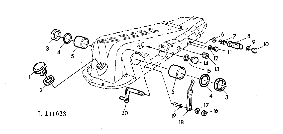

On 3 pt lowering when engine is stopped with 3 pt raised,engine running look inside hyd filler hole for spraying oil. JD utility tractors such as yours have a history of the control valve o-rings leaking. It's also possible the control valves are adjusted too tight which adjustment can be altered without removing RS housing.

IIRC you need to remove plug(parts key #14) in RS housing to access adjusting screw(parts key #9) on linkage.
Hi Tx Jim,
What result should I expect to change by turning it in vs turning it out so I can figure out what to look for when I adjust it?
Mark
