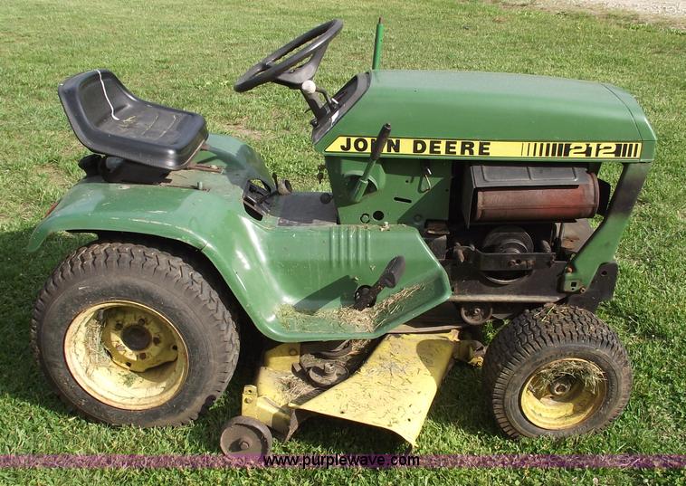

The JD 212 is an older machine in the 200 series of 210, 212, 214, 216, 218 all with Horizontal crankshaft ''K300' series engines. The last 2 digits were the HP size of the engine fitted. I suspect we may be looking at the 12 hp version if that is the case?
212 restored (1989) - Google images:

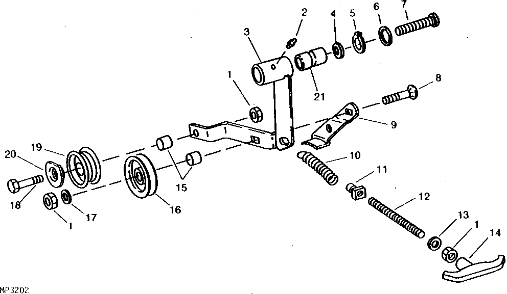

With side cover removed the PTO drive is visible:
The PTO drive Tensioner is of this form:
The PTO control is of the Lever/rod type in two forms for S/n 0-8000 and 8000-190000 then Electric PTO clutch from 190001>

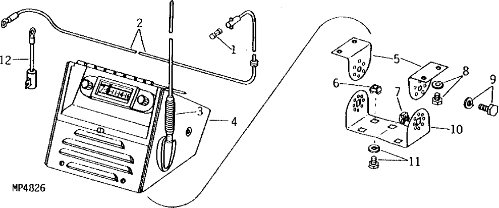

Pretty cool old ride-on's as (according to the the Parts List) they had the option of a fitted radio! :cool:
How one would hear it over a K300 Kohler I don't know.
