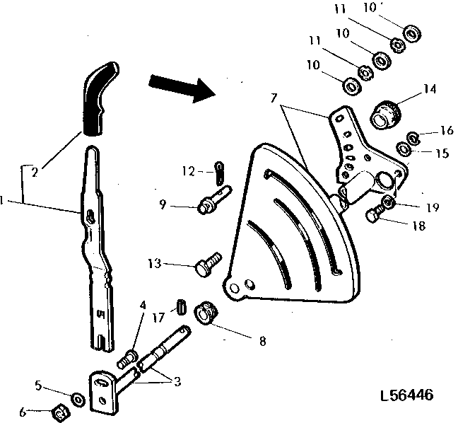

I have broken the lever that raises and lowers the 3-point hitch arms. I was wandering if anyone on here has ever repaired one of those and if so what does it entail. It looks like I have to take a major plate off the top of the tractor (below the seat) to gain access, but before I started I wanted to get a little insight. I appreciate any advice or suggestions. Thanks.

and looking your tractor up. The parts diagrams can be invaluable for making repairs like this.

Thanks for the reply. The part that is broke is number 3, I am going to explore the site you recommended. The lever is broke right at the base of the tractor. I am interested in some advice to begin the fix. Thanks again.

ok housing is off and all looked well except looks like parts are made to not allow parts to "fall" into gears if control lever was to break. Here is my problem, the cylinder needs to move a little to allow the possibility of pushing out the control lever. I have removed four cap screws and two screws on the outside of the housing (which look like they could hold cylinder in place) and cylinder still does not budge. Is there something else that could be holding cylinder in place? Any suggestions ideas would be great. thanks.
   / john deere 2030 #7
Isn't there just a roll pin you have to drive out to remove the broken shaft?
   / john deere 2030 #8
There are five bolts that hold the cylinder in place. The four obvious ones on the bottom, and one on the front side of the housing that is horizontal from front to rear near the neutral safety switch. Although zebra5 is correct, you shouldn't need to move the cylinder to replace. There is a snap ring (#17)that is between the quadrant (#7) and the housing. unbolt the quadrant and the broken piece should slide out after the roll pin is removed. Then install the new lever in the quadrant before you slide it into the rockshaft housing and reinstall the pin. Sometimes the broken shaft is bent, which may require moving the cylinder to tap it out with punch and hammer.
