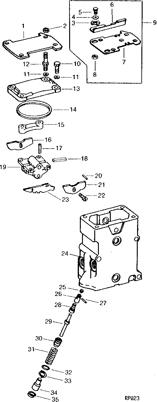

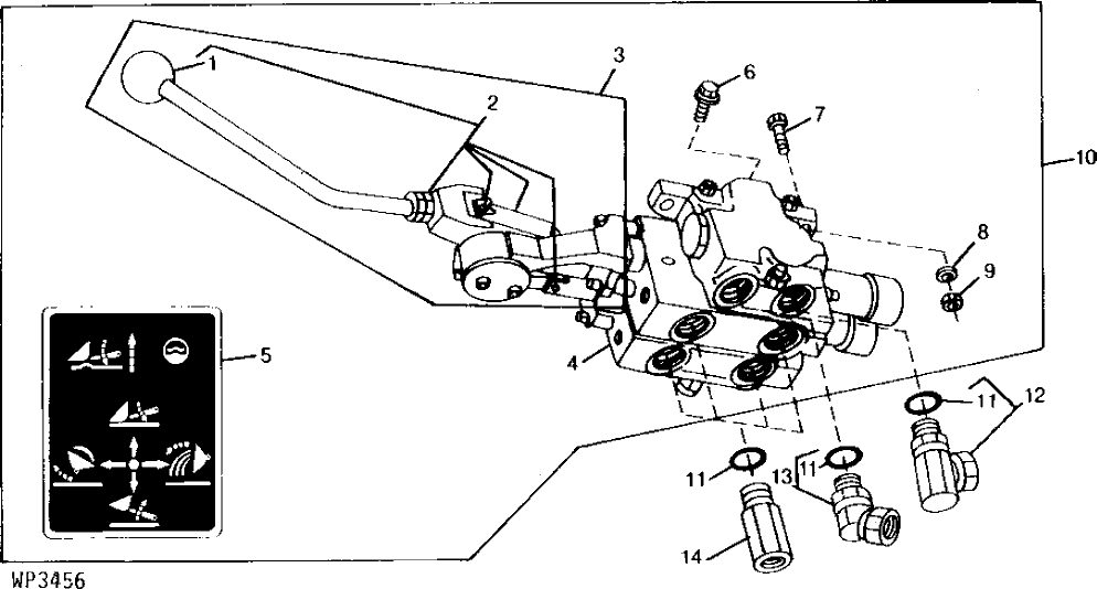

How is loader controlled(scv or ind valve)? Look in hyd filler hole with engine running for spraying oil with 3 pt raised. Check hyd functions with a laser thermometer for abnormal heat.
   / John Deere 2030 Hydraulic Chatters
Please coach me on what a scv or ind valve is. I'm new to hydraulics. I'll check for the spraying oil. I don't think temp is an issue since this problem starts before the tractor is even warmed up. I'm working at a remote location so it will be this evening before I can provide the answers. Thanks.
   / John Deere 2030 Hydraulic Chatters #4
1st photo is scv valve housing. 2nd photo is loader ind control valve.
I don't recognize either of those assemblies but it is certainly not the second one.
