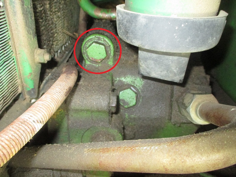

jd110,
Is this the location of the filter in the pump?
And thanks for the list of possibilities. I will report back with my findings tomorrow.

Sorry I haven't been back on, but yes that is the location of the screen in the pump. You remove the plug and then there is a rubber seal that needs to come out to get to the screen.

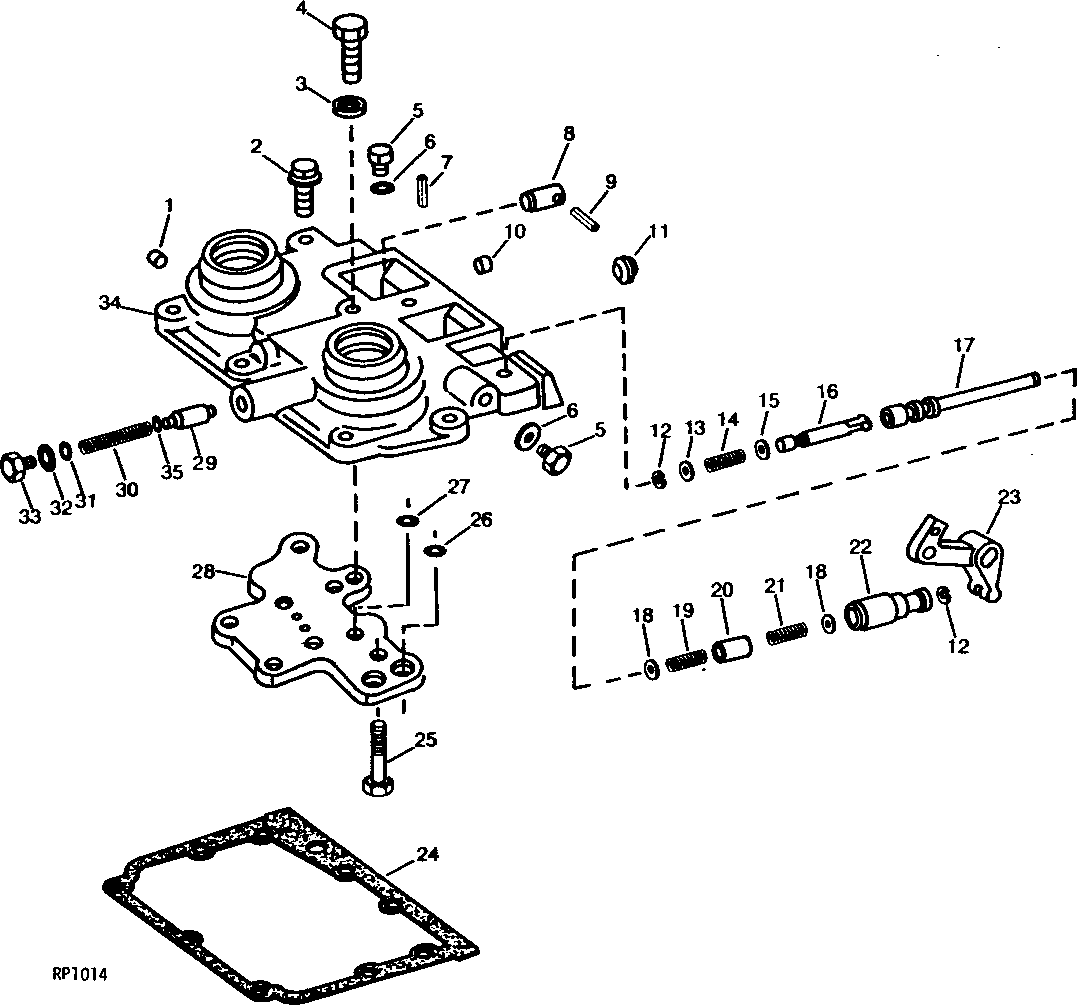

I don't want to get between you two bantering back and forth, BUT, I think this is the valve buickanddeere was referring to. It is the pressure control valve for the hi-lo adn independent pto. And yes the pump does have to build between 140 and 160 psi to supply engagement pressure for these options before any oil flows to main pump. Key 29 is the pressure regulating valve. If tractor has no independent pto, hi-lo, or reverser, there is no pressure regulating valve. RP1014_________UN01JAN94.gif
