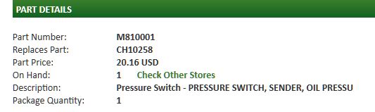

Might be as simple as a faulty oil pressure sender. I'd recommend checking engine oil pressure with a manual gauge.

Replaced pressure switch sometime back & also have manual gauges now for oil pressure and temp.
