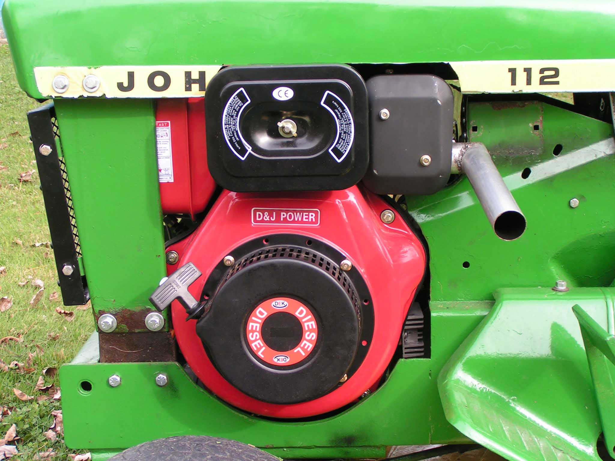

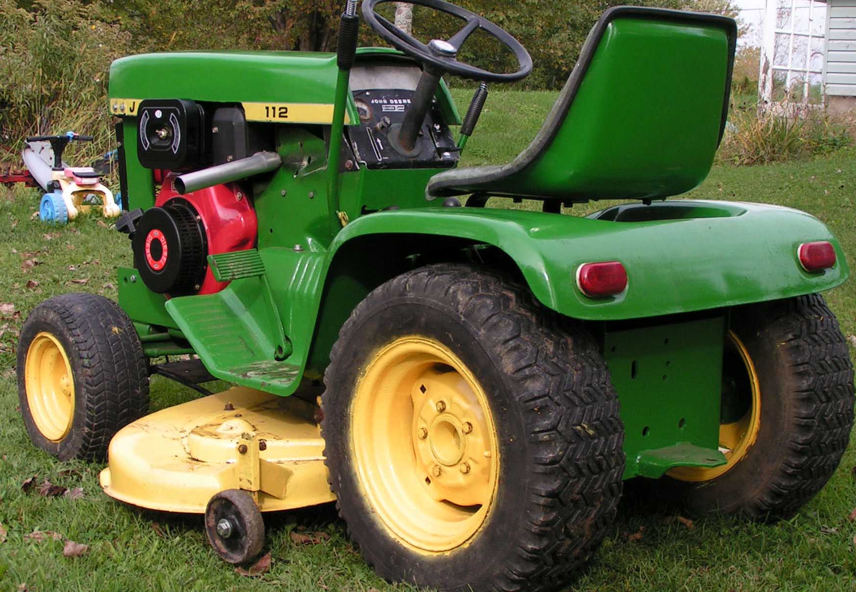

Hi! I buy a very used John Deere 112 . I fit a Dek-Diesel 10 h.p engine. Just minor grinding Jobs some welding. Crankshaft is about one in. more high and half in. more front .Hood is 3 in. more high. I like Diesel engine. Less maintenance No Carb. Float needle choke No ignition Sparkplug Point condenser or ignition module etc.. You have High torque and INCREDIBLE FUEL ECONOMY Less one liter hour. VIBRATION and NOISE are HIGH. This engines pay itself in 300-400hrs. Thanks and Good luck! Oldmech

Hi! For Clutch PTO lever arm ( 1.5 in more long.) Some light work . I weld a piece of steel 1\4x 1 in.X 2 in. at tractor frame. I drill in a 3\8 hole (one inche more high and half inche more front) for support level arm. Belts are two in. more long. all work very well. I buy this engine from local classiffied ads. I pay 580 CDN. You can find 10 h.p. diesel engine on ebay for $500 or less. Good Luck! oldmech
