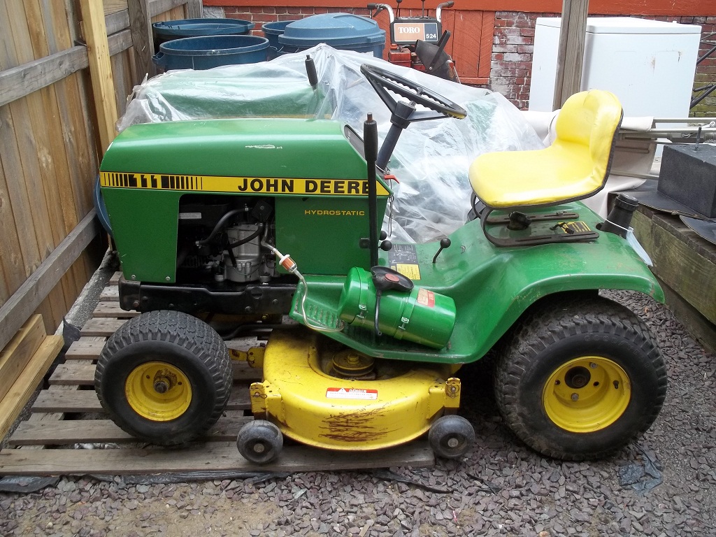

Hi Guys,
I got my JD working today, bought it for Cheap, but it takes like 3 Cranks before it starts...
It is because of the Fuel Pump? Fuel Pump seems to be working since I can see the Gas sucking up.
Does it take a few Crank before the Gas enter the Carb? Is that possible? I dunno much about the Fuel Pump since I'm new to it all.
NOTE: Battery is Good, just cleaned out the Carb, nothing blocking the Air Filter or the Exhuast. Compression is good too :)
Thankx !!!

Hey, nice rig. I just sold a standard 111. They are good 30 year old machines.
Now, about your starting question, not likely your fuel pump. The pump is responsible for continued fuel flow but has little to do with the inital start up. Make sure all of your throttle and choke cables and linkages are in place and working smoothly. What happens if you give a short shot of carb cleaner in the carb throat? Does it start right up? That would point me back to carb or choke issues.
Good luck and please let us know what you find.

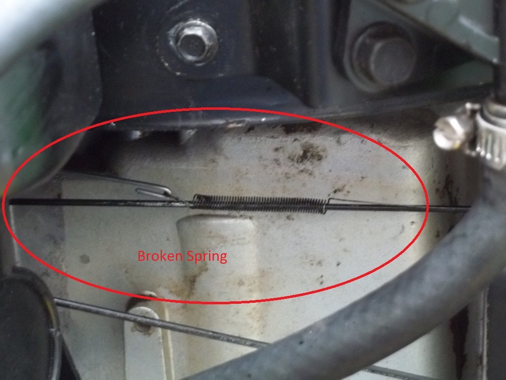

Hi, thankx for taking your time and answering my question.
1. I did just that, I sprayed some Carb spray in it and yes, it starts right away...
2. There is a Broken Spring on the Throttle (a Long thing that pull the Throttle back and fourth when you excelerate and it connects to the Governor?) which I hooked / Rigged it back up. I dunno if I did it right... Seem like Closing and Opening OK and the Governor seems to move Back and Fourth like it should.

That long spring that goes over the throttle rod is important. It keeps the slack out of the governer linkage and reduces 'hunting' without a load on the engine.

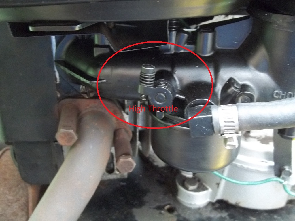

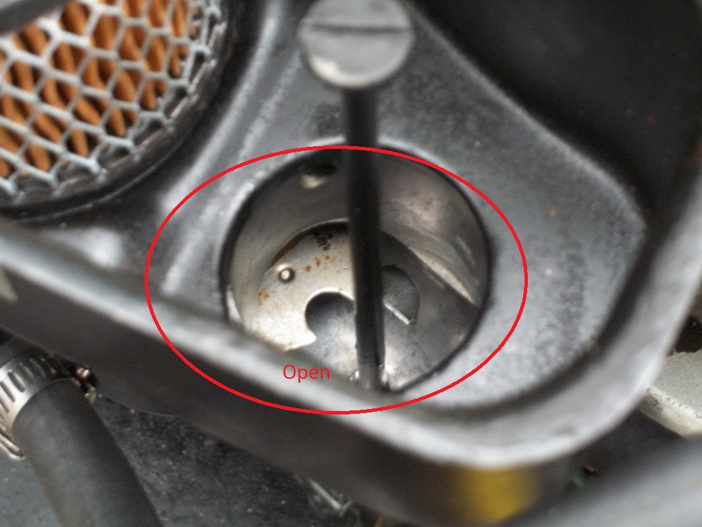

Anyway, question about the Governor...
If the Governor go toward the Front of the Engine, is that when the Engine goes HIGH? That Spring is moving back and fourth.... When I put on Choke, the Governor goes toward the Front / Carb... Is this Normal?
Gonna take some Pix, brb :)
:D
   / John Deere 111H - Take a bit Start?

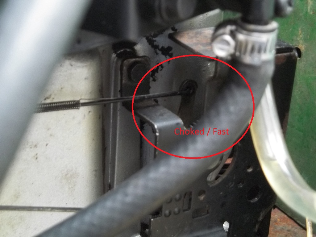

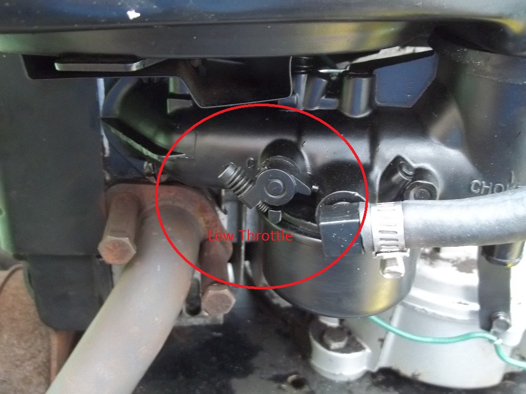

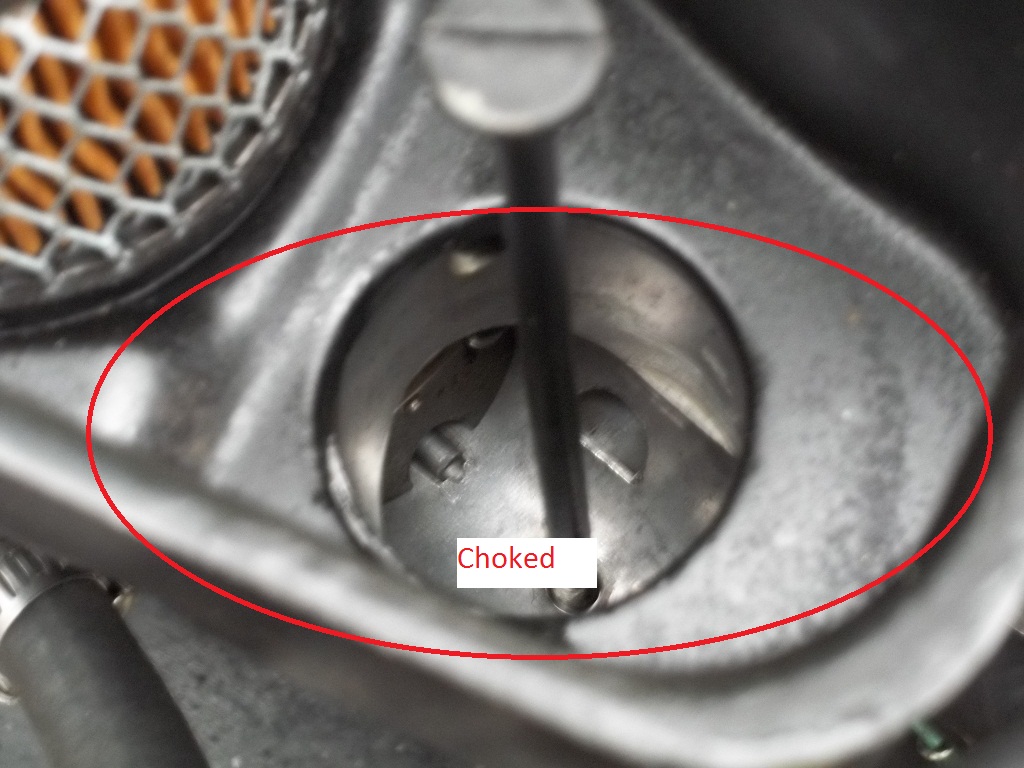

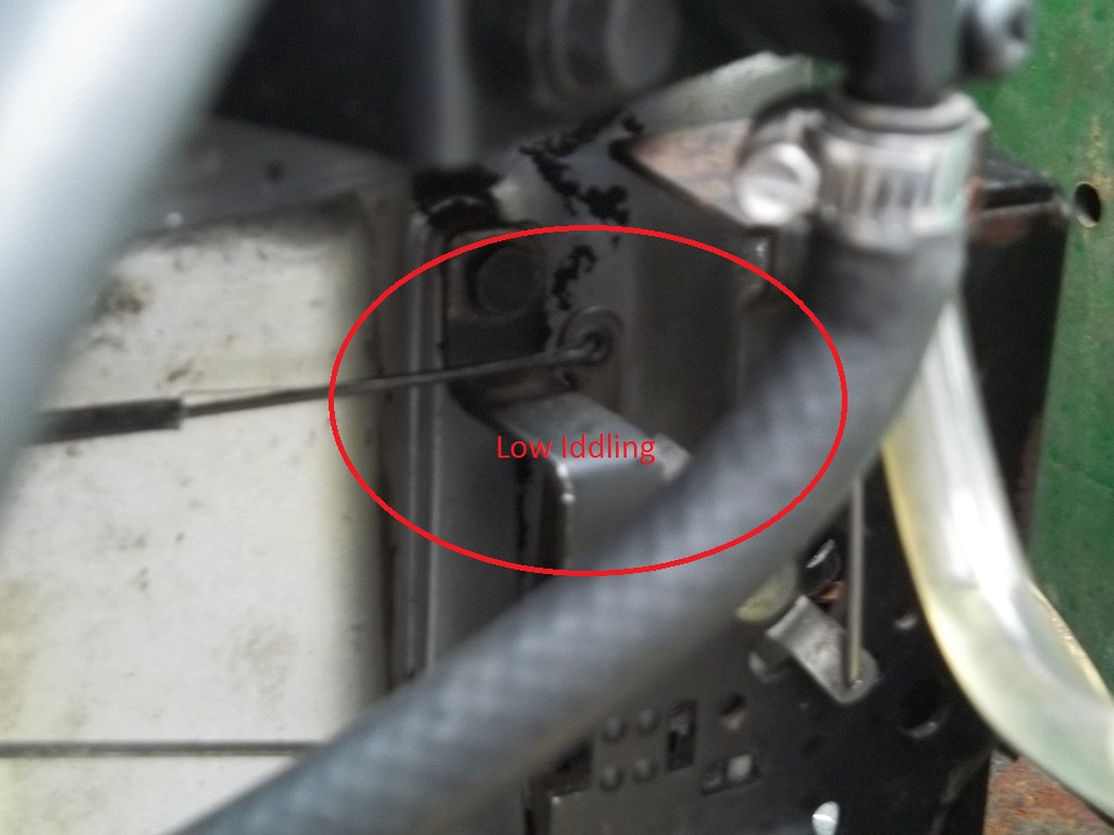

Here are the Pix....
I Spray Painted almost everything Black to prevent Rust and stuff... Sorry if hard to see...
Please tell me if these are Normal :)
Thankx!

As I remember from mine, your linkage is working correctly. I do remember that I needed to sleeve the throttle shaft on my with the correct ID brass hobby tubing. The steel shaft had worn an egg in the cast carb housing and it was hard to get the jets dialed in. If you have extra air getting past the choke blade that may be part of your issue.
I would also check for a good blue spark with a spark tester. You may need to adjust the magneto air gap or clean the rust off the pole pieces. Not hard to do, just take your time and shoot lots of pictures on your way in.
Please let us know what you find, Alan

Hi Alan,
First, thank you for your Knowlege and passing it on to me... I think you might be Right on the choke issues... I didn't have to Pull the Lever to Choke to Start. If I Choke it, it won't Start, but if I leave the Lever just Half way it Starts easier...
I have been working on another Project... Doing a Bathroom to save some money, LOL so I haven't go a chance to continue with me Tractor. I have read your reply but NEVER got to say Thank you! Sorry....
P.S. I will update once I get to it :)
