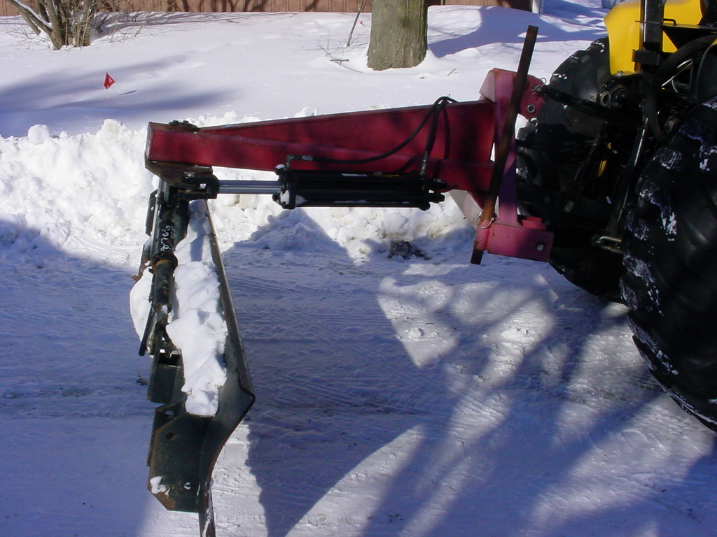

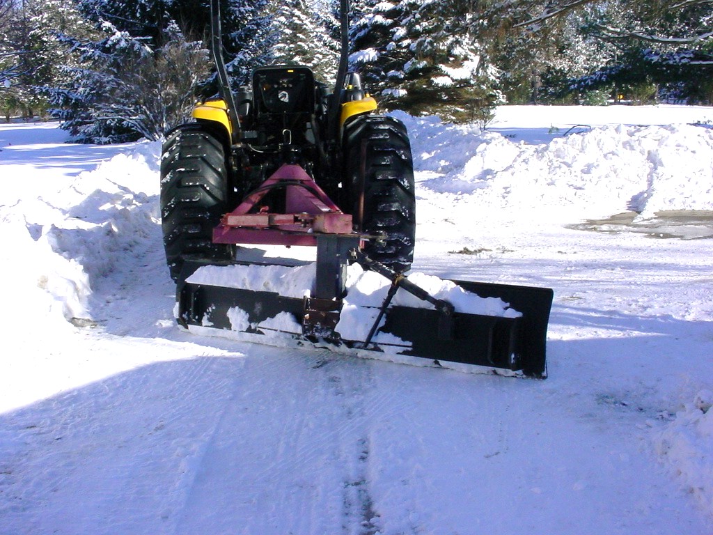

I take my backhoe off / on all the time as needed. I use the rear hydraulics for top n tilt on my box blade or my rake. I also use the rear hydraulics to angle my back blade that I use for snow. I do run a 25a flail mower on my 110
