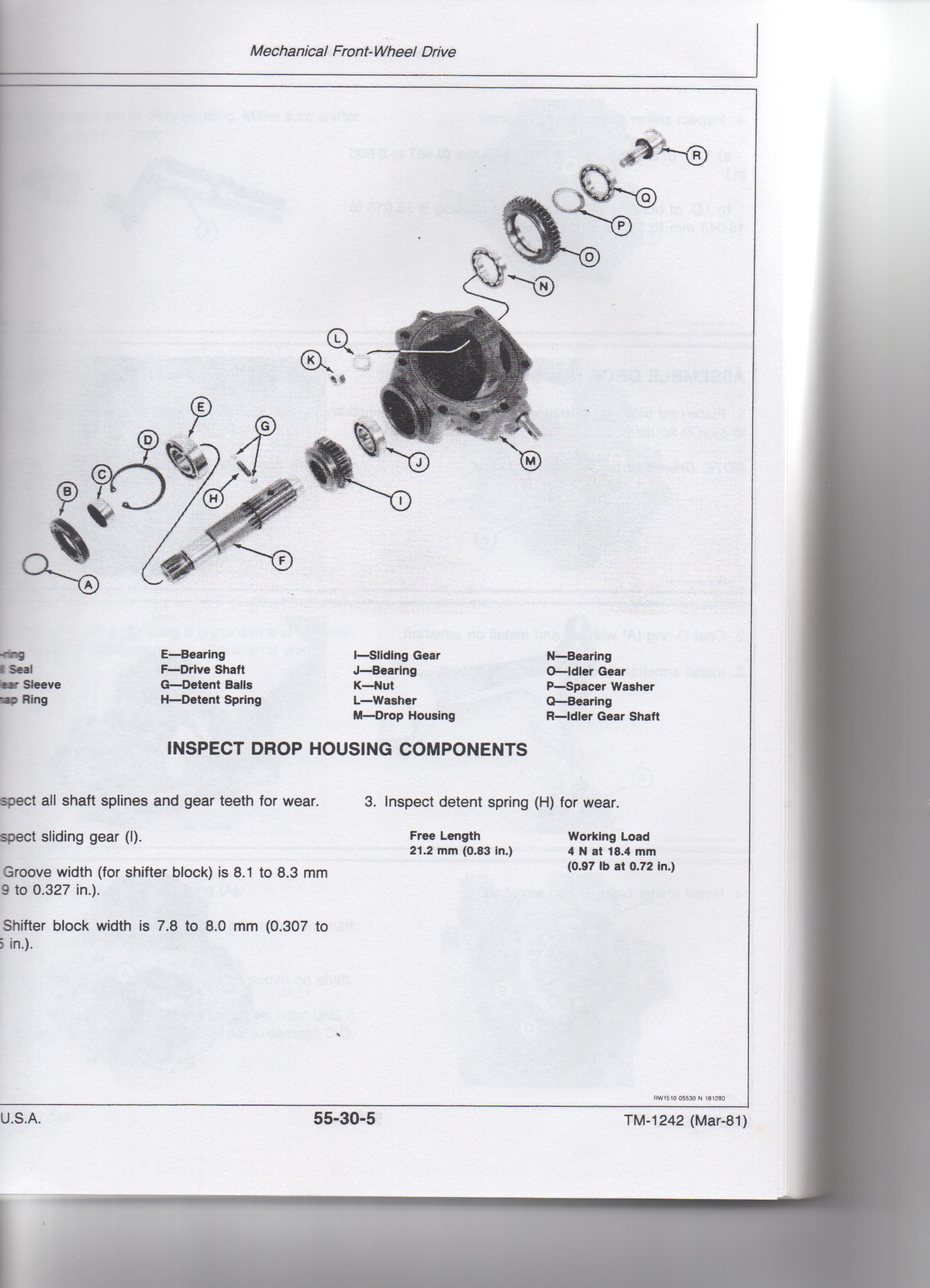

I am assuming the 1050 is not far away in design as it relates to the 750 as far as fwd housings. I have these little protrusions they call "ears" on mine that have to be straightened but that's if you are taking off the outer drive. Unless a clip was forgotten or some other part and something is stopping the idler gear from turning, I do not know what else could be holding it up other than friction at this point
