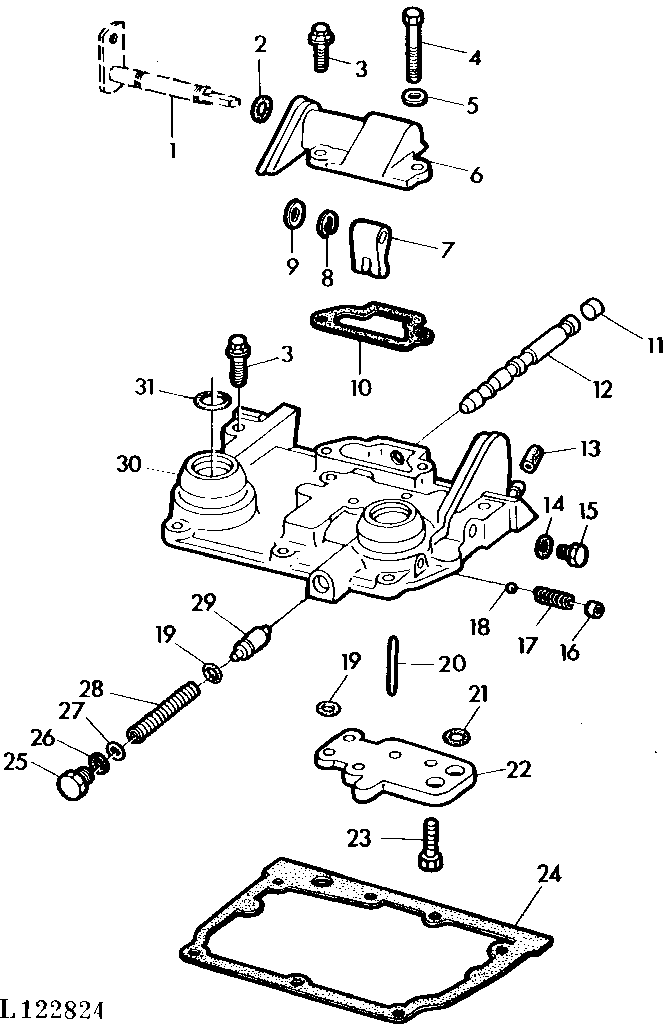

OK here's a parts photo of the filter relief valve(parts key #10-12) now you PLEASE post a photo of the divert valve you refer to?? Are you referring to the priority(pressure control)valve as the divert valve????

L122824________UN26OCT95.gifThe transmission pressure regulating valve is located in the shift cover housing. Check items #25 - 29. Shims are used at #27 to adjust the pressure. This valve is only used when you have an independent pto or hi-lo. A reverser has a regulating valve in the reverser control valve. If there is no hi-lo, independent pto, or reverser, There is no need for this valve since the trans pump only needs to produce enough pressure in the trans to lubricate.

IIRC the regulating valve isn't the "divert valve" that b&d referred to. The valve you referred to is only to supply correct pressure to the hyd options you mentioned but really has nothing to do with supply of oil to frt pump.

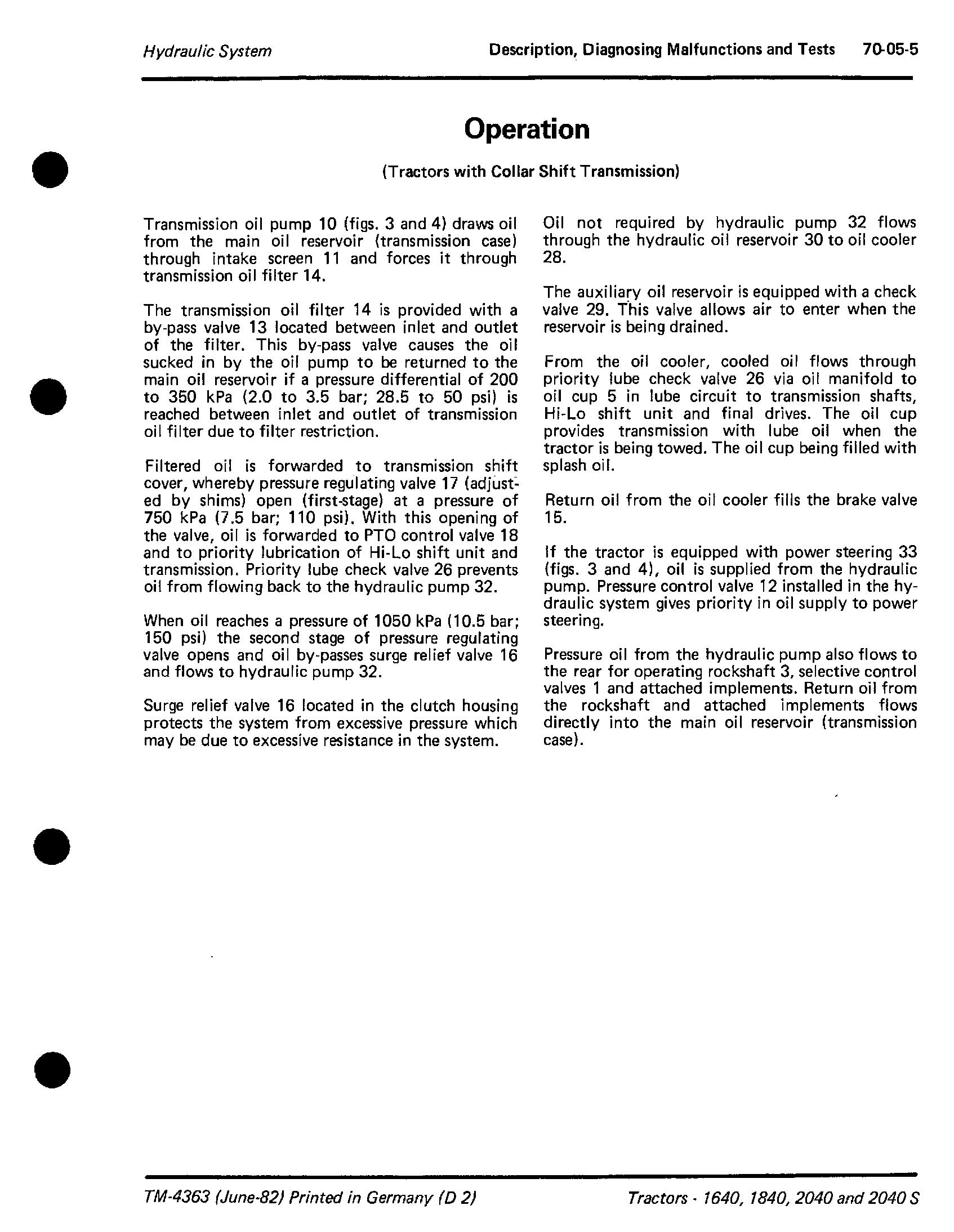

Hope this helps, not your tractor but similar
