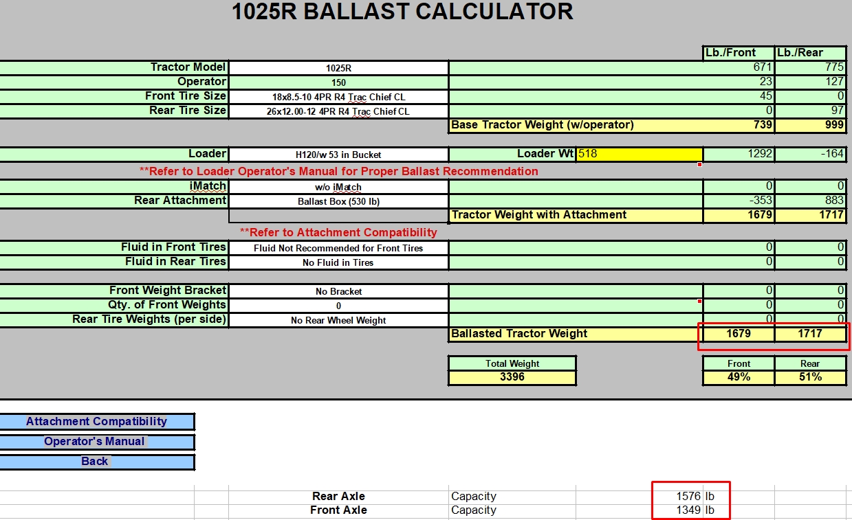

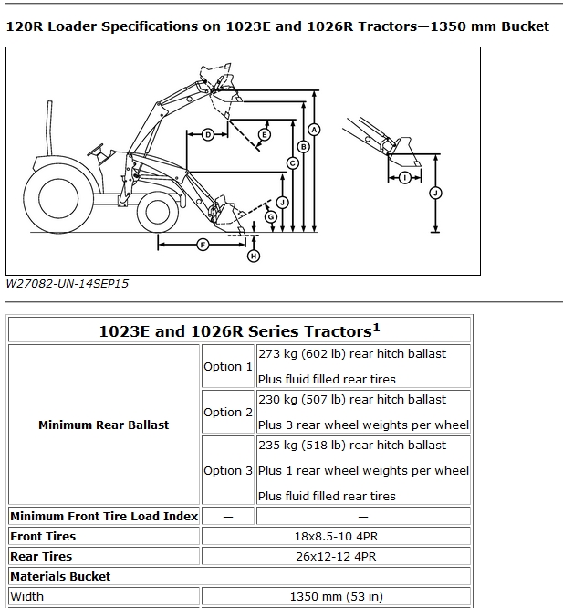

I know ballast has been discussed in the past and I have been looking at several different forums and discussions about tractor ballast. I found a ballast calculator that someone created for the 1025R, and what I am confused about is that when I put in the recommended ballast and bucket lifting capacity at the max load of 518 lbs at 500mm forward of pivot pin (in 120R Manual), the calculations show you are over both front and rear axle capacity (continuous) based on Owners manual spec for load lift capacity and ballast recommendations. The front axle is over about 330lbs, see charts below. I do not understand why the manual provides a listed bucket capacity and ballast that would be over the rated axle capacity. Does anyone know what is the maximum axle capacity of the 1025R because the manual show the continuous axle capacity and not max?

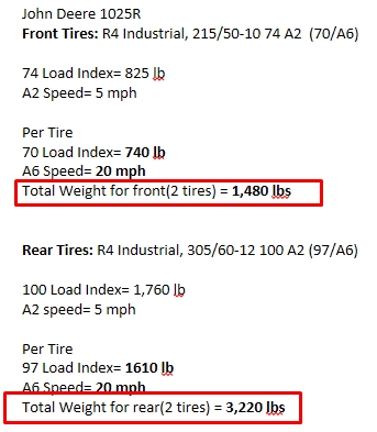

Is the axle capacity listed in the manual for 2 front or rear wheels (so 1 axle) or is the axle capacity for each individual wheel. I am trying to determine if the axle or the tires are the limiting factoring in the amount of weight that can be lifted.
When looking at the tire load index / Speed it seems that the tires can hold more weight than the tractor axle can hold assuming axle capacity is for 2 wheels. So it seems like the limiting factor is the tractor axle capacity. I am been looking at the Heavy Hitch or Omni Transformer for rear ballast and trying to determine how much ballast I need to see if I need the Heavy Hitch Dual bracket and also using 70lb suitcase weights. 8 weights * 70lbs = 560lbs which is in the ballpark of the recommended ballast according to the manual but I might need more weight, meaning a dual bracket or weights mounted on hitch. I have been watching many 1025R videos from Tractor Time With Tim and I have seen many videos that he seems to use more than (8) 70lbs weights for ballast.
See attached pictures of spec of load and tires, and excel ballast calculation.
In the end I want to correctly ballast my tractor so I can operate the front end loader safety, and also not damage or stress the axles or tires.
Any help or advice would be greatly appreciated.
