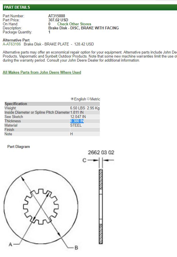

So I tore the brakes apart, long story short the packing is bad in the left side rear brake pressure plate. I have another question, the actual brake disc is steel, with a brake lining on one side, I was wondering if there is supposed to be brake lining on both sides? The one side is bare metal. (so metal on metal when you hit the brakes)
   / john deere 1020 brake problems #4
Post a pic of the parts you are referring to in your post.
Also the part no's of the parts you refer to, will help. You found those in jdparts, right?
   / john deere 1020 brake problems #5
There should be no metal to metal contact on the brake disc's. Brake lining thickness should be 0.380 IN
