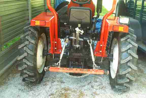

Lastly, can the front and rear tires be reversed for a wider stance?

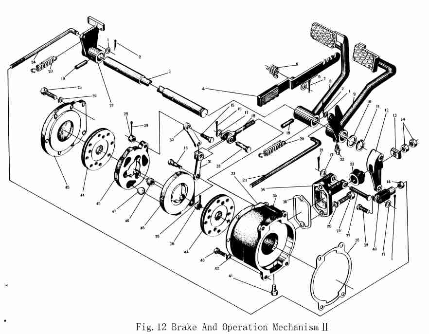

The brake are disks, two per side, and look more like small clutch plates than automotive disk or shoes. They are about 6" in diameter. Put your email in profile, and will send you a diagram (1 meg) of brake mechanism.

Both front and back wheels can be reversed. I was sent an email from someone in West Virginia who turned the rear wheels around (requires reversing inner wheels) and the wheel weights are on the inside now. It will put some additional stresses on hubs, bearings, and seals.

Just received some photos of the wheels reversed. Here is one:

One thought on reverseing your rear wheels,my 254 is about56" wide at the back,a 5 ft. brush hog is of course 60",so it works out good,my 6 ft blade,when angled,also covers this,my tires are not reversed.Plus I can't believe it would really make that much difference,the only reason I could think to reverse them would be to make it more stable when running on the side of a hill?If that little bit of extra stability would keep you from going over sideways,than you are in a pretty dangerous situation . RICHARD GAUTHIER

I've got a 284, and it runs great. mine does POP out of gear when doing HEAVY pushing in REVERS but does not do it in forwards, not sure if it is out of adjustment a bit or not... I've never checked it out that far. I've got some pretty steep hills and creek bottom and I have my Front wheels reversed but my backs are normal. This puts the fornt and back wheels in-line and helps. I've done my share of backing up hill tearing out bushes ect, (lots of wild rose/multifloral rose stuff) and it hasn't let me down for stopping at top to shift. though usually I've got box blade or FEL down into dirt too. I've not had a problem stopping with the brakes and usually can slowly slide down hill with brakes on and out of gear. If I am in creeper gear it will over whine the trans though if not carefull!!!

Here is a compressed version of the brake diagram. Loss of some details. This shows only one side.
