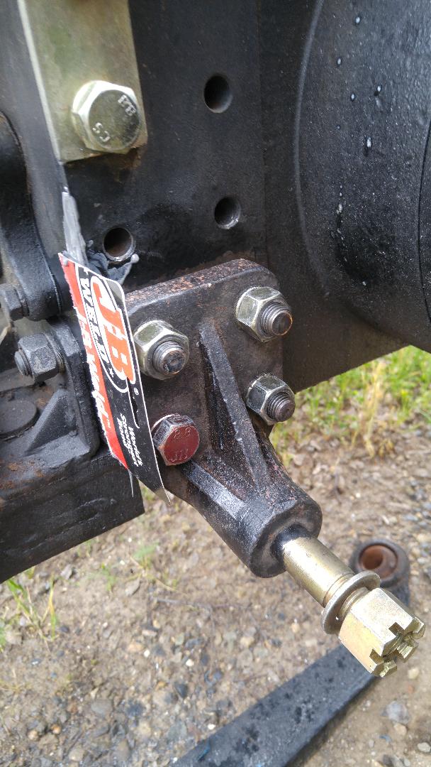

used tractor for loading trash into truck on saturday started fine three or four times then nothing shorted across leads at starter fired right up. always starts easy first turn and will always start even when I have to do it at starter. made this post when tractor had sat for little over a month when we were getting rain. and starter would not even spin which turned out to be battery is finally getting tired so first order of business is new heavy duty battery then will replace starter switch. Has been a good tractor only other problem was caused by some loose bolts which cause the mount for the right lift arm to break out of housing. had to drill out and put thread inserts in, put lock tight on everything and check all bolts more often. angus repair.jpg
/ Jinma starting
#11
The cardboard was to hold a little devcon in place untill it hardened, also had to use a metric bolt in one of the holes as I couldn't find the right length metric stud even from dealer.
