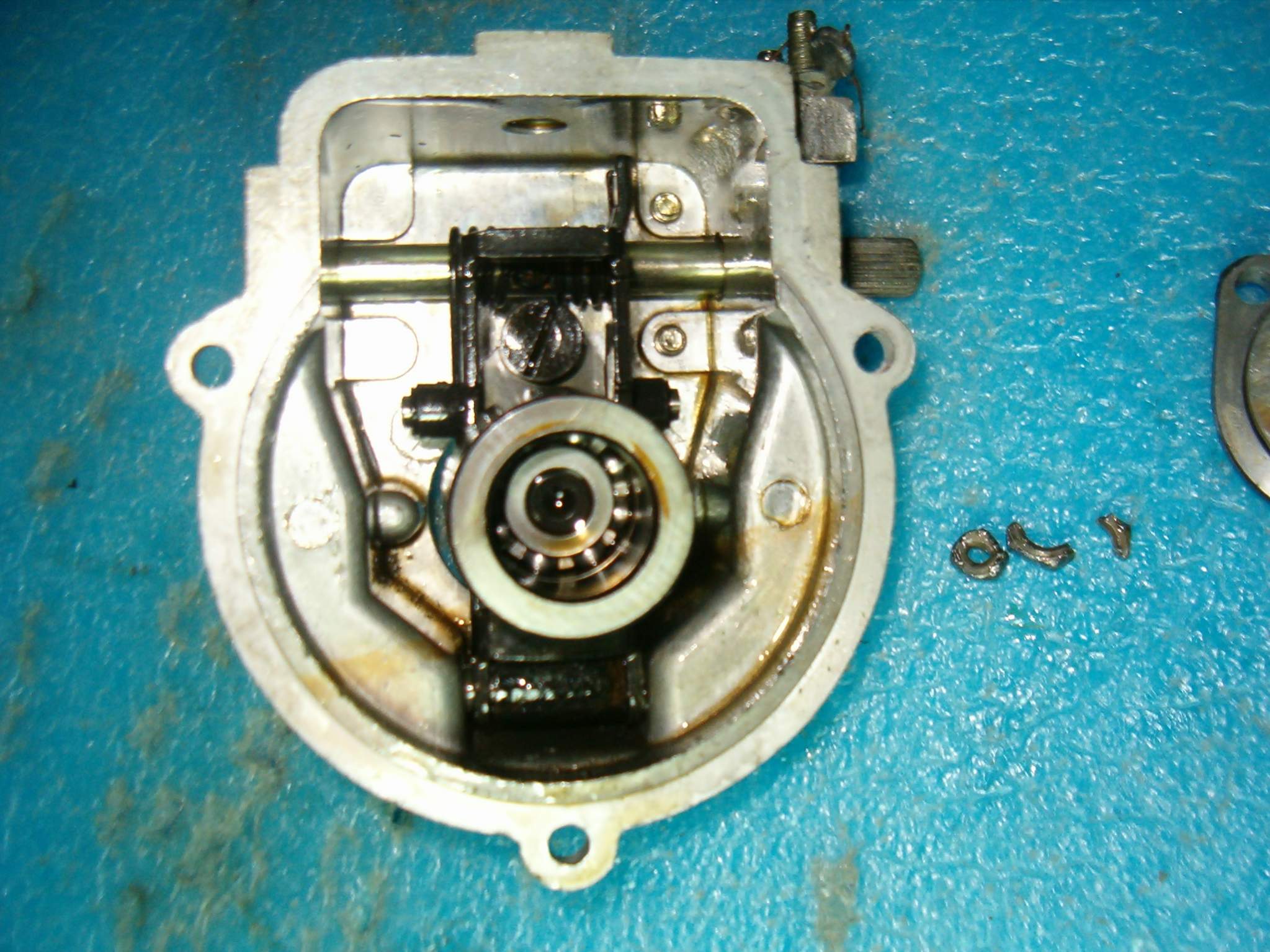

Hi,
I got Jinma 254 and the RPM get stuck. I rev it to 1500 to move and the it won't go down anymore. I stop and Restart the tractor, still 1500.
I check the linkage is free. Then I when higher 1900, no it stuck at 1900?

If the lack of response you're describing is when using the hand throttle or foot throttle, I suggest you take another look at the linkage before considering any pump repair/replacement. The linkage is a little more complicated than is really necessary. And as a result can hang or stick when not installed or adjusted correctly.
Now if you disconnect the linkage altogether - and have the same problem when trying to increase/decrease engine speed right at the pump - then you're likely looking at a governor issue.

I check the linkage and the lever on the pump is at the beginning position so it is not the linkage

Try increasing the RPM at the injector pump. If when you release the RPMs fall to normal you eliminated the linkage as the problem. Richard
/ Jinma RPM STUCK
Well I open the pump and found some broken part and those piece were behind the plunger

If you can figure out where they came from maybe one of the dealers has a junk one laying around they can steal the parts from so you can fix yours. If not you will need a new pump.
Just curious, how did the oil look and when was the last time it was changed????

/ Jinma RPM STUCK
#15
Yes the oil in the pump is independent from the engine but the same kind
I change the pump and all my problem I solve.
There is actually a circle on the pump teeth and 2 circle on the engine gear.
The circle have to be in between the 2 others.
