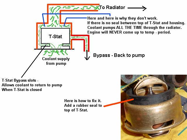

Ok, I have read many if not all the posts here and elsewhere about Jinma thermostats and various attempts to fix it….Some have installed higher temp t-stats and ….. Same problem, engine will not come up to operating temperature, some say that the radiator is “Too Big” for the size tractor etc. etc. etc…
Please carefully see and read the attachments to find out why they don’t work and how to really fix the problem once and for all period - it’s actually very simple…..
I must also say the Jinma thermostat in itself functions properly – it’s the housing that it is enclosed in that is the issue - again there is a very simple explanation and fix.

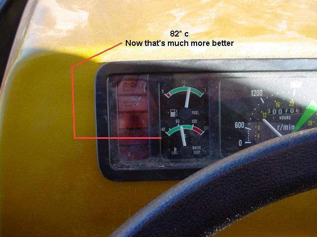

My Tractor: 2005 Jinma 354LE, Engine: Y395 E-3 (EPA)

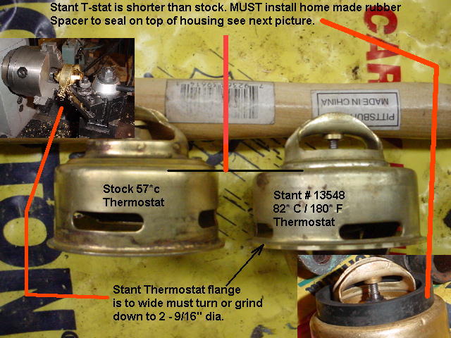

The stock T-stat: 57* c (134.6* f)
I want it to warm up faster and run hotter
Purchased Stant brand T-Stat # 13548 which is 82* C (180* F)

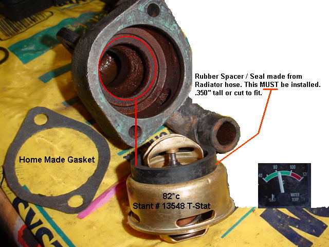

You could, if you so desire use the stock T-Stat with the addition of a large o-ring on top of the T-Stat to seal the gap between the top of the T-Stat and housing that it is enclosed in.

A picture is worth 1024 words.

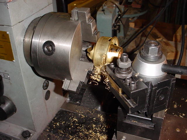

I used my lathe to turn down the Stant T-Stat flange to 2 – 9/16”.
The lathe was purchased with the money I saved by buying a Jinma.
You could also carefully grind it down.

Some details of the assembly.

After about 15 minutes (ambient temp 15* F) my Jinma has that “Warm and Fuzzy” feeling. /forums/images/graemlins/grin.gif

I vote with your wife; this is not new information. Similar to the many reported cases of the wrong size system fuse, several folks have reported discovering the wrong thermostat in their Chinese tractor. I recall at least two mentioning the 57C variant. Your 354 should have been delivered with an 80C thermostat installed in the first place.
Point in fact; stock Chevy trucks typically come with a 195F thermostat. Aftermarket performance chips generally require changing DOWN to a 160F thermostat, extreme cases drop to a 140F. Simplified conclusion is that an EPA engine should typically run hotter than one (re)tuned for performance. Hence; the wrong thermostat was installed in your tractor in the first place.

Mine too, but not unusually so - since diesels are slow to rise to operating temperatures anyway. Slower than their gasoline counterparts anyway. Plus, the colder the ambient air temperature (and the lighter the work load), the slower a diesel will be to achieve optimum operating temp.
Some owners have also reported finding the wrong diameter thermostat installed, to the point where it flops around in the housing. One fella even found his thermostat setting at a 90 degree angle; so loose that the coolant flipped it perpendicular to the flow. Some found no gasket. In both cases - when the thermostat is not given an opportunity to STOP the flow - the coolant will simply not heat properly.
