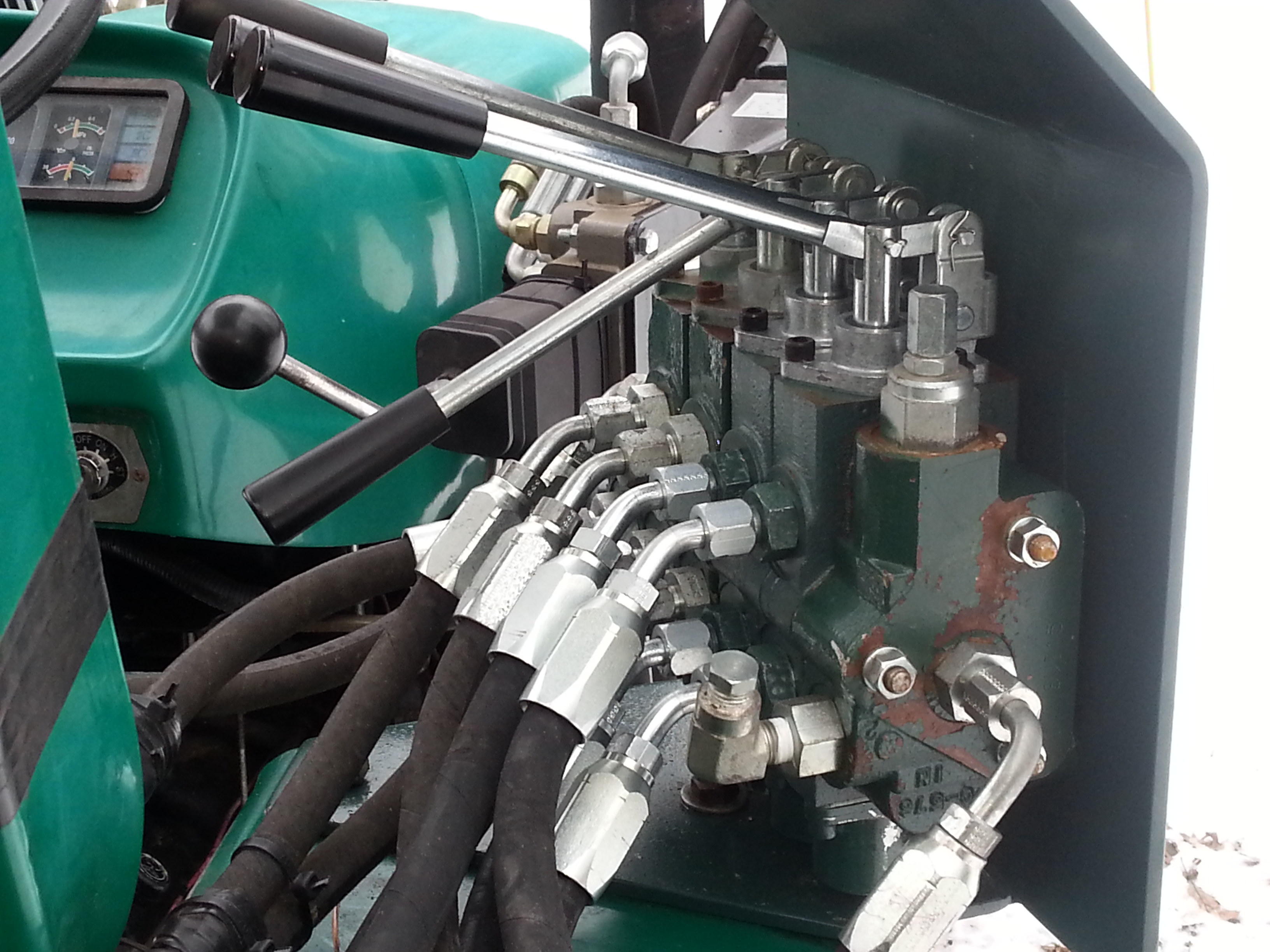

You can make your own lines and end up with something like this. When done, it's really handy.
I used them for log splitter, 3PH snow blower, and angling front snow plow.

Smalljobs, that is a great valve set-up you have there I made a similar one for a Bobcat years ago to run a cold milling machine for asphalt
As I have gotten older (68) just don't use equipment near as much to justify added expense (Just 11 hrs on this FarmPro this year)
