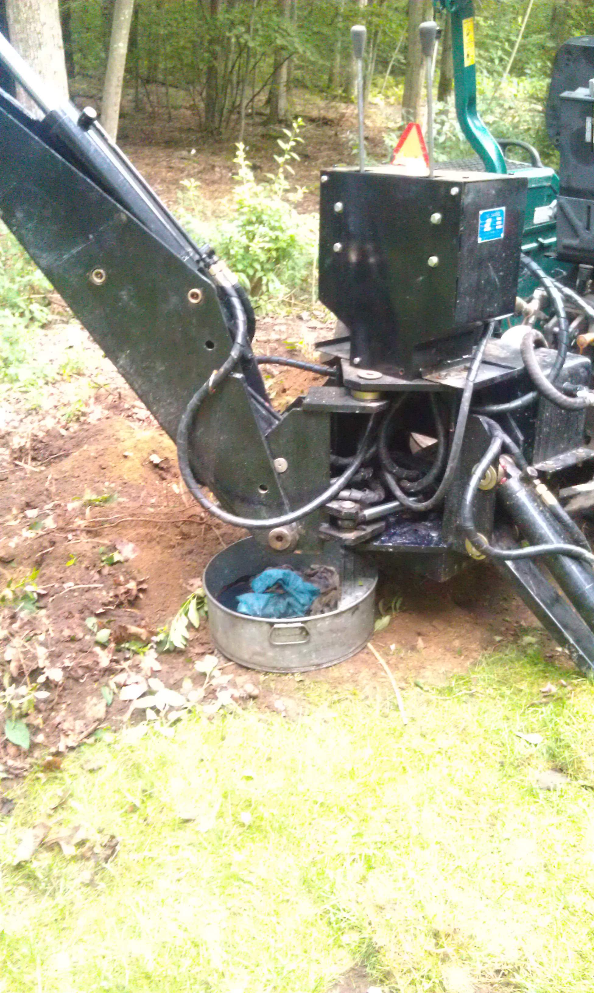

I'm having a problem with one of the swing cylinders leaking oil. I haven't removed it yet but it squirts momentarily right out the side near the thick midsection where it's mounted. I'm wondering if there's a vent hole there and I seeing oil that made it past the piston seal. I can watch the boom swing and at just one point the oil squirts out and then it stops. I don't recall if it's when the cylinder is extending or retracting. It's hard to see and I don't want to put my head in there with boom swinging.

Sounds like you have a piston seal leaking
   / Jinma Backhoe Swing Cylinder Leaking
Ron - Thanks. I suspected this was the problem. When I imported the BH, I also ordered two extra repair kits for every cylinder!

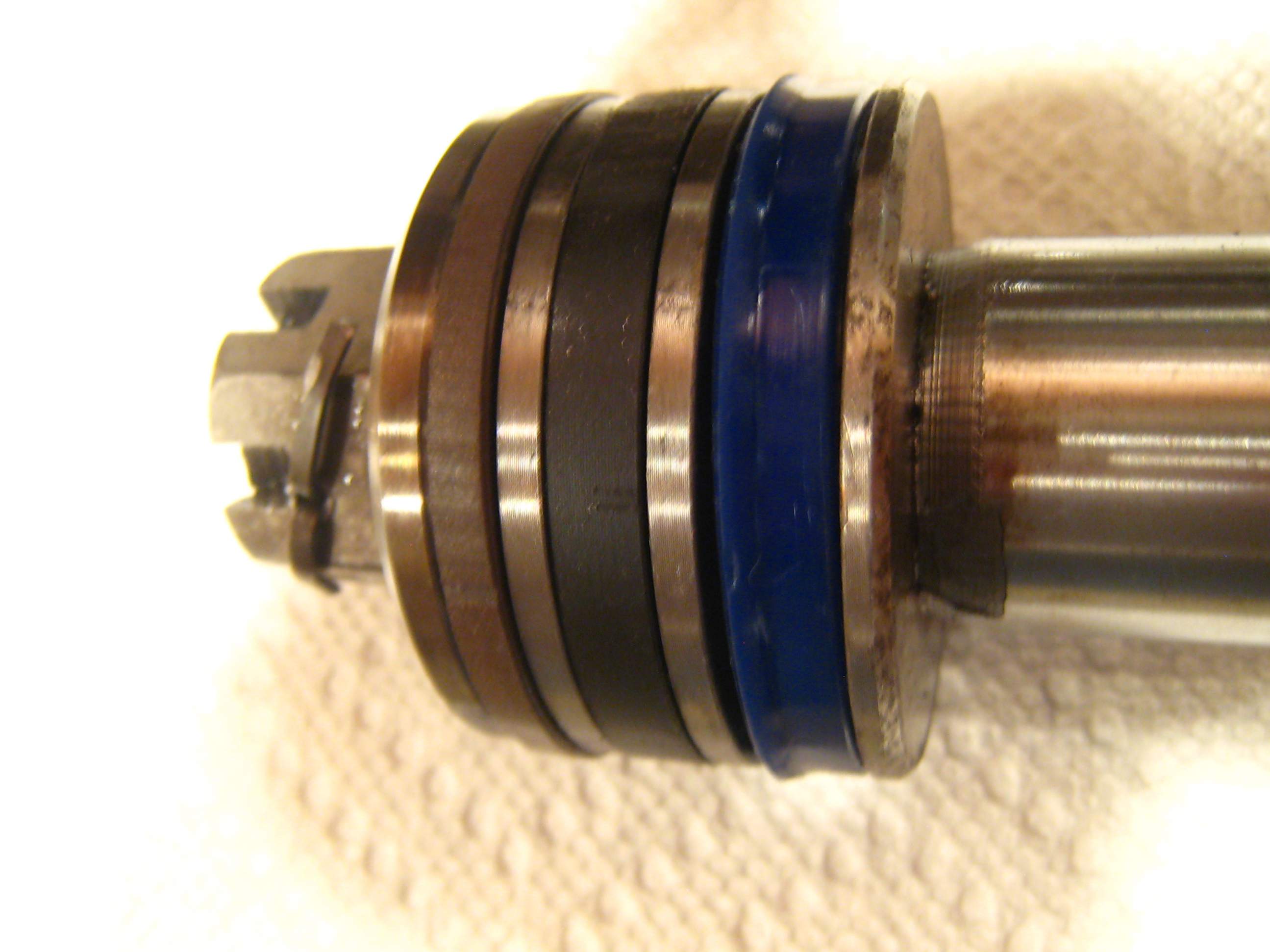

I have the cylinder out and found the threaded gland retainer was finger tight. With the threaded retainer fully withdrawn I cannot seem to pull the rod out of the cylinder. It's almost there but seems to be hung up in the threaded area. Should I reconnect it to the hydraulic hose and use hydraulic pressure (and a bath) to push it out?
I finally got the rod and piston out by pulling harder. Now, what's the best way to replace all these parts. I have factory repair kits.
   / Jinma Backhoe Swing Cylinder Leaking #9
Clean, polish, clean, deburr, clean, lubricate, clean, carefully reassemble with clean bench and tools, clean and test
   / Jinma Backhoe Swing Cylinder Leaking #10
Oh, don't scar the piston head under the seals with pointy sharp tools......:banghead:
