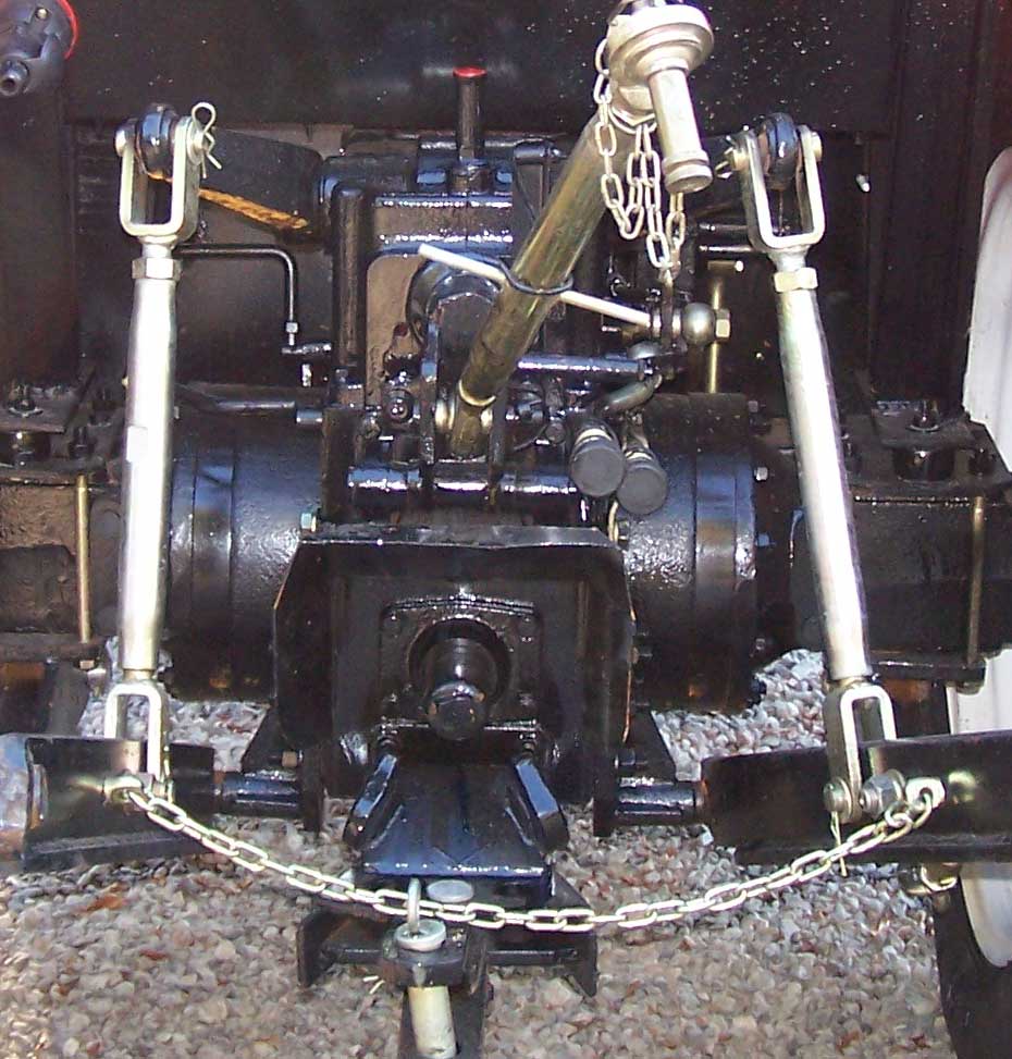

The quick connects
One goes directly to the case the other one disapperas behind the case (difficult to tell for sure).

I'm guessin' here - so bear with me. After looking at your photo, there's a chance you've got a latter-day variation of the dump trailer remote that Rob described.
Originally, some smaller Chinese tractors only had one remote fitting; hydraulic pressure provided lift, gravity forced return. It was controlled by the TPH lift lever too, but a hex head bolt on the side of the sump (connected to an internal valve) had to be turned to make it work. It would divert fluid from the lift arms to the remote fitting. Lift arm up, hydraulic pressure moved fluid out the remote. Lift arm down, gravity pushed fluid back into the sump. Only problem, this temporarily disables the TPH. It's one or the other, never both at the same time.
What you MAY have could be the same concept - except now with a dedicated return line. Look on the side of the sump for a hex head bolt that looks outa place from the rest. If your TPH works fine, that valve should be all the way in one direction. Turn it as far as it will go in the opposite direction (usually 1 turn or less) to divert flow to the remote(s). Turn it back to the original position to resume TPH operation.
//greg//

From the looks of your photo with those hard lines, I think those are half remotes with a dump line. One line is pressurized and the other is for dump back to tank (I think). Some Chinese tractors have a hex to turn and some use a knob under the seat on the hydraulic box to activate those half remotes.
On my KAMA tractor, it is exactly like Greg said.
I took my tractor apart for you so you could see exactly what Greg was describing. (not really:))
Shown here is what my 1/2 remote looks like capped off without the QD on it. And also the hex to activate the rear remote. Look for that on your hydraulic box. I'm still hoping Jim or Scott can post a photo of their 554 rear remote valves. I know they have true rear remotes, and they are different than your photo.

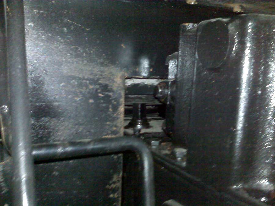

I did find the speed adjustment for the hydraulics/
And one hex bolt that looked like it was it - but it just kept coming out but didn't divert the flow - I wasn't sure how far was too far - I thought the diverter bolt would not actually come out but rather just spin... Does it actually come out or should it just spin? I can keep turning it but didn't want to before asking if it should come out.....

Here is a picture of the bolt in question
It is located towards the front

Finally found it it - it was in another post - The trick was the 3ph lever position....
RonMar wrote:
From what I have gathered studying my system, rear hydraulics seem to have been a afterthought on the Jinma. The pressure supplied to that rear pressure quick connect is the same pressure supplied from the 3point hitch hydraulic control valve to the 3PH lift cylinder. The only difference is the pressure going/comming from the 3PH cylinder goes through the lowering speed regulating valve located in front of the seat. In order to apply pressure to that quick connect, you must have the 3PH control in the "Raise" position. To keep the 3PH cylinder from raising the arms at the same time and the control linkage that is attached to the right arm from bumping the 3ph control lever back to "neutral" when the arms reach the top, you must fully close the 3PH speed/rate control knob in front of the seat(turn fully clockwise, be sure and loosen the locking setscrew first). This will prevent fluid from being sent to the 3PH cylinder and the arms will not try and raise. With the control knob screwed closed, all the pressure/flow will be sent to that rear female quick connect fitting.
