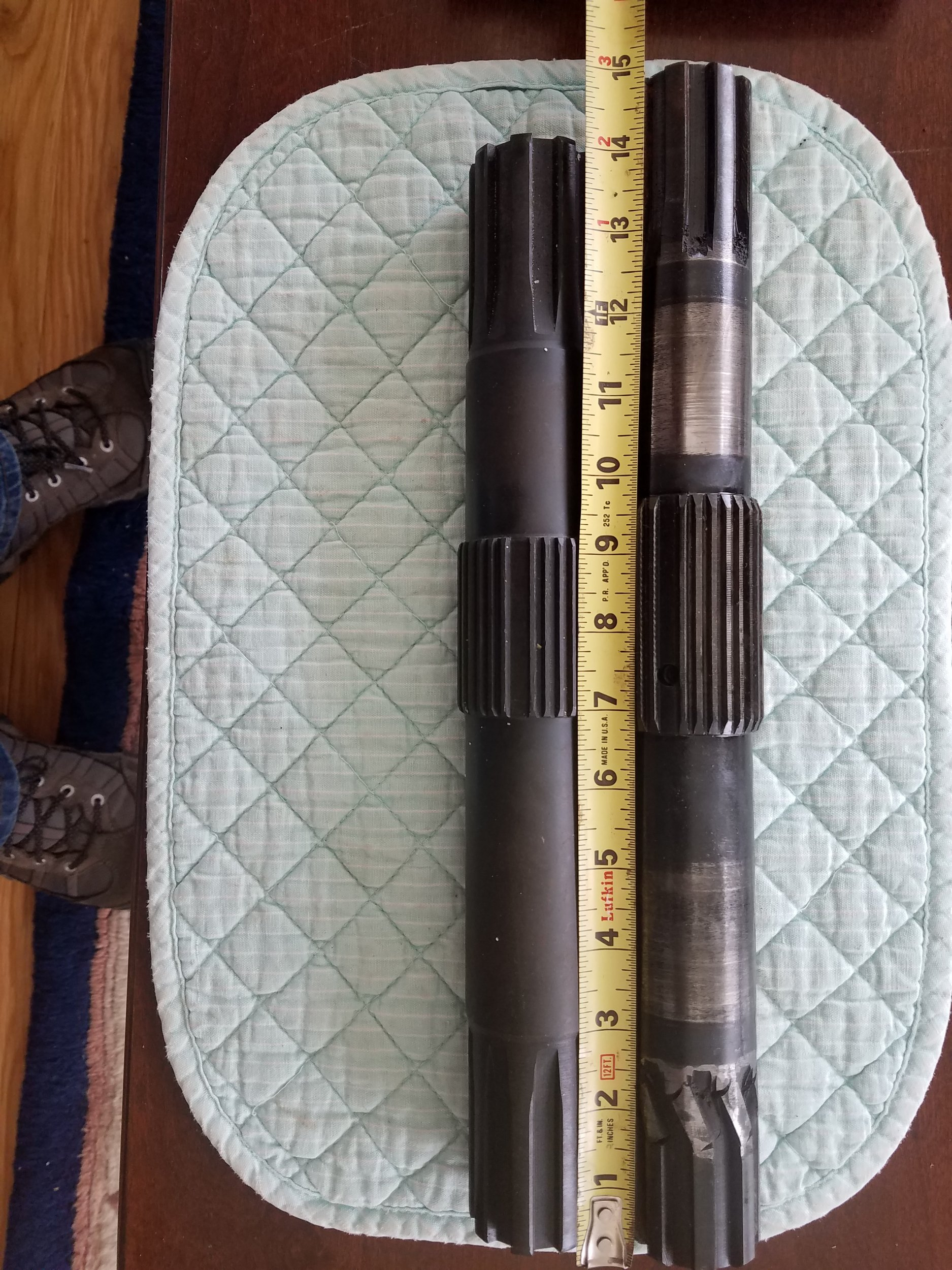

Jinma 3pt lift shaft (15" not the 14") Having no luck in a new one. Mine is so twisted. Any suggestions??

Part# 160.55.103 I'm told this # applies to both shafts. I've checked with Affordable and Keno.
   / Jinma 3pt lift shaft (15" not the 14") Having no luck in a new one. Mine is so twisted. Any suggestions?? #4
Where did you get the new one from? That dealer should be working to get the correct part. Even if that is the part provided to them with the correct part number, it obviously is not correct. This is not to blame the dealer, but it is their responsibility to get you the correct part, even if it was a mistake farther up the supply chain. Having sat at the parts counter handing a customer a part that has the right number but is not correct is embarrassing. However, I have a lot of sympathy for the dealer in a situation like this as there is likely not much they can do but order it again and try to get a return authorization for the bad part. This happens to domestic tractor dealers too, but it is more difficult when dealing overseas.
This leaves you with the option of waiting for your dealer or start calling around and having dealers with stock pull the part and measure it before shipping. If you can't find one on the shelf then about the only other option is to have one made by a machine shop. It is not a terribly complicated part but will take quite a bit of labor to create so expect to pay accordingly. You might find a shop that would be willing to cut off the twisted end and make just that part and weld it back on. It is likely the shaft is stronger than mild steel that may need a heat treat when done. Other than the splines, it is not a high precision part so that should make it easier.
Good luck and keep us updated on what you find.

This is a fairly simple shaft to have machined if other sources can not provide. Just a guess at cost is about $25 for material (assuming 24 inches of 1 5/8 1018 round bar). 3 hours shop time at $110/hr. So between $350 - $400 at a local shop.

We have the correct one in stock ? Not sure where the 14" one came from but all of ours are 15". Give us a call we will be glad to take care of you and any other parts needs you may have

I'll speculate that the 14" part is for a smaller tractor, which could also bear the same part number. This is why you want to give the dealer/parts supplier the most complete and accurate information as possible. Nothing beats a clear pic of name tags. Suggest you return the 14" part for a refund and get the one from Tommy.
I find it curious how only one side is twisted. May I ask what was going on when it became twisted?
