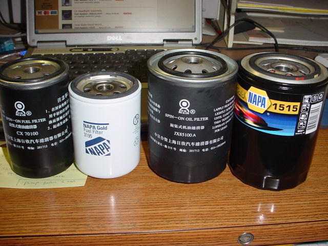

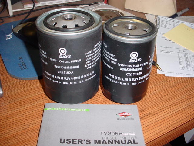

Does anyone have Filter cross reference for.
1. Engine Oil filter OEM # JX85100A
(New 2005 JiangDong EPA TY395E series 3 engine)
And
2. Fuel Filter Chinese# CX70100
I went to autozone and opened up about 15 boxes of Fram type filters (with permission) and none are close. The screw on hole size seems correct the real problem is that the top of the OEM filter is in an upward "dome" all the Fram filters were "dished" inward.
If anyone has crossed these filters (one or both) Please Post Below.
Thank you

I can't remember where I got this? [Forum]
OIL FILTER
Chinese # JX85100A
NAPA 1515
WIX 51515
FUEL FILTER
Chinese # CX70100
NAPA 3195
WIX 33195
M16 1.5 THREAD PITCH
Let me know if it correct INFO.
Ronald
   / Jinma 354LE (2005) EPA Filter cross ?'s #3
Re: Jinma 354LE (2005) EPA Filter cross ?\'s
ON the oil filter you can thread out the nipple to meet the concave top of the NAPA filter. Fuel filter may be an issue though. My TS354Xs came with a spare, I'll have to see if a 3195 will match up.

I went out and purchased the Napa Filters you indicated.
The fuel filter is just a little shorter than the OEM, However it fits just fine, no leaks and the tractor runs great.
Looks like the Oil filter will fit as well - I have not installed it yet.
I will install the oil filter soon and will use Bluechip's suggestion if I have any troule with the threaded nipple length although it looks like it will work no problem.
I have attached a side by side comparison of the Chinese OEM filters with the NAPA filters.
Thank you all !
