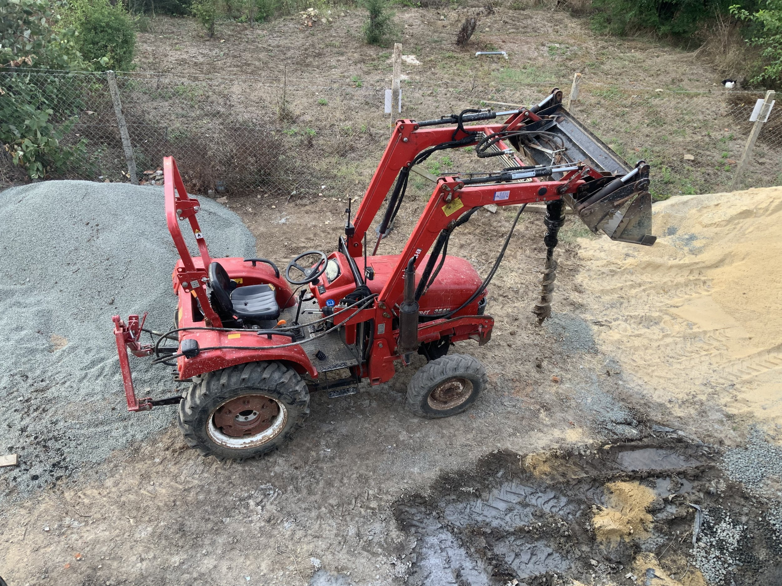

- Tractor
- Siromer 354
My hydraulics work fine but are not enough, looks like I have a 14cc pump, the Backhoe has no real power , the FEL is fine but slow, but the the final straw is the Auger I needed a minimum of 15 and ideally 45 LPM to run it ,it’s never gonna run the auger , coupled with the orfs fittings. And busting a ram , change is needed.

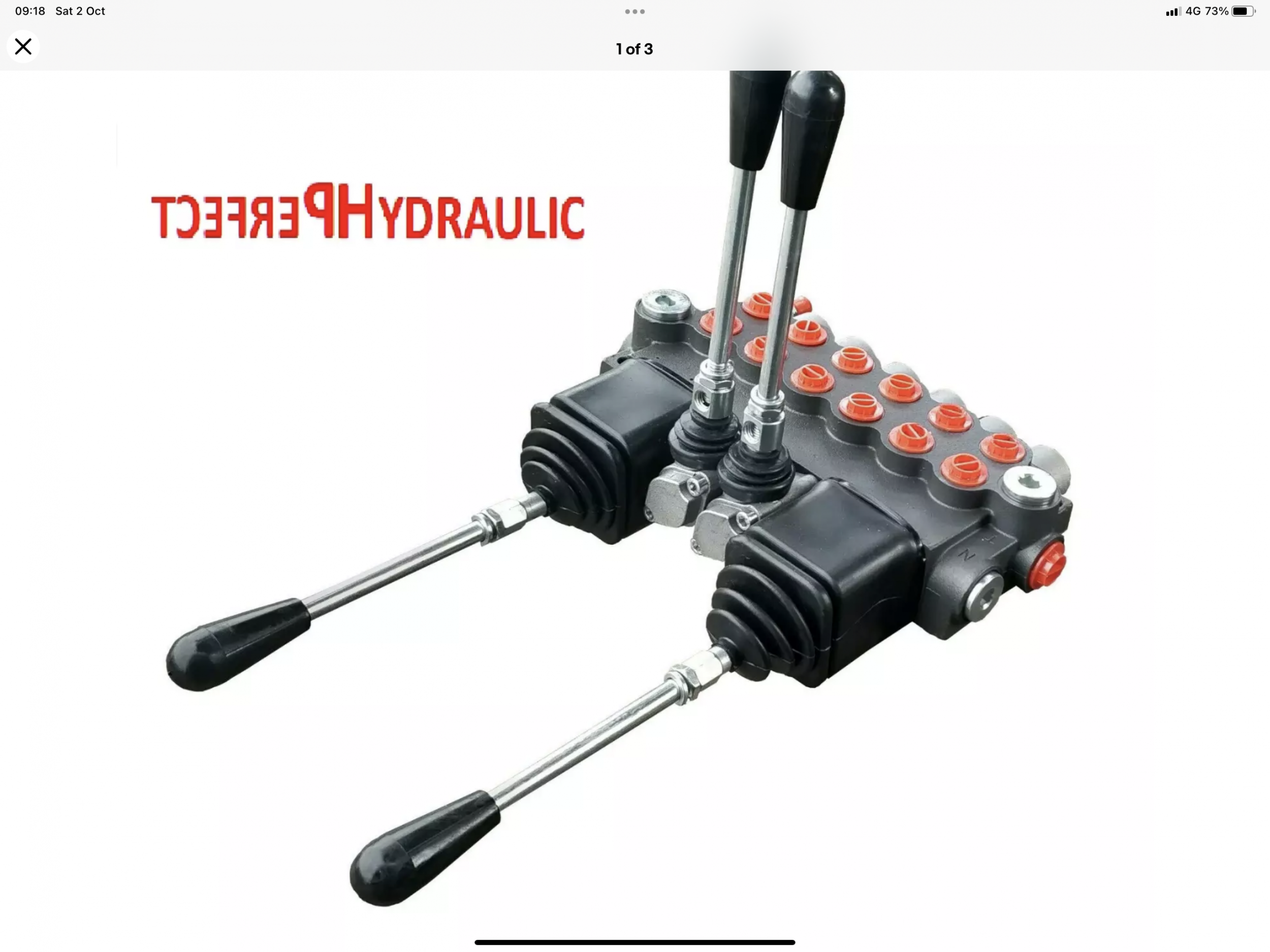

I ve now got a 75 litre tank with return filter , temperature gauge etc, A pto pump. 51 LPM/ MAX 240 BAR, and a new valve block. Upto 80 LPM , just need to get cylinders to shop to have new fitting welded on so I can get new hoses made,
hopefully this will do the job, I will update pictures as with do the swap over in winter
