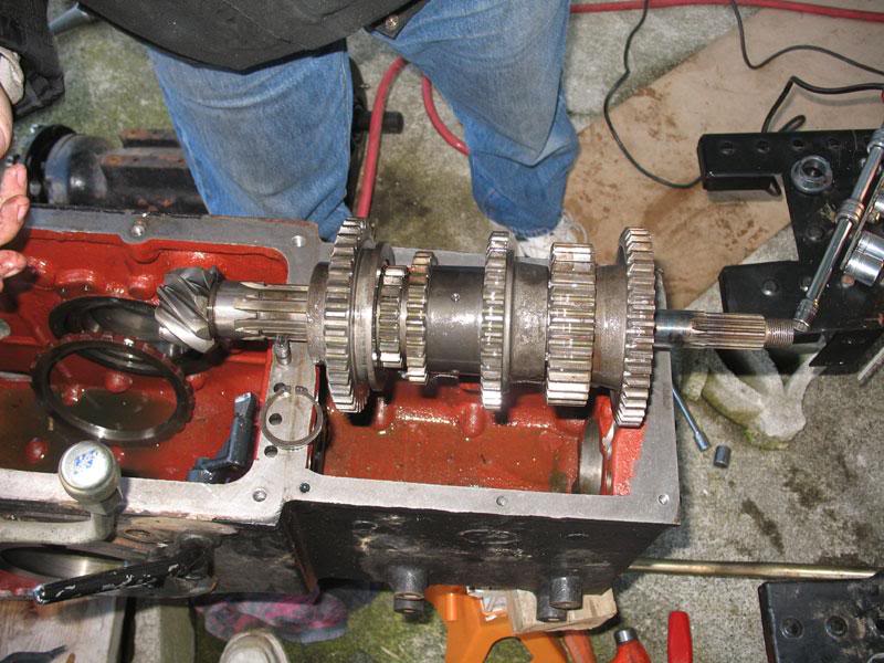

Has anyone replaced gears in Jinma 354 transmission? I've got it broke down to everything but the "Drive Gear Box Main Shaft". Primary is out, but have teeth missing on 2nd gear on Main Shaft. I believe the shaft comes out the rear... Do I need to tear entire rear end down to get that shaft out?? Any help or tricks would be greatly appreciated....

Greg,
I am so sorry that happened :mad: Any idea why the gear is missing teeth? did a shifter fork break and the broken part tore up the gear?
I am almost sure the entire rear end must come completely apart to get all the transmission gears out, and I mean every nut, bolt, gear and shaft of the rear-end, and then the same for the transmission.
A few years back another guy on our Chinese tractor Forum had an issue with his transmission, he took it completely apart and documented the whole thing :thumbsup:. You will have to join the forum to see it (for free) I think it might be worth your effort to join for the pictures and documentation alone. Here is the direct link to the thread I am referring to:

Thank You Gentleman.... I did speak with Tommy, and he forwarded me your pictures and post Larry... and the Chineese forum... All great help
