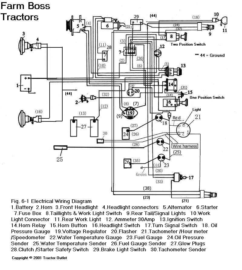

Picked up a 2004 Jinma 2840 with 215 hours, seems to run good, but has some electrical problems. I'm not the smartest bear in the forest, but know some electrical stuff. Before I start throwing parts at the system, I need some advice. It's a strange electrical system.
1) Doesn't start with key/ignition, but does with a screwdriver across the starter solenoid.
I know ignitions are very suspect for these. Read greg_g's suggestion for a Ford Cold-Start ignition. It's on my list. But the existing one checks out with my ohm meter on a bench. Accessories, Glow plugs, and Starter terminals measure 0 ohms when they should.
Reinstalled ignition. Measure 12.8 Vbat at input, but when I turn to Accessories, it drops to 9.x V, and when I try to start, it drops to 0.3 V. The battery terminal itself still measures 12.8V, so there isn't a short. But the ignition Vbat drops.
2) While tractor is idling, ignition OFF, I measure battery voltage at alternator output (12.8V). But when I turn Accessories on, I'm only measuring 200-300 mV. If I rev the engine, then I can get that up to 0.5 - 0.7 V. But in this ignition position, even the Vbat of the ignition is the 200-300 mV.
These are strange to me. Is there some active component between the fuse box and the ignition input? What is changing the battery voltage when the ignition is switched? The battery does not appear to be loaded down. Otherwise, with that much voltage drop, some wires would be smoking.

My response should have been "replace the keyswitch, then see if you get the same test results".
Short of that:
1. bypass the clutch interlock and see if the keyswitch issue persists (jumper at the plastic connector)
2. might consider replacing the voltage regulator. I did that on my KM454. Got a solid state conversion regulator that mounted right on the alternator. I can look it up if you're interested, but I believe it's a Transpo D7024 universal type
3. two wires into a "can" suggests a circuit breaker, one of those self-resetting types.
Voltage goes through the ammeter on the way to the keyswitch. So given you've got 12v at the switch, it sounds like the ammeter movement is shot. Fuel gauge problems are commonly ground related. There are 2 ground wires: one for the gauge, one for the sending unit. Could be either one. That said, sending units have known to become stuck in one position, and gauges have been known to short out. Needs further troubleshooting.

Maybe he can get a schematic for it from one of the Tractor dealers on here. I'm sure they'd be willing to fax him one. It would help a lot to diagnose this one.

Update: I stopped by NAPA and picked up a $15 regulator. I wasn't sure about the connections, but took a good guess (I thought) based on some google searches. Tractor started right up with the ignition. Great! But the alternator wasn't outputing anything, maybe 0.3V again. I shut off and tried to restart with the key again. No go. So I apparently blew the regulator again.
New regulator was for an old ford; has terminals I (ignition), A (armature), S (stator), and F (field). The alternator has terminals labed '+', 'F', and 'I'. The OEM regulator had 3 connections: 1) Chassis connected to the alternator 'I' terminal, 2) To the 'F' terminal, and 3) To the fuse box through a 10A fuse and out to the instrument cluster with 2 white wires (one goes to the rear light, couldn't find the other).
Based on google searches, the OEM connections, and guesses, I connected the regulator 'A' to the fuse box, 'S' to alternator 'F', and 'F' to the alternator 'I'. Like I said, tractor fired up with the ignition, but just once. Apparently this is wrong because it couldn't do it again.
Thoughts? Advice? (I like the GM alternator option, but then I would lose overvoltage protection on the battery and the ammeter for charging current, well, when I get the ammeter fixed anyway)
