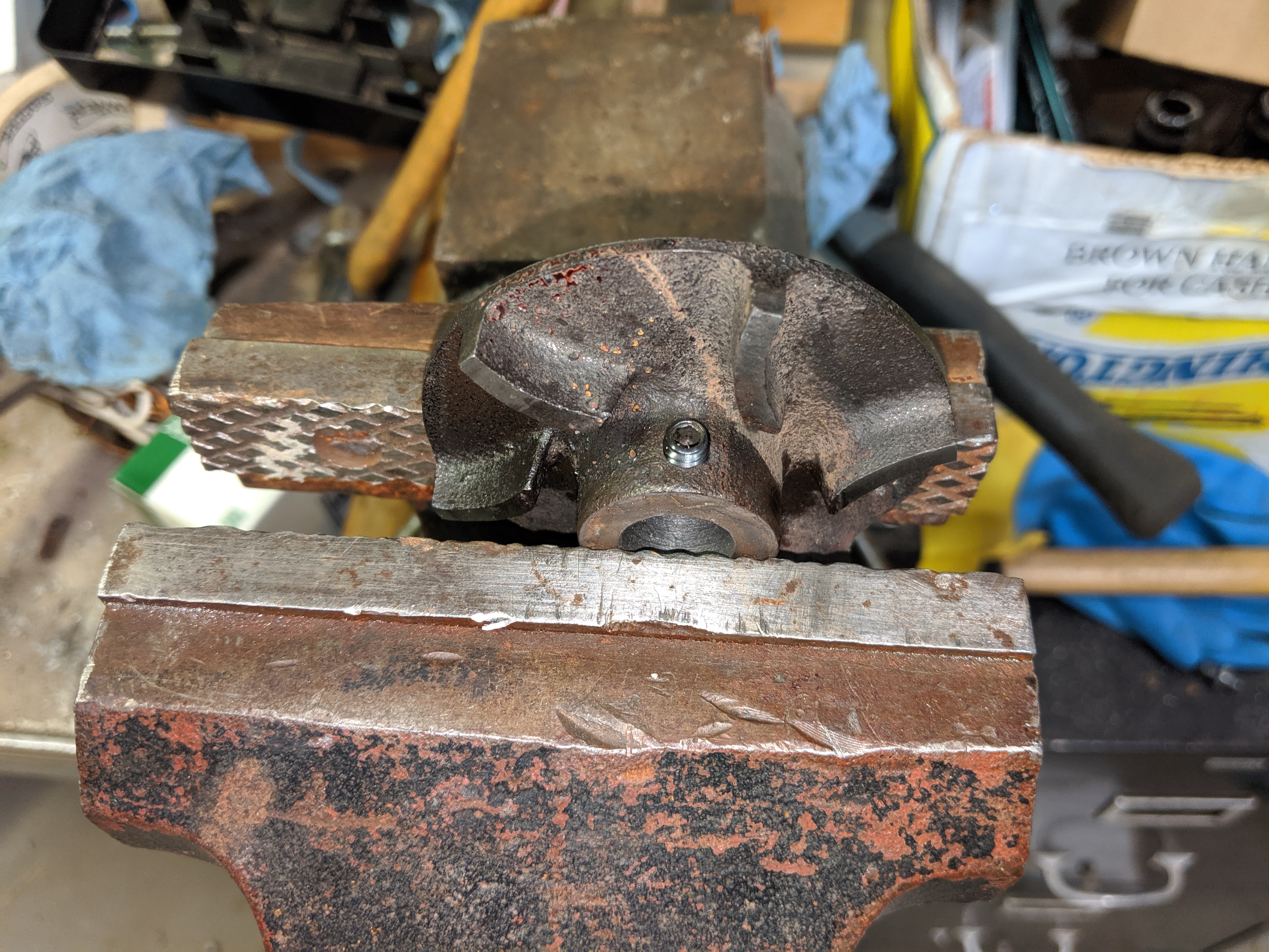

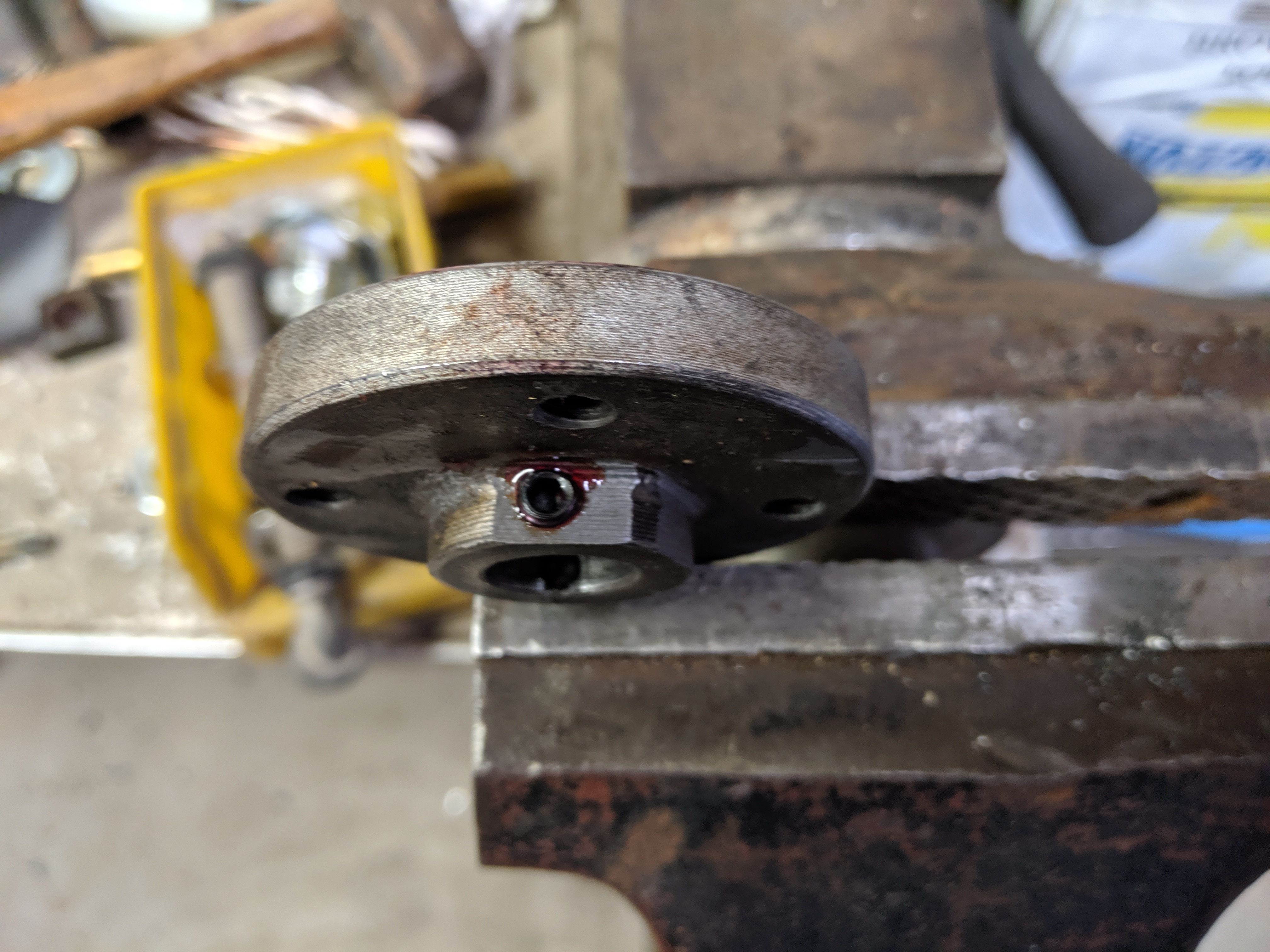

My 2007 Jinma 254 w/TY385 water pump failed due to bad bearings just like qualsite. Using qualsite's excellent suggestion for bearing+seal this was my experience...
- John Deere bearing cost about $30 and fits in housing fine.
- Impeller and fan flange had to be enlarged to 5/8 using regular drill bit. Problem is that the press fit isn't really tight enough. I drilled and tapped for 1/4 set screws.
- The seat for the seal is way too small so I enlarged it using crude measures (I'd rather not talk about it). The seal is the tricky part. If I had different tools I may or may not have been able to get a nice water proof seal.
Results: It leaked like a sieve out of the weep hole...most likely because the seal leaked...leaking out the weep hole is the usual sign of a bad seal.
Next Experiment: What the heck, I've got nothing to lose here now. So figuring that the new JD bearing is sealed and doesn't need the water for lubrication anyway...let's just plug up the weep holes.
Results: So far (a few hours of summertime running), so Good (no leaks and engine is circulating water great)
Yeah, this is ugly but it works. This tractor is only used for mowing and pushing dirt around...it's not relied upon for production.
I hope that this helps someone. Thanks to qualsite for the initial legwork finding the bearing. IMG_20190811_173958.jpgIMG_20190811_164142.jpgIMG_20190829_143125.jpgI'm open to suggestions and other folks experiences.
