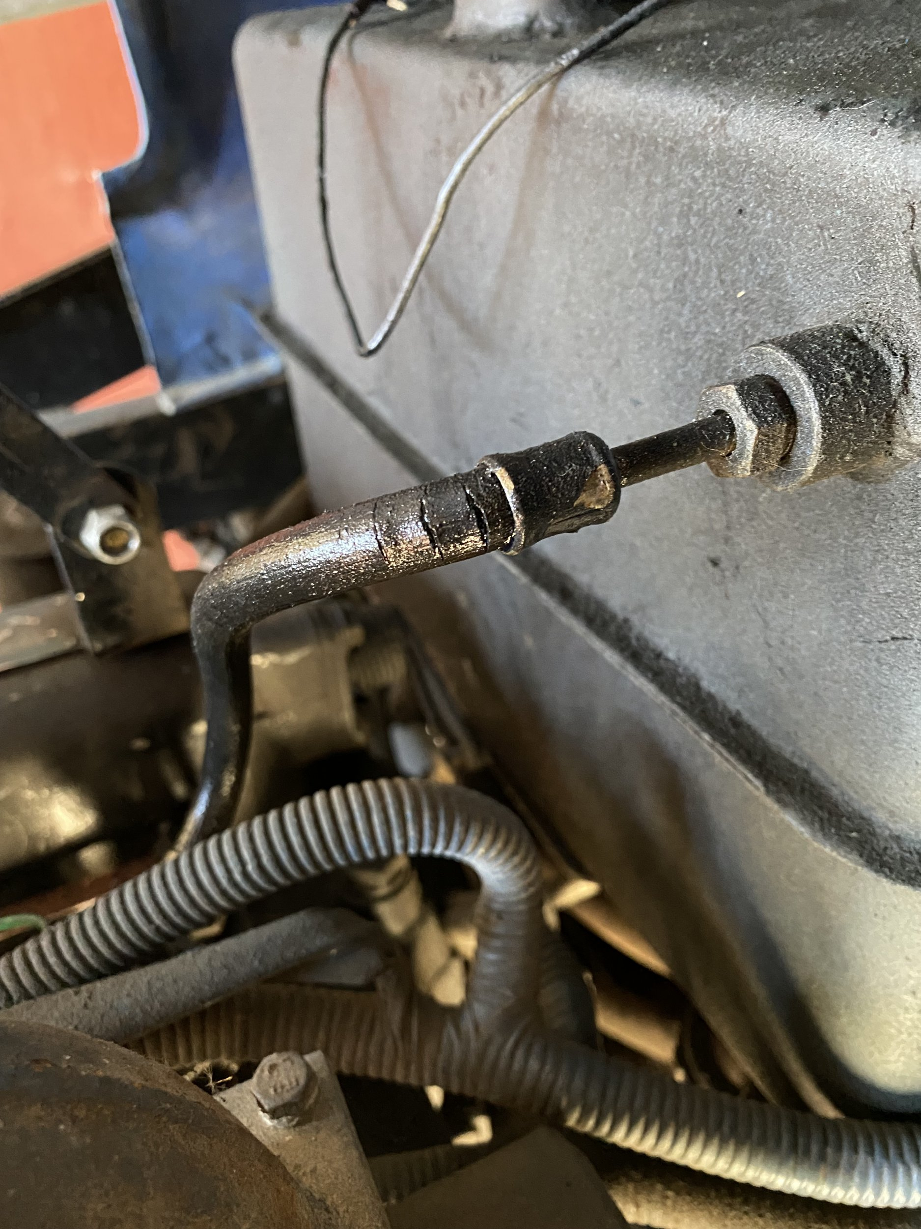

UPDATE: No real issue in the location that I anticipated - turns out that the fuel filter was just a bit loose and was dripping all over the lines below, injectors, etc...
However - I did notice the immediate line out of the tank is cracked and seeping slightly - doesn't look like too much loss, but it's something. I've attached a photo here. What's the procedure for replacing this line?
In terms of the coolant - I tightened up the hose clamp and will see if it holds - if not I'll just get a replacement hose. It doesn't appear that there's a crack in the elbow or anything, just seeing loss at the location where the hose meets the elbow.

Pull the lower end of the cracked fuel line off the clamp and insert a plug in the old hose (bolt or screw) to reduce fuel leakage. Attach the replacement hose then pull off the upper end of the old hose and quickly attach the new hose and clamp to the upper connection.

Thanks - is there a special tool I'll need to use to remove from clamp and re-clamp? Never done it before.

If it’s a squeeze clamp, ordinary pliers will work fine, otherwise the clamp will be fastened by a screw. Be sure to buy the correct size rubber fuel hose.

Thanks so much - I'll have to figure out the size somehow! Will check with a parts distributor to see if they can help out

According to your picture it's a crimped ferrule "clamp". The ferrule (metal part) will have to be sawed through to successfully remove the hose and reveal the hose barbs. You'll find that a 1/4" ID hose will work just fine. Use mini hose clamps.
